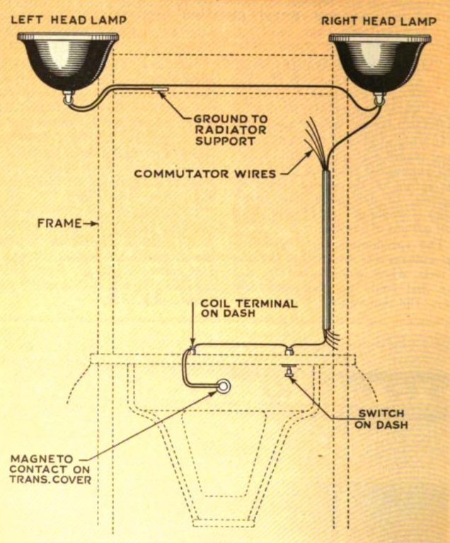

Old schematic for wiring magneto headlamps.

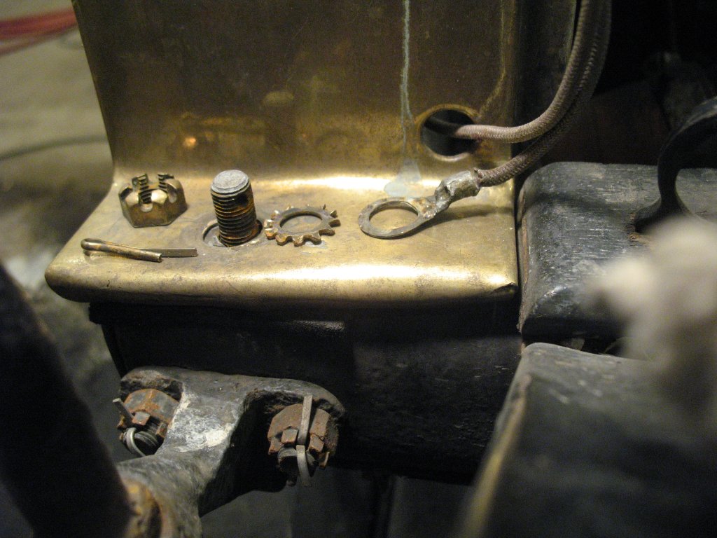

It shows the headlamp wiring on my dad's 1917 touring. The lamp wires are the same as the single wire for the magneto horn.
The wires shown are about 25 years old and from Langs. They were originally black but have faded.
Note that my father grounded the wire to the radiator stud. Originally, the wire was soldered to the radiator support.

Thank you for the solid information. I will get the wire thru Lang's (by the foot) I figure 30' will be double what I need, so I'll go with that qty. Also looks like a single wire carries the load from switch to passenger side front light, then a single wire out from that headlight thru the tube on the radiator going to the drivers side head light & finally out of drivers headlight with a single wire to ground at the radiator? Did I get it correct? Thanks for the guidance, can you tell I'm new to this? Thanks! Chris

Yes, you did.
If you're not familiar with magneto headlights, here's a page for you: https://dauntlessgeezer.com/DG117.html.
Yes, you did.
