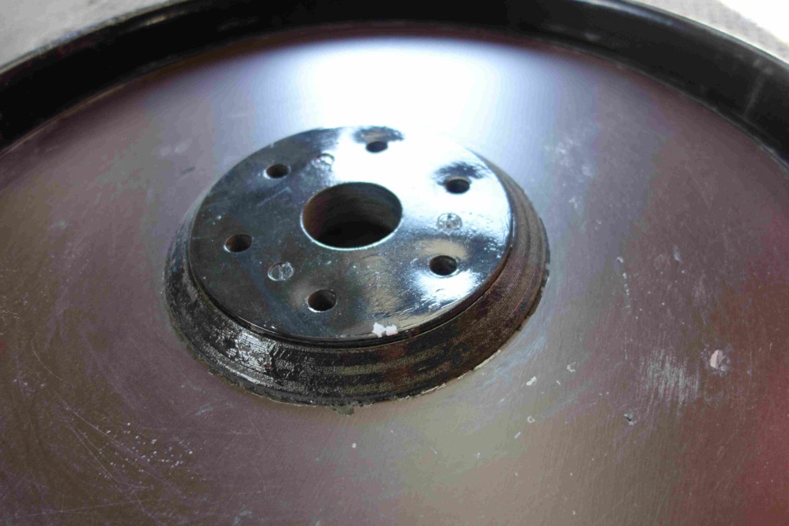

I am surprised no one has replied about your mention of wheel discs. Never heard mention of them adding strength to wooden wheels.
They seem to have been a cosmetic accessory only. Driving through dirt and sand would cause problems. They were available in the era of demountable rims and were held on by the four bolts clamping the rims. They needed a door to gain access to the tire tube valve so dirt and sand would be able to easily get inside and could cause the wheels to get out of balance.
Wood wheels are very strong if yours are good they will not be a problem, originally that kind of work was an everyday occurrence for Ford owners.

Here is a photo of a steel disc wood wheel cover which shows the valve door open as you can see it would be hard to stop dirt and sand getting between the two discs. Your thoughts on solid disc wheels is good but they may be hard to get and expensive and the wood wheels would be OK anyway.

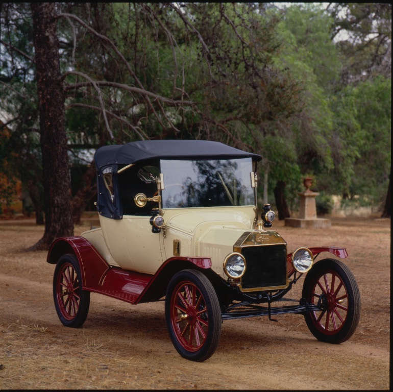

Here are a few pictures of the James Flood roadster. James Flood bodied many Model Ts. The great thing about the car is it has a very wide and comfortable seat and a decent sized boot (trunk) which is good for storage. As far as I can gather, it is the only one left. Maybe someone else can show us a sister car! It was restored in Tasmania during the 1980s with the help of Francis Ransley (who passed away recently). It was then brought to Western Australia and spent a few years as an exhibit in the York Motor Museum. A doctor from Singapore bought the car and he had it in the tropical climate for many years where it deteriorated. I brought it back to Australia and went through it. An Australian-bodied T on an Australian reenactment - can't get better than that.

Is this an earlier photo of your car?

Yes, that is the same car. Note the Singaporean number plate. You can see that it wasn't in good fettle when I brought it back to Australia in 2012. The wooden wheels were rotten, too. Here is a picture of the car when it was restored originally back in 1981 by J Saward and Francis Ransley. It was a stunner.

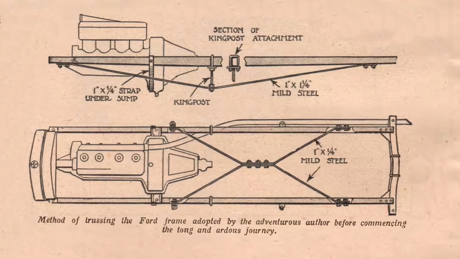

I have found a reference to Michael Terry's drive across trackless Northern Australia in a modified Model T. He and his mate were the first people to drive from Queensland to Western Australia (the Pacific to the Indian Oceans) across the top of Australia. Here is the design of the strengthening trusses he used on the chassis. (There is an obvious mistake on the drawing which you will spot!) Adding trusses like this were quite common on heavier English cars which had relatively light chassis. Has anyone ever seen a design like this on a car?

Looks like three trusses were used (four if you count the support under the transmission): one design fore and aft on each chassis rail and the 'x' across the width. Would stiffen it up measurably I think.
I only have one brace in the 'Aftermarket Items" section: app.php/gallery/image/2358 so will have to add this drawing as another.

Yes, he also had the truss across the back axle. It looks like he made his own protector underneath the sump rather than purchasing one, too.

One is to not truss the frame of the T, the frame was ment to flex and trussing it tends to increase the forming of cracks at the attaching points of the truss. an extra strap under the pan might be a good idea but only if the rear motor mounts are in a less than pristine condition. there is a great video on youtube that shows the extreme amount of flex a T can handle without breaking, have a looksee:

Chassis flexing is an interesting question. The conventional wisdom is that the chassis was designed to flex and it should be allowed to do so. The way the car was designed points to three pivoting points for the front and back axle and the engine. It was clever as it enabled everything to move.
Michael Terry was a fascinating character. In his teens he was a tester for vehicle designs including trucks at Austin in England. Later in the Great War he served in the British Armoured Car Squadron in Ukraine. He knew a thing or two about driving vehicles overland.
His explanation for strengthening the chassis of the Model T came from his experiences at war. The difference to his military experience was that the trip across northern Australia was completely unsupported. He had no mechanical workshop behind the lines like an army had. He estimated that he loaded his T up with over a ton of stuff. Here is his list: 16 gallons of oil, 12 gallons of water, guns, ammunition, spare parts, tools for car repairs, road-making tools and axes, cameras and films, spare clothes, blankets, tucker (food) and medicine, as well as, nine spare tyres and tubes, and a winch with 40 ft of wire rope. With all that on board, and two people, it is no wonder he had to strengthen the chassis!
