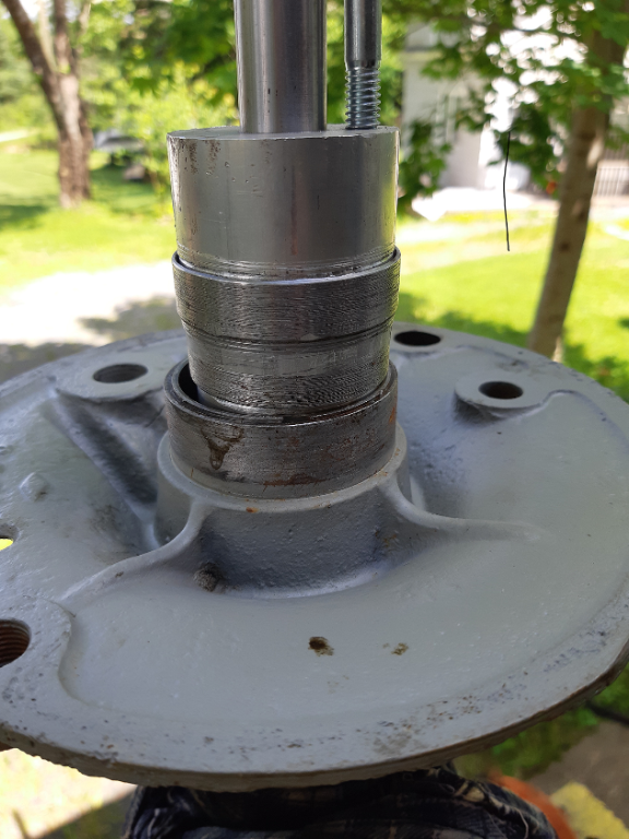

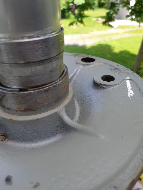

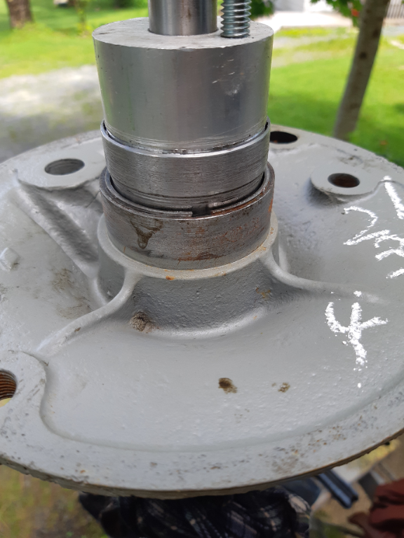

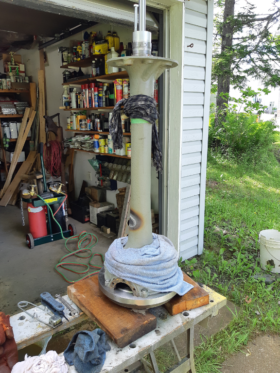

Thanks to the notes and suggestions provided earlier I got over my hesitation to heat and cool the sides of the tube to work on straightening it. For mine, I decided to try the alignment jig on a bench with the dowel pin vertical and half housing bolted down on the base. Since ¾” drill rod is not terribly stiff I also modified my outer check tapered piece with a set screw so that it could be mounted just above the end of the housing tube. That way the housing would not “push” on the alignment dowel during the heating/cooling process.
I first tried my scrap housing to do some learning on. It started out about 0.100 inch off center. I heated the tube down near where the it starts to flair out to rivet on the center section. The idea being that working there would provide a slightly longer lever out to the end and therefore might provide a bit more movement at the outer end than would heating the middle of the tube. Similar to what was shown in the YouTube video of another person’s approach, I also wrapped some wet towels around the base and the outer end to try to slow any heat getting into the castings.
I’m a bit fire paranoid, so I only used a #3 tip for heating, not a cutting torch or rosebud tip. Those might work faster, but then I wasn’t in a rush. I noticed very quickly how spooky it is to see the tube first move in the wrong direction when the heat it applied. And then after applying the wet rag on the hot spot, watching and waiting and hoping for it to move back and then hopefully end up a bit in the right direction. It didn’t move much, but it did move in the right direction. It took about 5-6 heating and cooling cycles to get it very close to straight. Yea, success this may actually work after all!
I did learn the hard way that when you get very close, STOP and don’t always try for that last bit. I did that with one housing, got it very good in a few cycles and 20-25 minutes, then one more cycle and I overshot the target. It took another hour and a lot more cycles to get back to where I was.
I am please to say that eventually I was able to get 4 of the 5 housings back very close to straight. One of them is bent by almost ½” inch off center and I may have to use a more aggressive method on that one. I included some pictures at the end.
