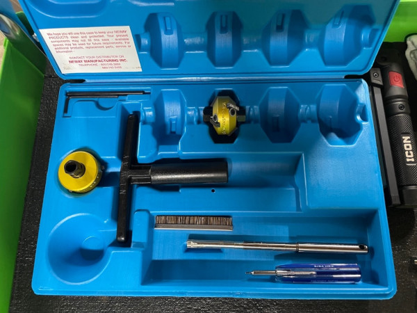

Just received my Neway Valve Seat Cutter. Waiting on a bottle of Dykem Red layout fluid. Hope to get started early next week. I called Neway on the phone to order, and they were very helpful telling me exactly what I needed for the T. I got the 30°, 45°, and 60° cutters. Several good videos on Youtube make it look pretty straight forward, and the instructions with the kit are easy to follow.

You’ll do some serious work with that puppy.
Posts: 6729
Re: Neway Valve Seat Cutter
Post by Scott_Conger » Thu Jul 27, 2023 9:30 pm
Follow the directions
install the pilot firmly, with care
use slow, light cuts, straight down - absolutely avoid any side/side pressure on the cutter especially when cutting a surface that has an interrupted/incomplete cut due to ovality of the hole. Point being, do not allow the cutter to "seek" the center of the misshapen hole - that solid pilot will deflect and your hole will not be perfectly concentric to the valve stem's hole.
to the extent that you are able, do all 3 cuts with one installation of the pilot, trying to avoid multiple removals/installations of the pilot during the remediation of a given valve
good luck and have fun - a job well done will provide a lot of satisfaction

Just to add a bit to Scott’s description of how to use Neway Valve Seat cutters, make sure you clean the valve guides throughly before installing the pilots. Use a bore brush if you have one.
