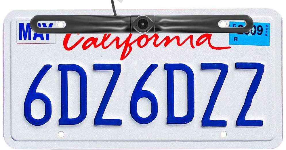

Just did a bit of investigation on the internet
Do wireless backup cameras really work?
Many wireless backup cameras use an analog signal and are prone to static or signal loss. Sometimes, interference can cause poor image quality. Some wireless backup cameras provide a digital signal, which is more reliable.
Wireless only means that the camera doesn't need to be connected to the monitor . They sill need to be connected to a power source
Reviews
https://www.forbes.com/home-improvement ... s2_section
https://www.motor1.com/products-service ... p-cameras/
This one had a good review above and the price is a no brainer https://www.amazon.com/gp/product/B07ZW ... s_li_ss_tl
Also be aware that covering up information (state, expiration date) on the license plate will get you pulled over. Not necessarily to get a ticket.

Maybe that license plate bracket one would work. Are you running T coils or a distributor on the car you want it on. With some electronics the T coils interfere. It may need to be analog, direct wire, to function using the cars electrical system.
