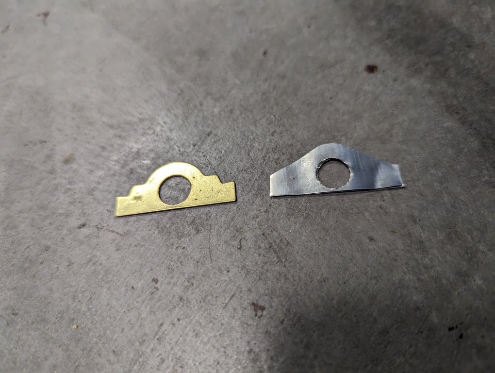

Thank you guys. I decided I'd try to find something that would work to make my own shim before I get some used ones.
I figured out this aluminum can that held my soda was almost the perfect thickness when I doubled the thickness, so I cut a model of a shim. Do you guys think this will work? Or should the shim be made of brass?

Re: Connecting rod shims
Aluminum is fine..
Soda Can... Beer Can.. Aluminum Foil.. Used all of them..
Cap
I found news paper in one once? I don't recomend it but it worked.
T Fords never left the factory with metal shims in the rods, parts supplied rods had a paper shim called a broaching shim and was .003" thick that could be removed, then the filing of the cap was the way for adjustment.
I just checked McMaster Carr. They have what you need in steel or brass. .001"-.003".
