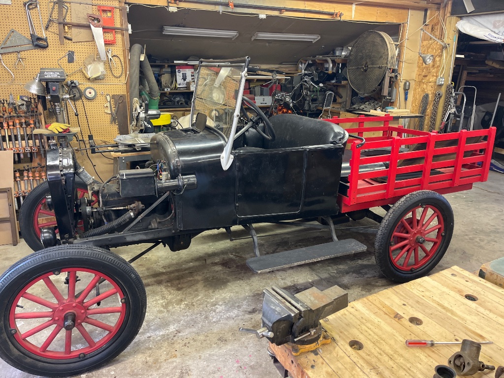

You have a combination of parts from various year cars. The body, gas tank, and coil box are 1926. The fan attachment and upper water outlet from the head are earlier model. The water pump is aftermarket accessory. The wheels are ? year The transmission is earlier with the narrow pedals. However, that's OK if you just enjoy touring. It could very easily be used for a driver and tour car. Even a speedster. But it would not win a car show for an original or restored to original condition. Have fun.

Iowa Norm, on the river. Looks like a patchwork of parts but a runner. You'll have a blast!! Oops, correction, Wisconsin! Le Claire is in Iowa.

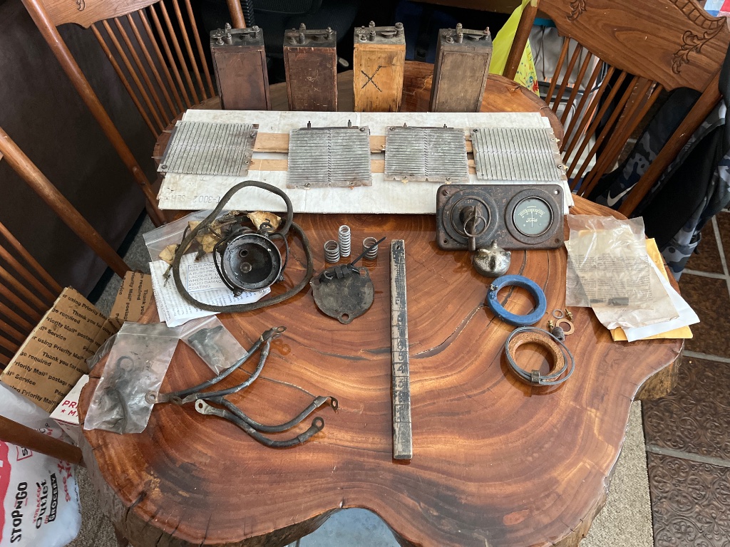

hello my name is mark. just got it home , came with xtra carbs, coils and misc partrs many questions to come i'm sure what do i have here as far as carbs go , i see coil boxes and i'm guessing resistor plates, new timer is installed i haven't heard it run but the person sail it started for a minute yesterday, looks like possible Valve springs in the mix water outlet with an impeller , water pump kit on the motor , and nos generator gear driven on thr right side of motor , as it sits in my garage it owes me $2000.00. i traded it for a Bradley GT i had i think i did ok ... it's 100 years old lol
just found this forum last night so i have lots of reading to do ,you people know your stuff so this project will be fun!! the T is only 40yrs older the me but my theory is if somebody else can fix it so can I, with youtube and the internet the information is out there some where thanks in advance for any help , input and advice .MARK

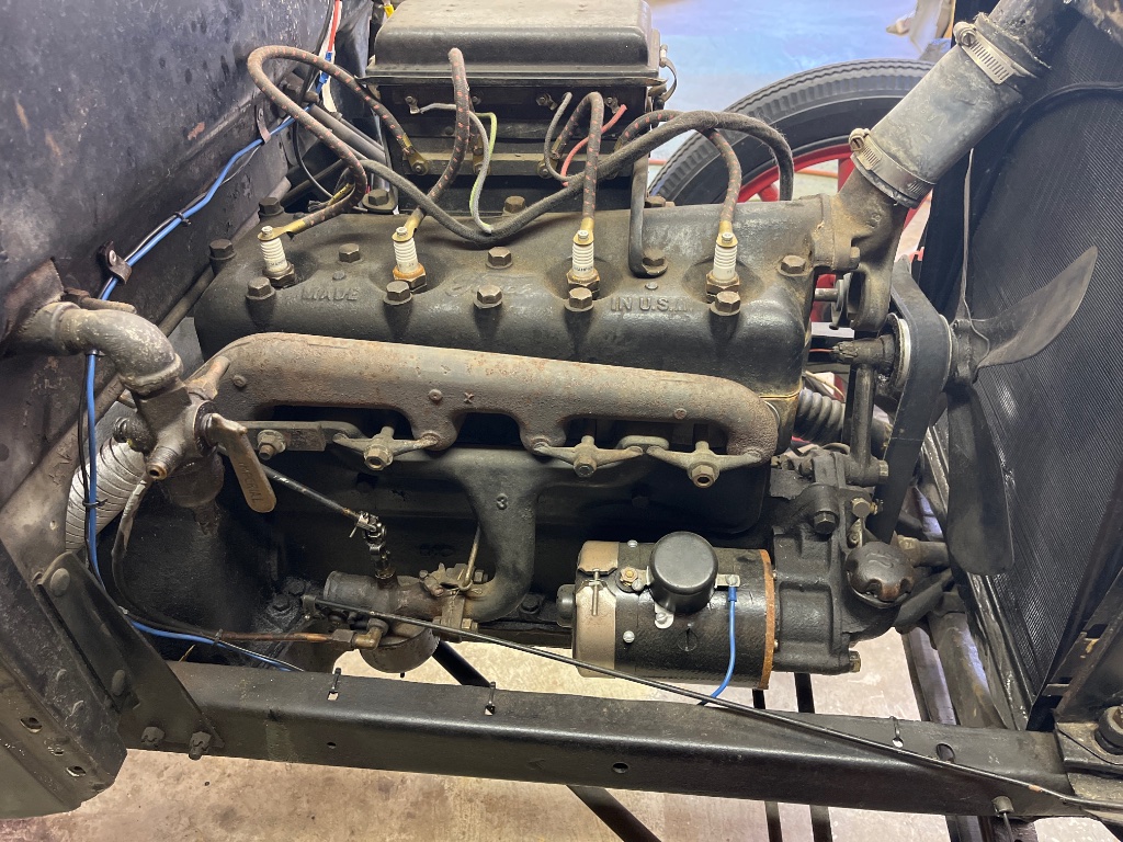

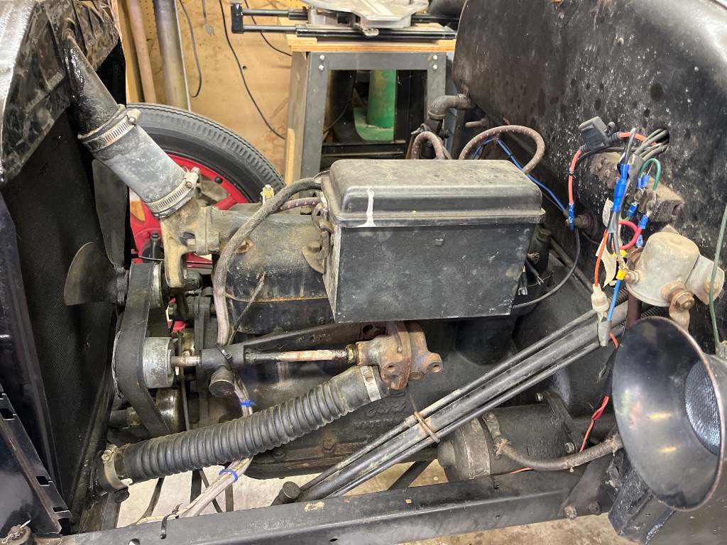

the guy told me the body was a 26 4 door cut down looks like they did a nice job so far , coil box is 26 that's ok i'm guessing. he said everything else was 23 does that make sense ?Norman Kling wrote: ↑Fri Aug 04, 2023 4:31 pmYou have a combination of parts from various year cars. The body, gas tank, and coil box are 1926. The fan attachment and upper water outlet from the head are earlier model. The water pump is aftermarket accessory. The wheels are ? year The transmission is earlier with the narrow pedals. However, that's OK if you just enjoy touring. It could very easily be used for a driver and tour car. Even a speedster. But it would not win a car show for an original or restored to original condition. Have fun.
the generator is gear driven not belt (most pictures i see are belt drivin) so do you know what motor i have , he also said the radiator was done 3yr ago it has flat tube, and the top end was done just before his dad bought it , any ideas what that means (head surface and mabey valve work since i found springs with the misc parts that are in the picture on my table) there is no head gasket in the gasket set just paper ones , oil pan and others i'm guessing , thanks for all ithe info !! i'm making notes as i learn , i'm 60 so i have to write things down

your "year" description makes perfect sense and yes, it is a cut down touring car from 26-27 period
if you were very curious, or when/if the waterpump comes off for whatever reason, the engine number appears just above the water inlet. The SN will tell you what year the block is.

It looks like a 26-27 cutoff touring, I would suggest to assume nothing unless it comes from someone you trust who does mechanical work. If you can wrench a lawnmower engine, you can fix a T. Take your time, it looks like everything is there to make it run.

All Model T's which came with generators were gear driven from the camshaft timing gear. Some T's have after market generators which are belt driven, but that is not the way Henry made them. If the block is clean and you have a good radiator you don't need a water pump. The pump will actually cause the engine to run too cold in cold weather. The Ford thermosyphon cooling system used the natural heat of the coolant to rise to the top of the radiator and as the air blows through the radiator, it cools the coolant which goes to the bottom of the radiator and back into the engine. So it doesn't actually start to circulate until it warms up. Words very well with a good radiator.

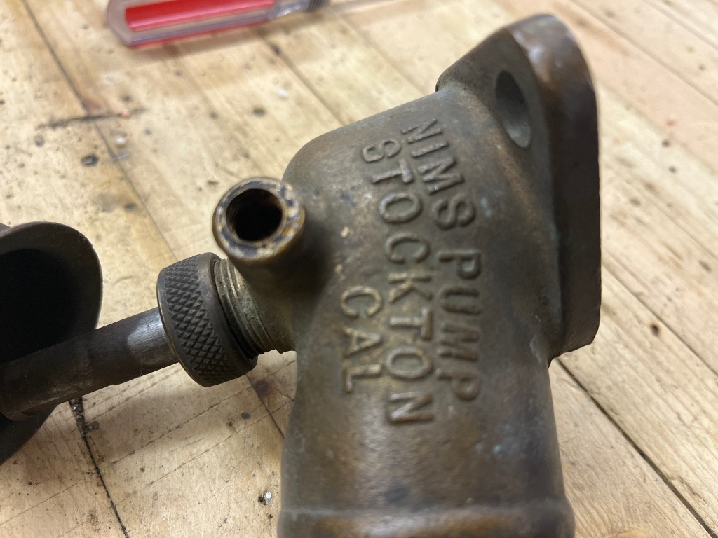

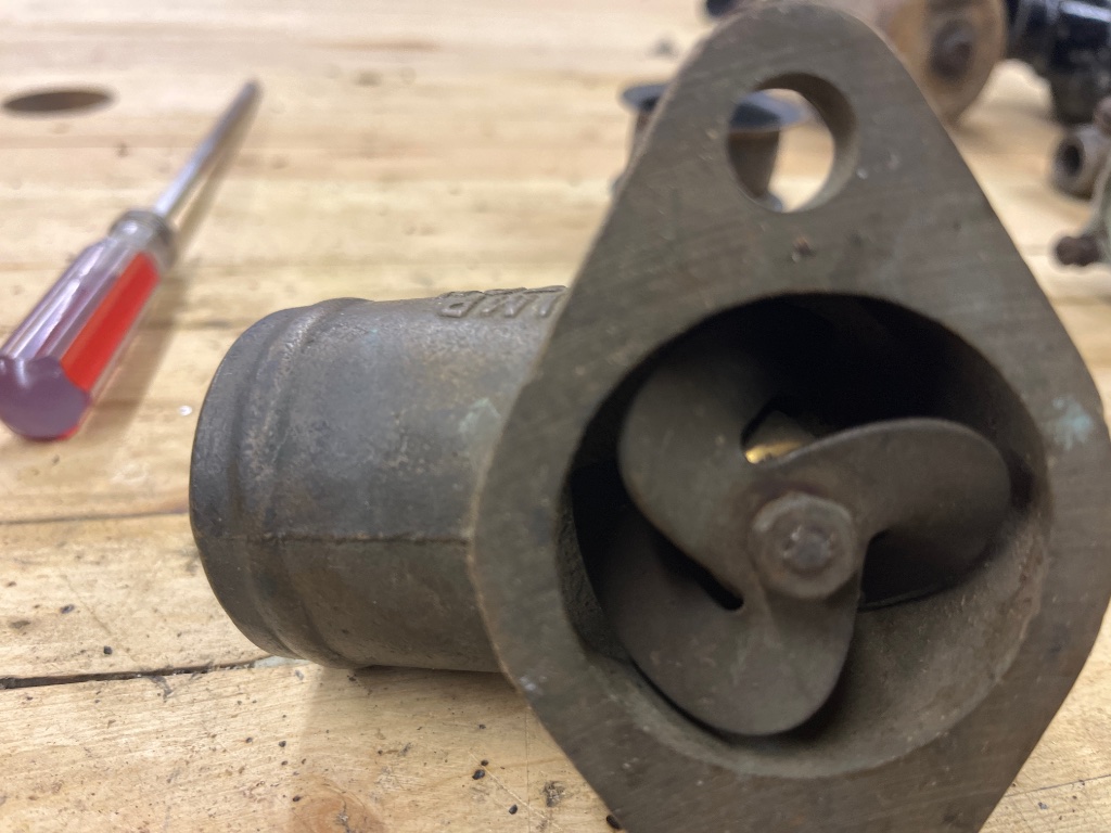

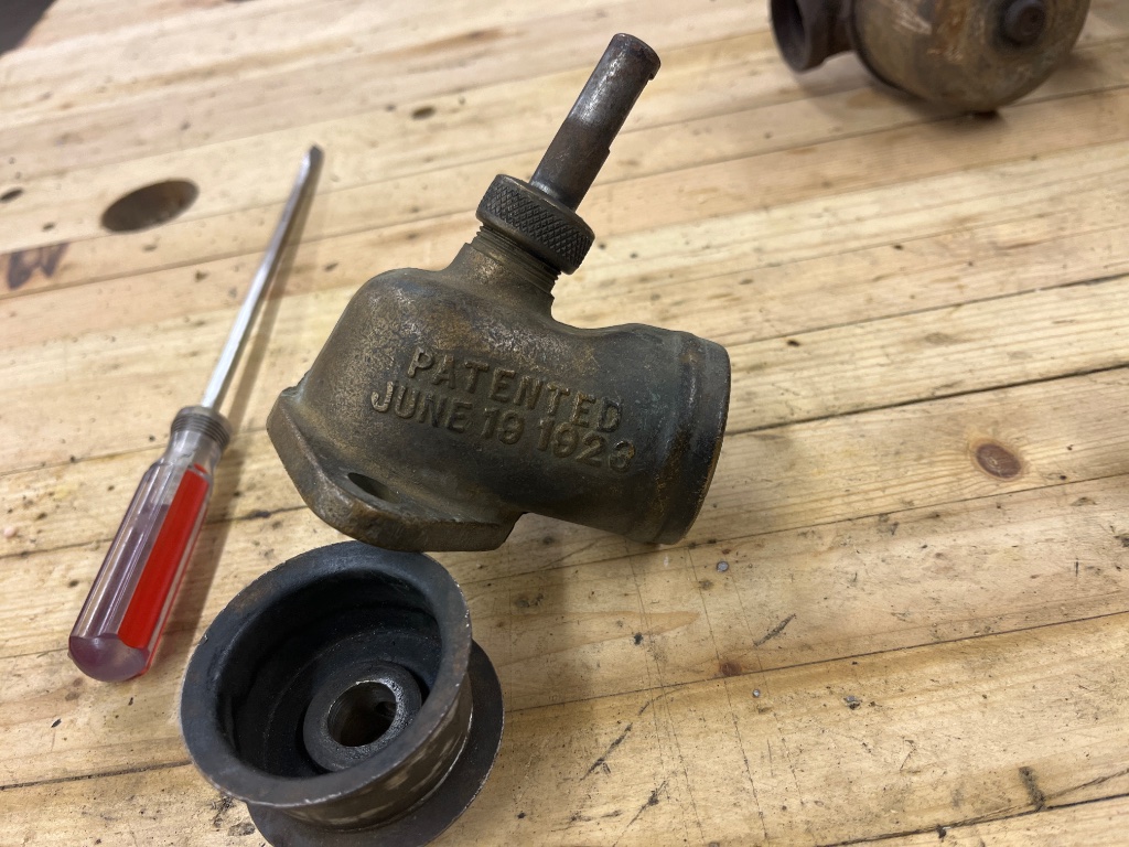

great info thanks, in the one picture there is a water outlet with a propeller with a shaft and pully dated 1923 , must be aftermarketNorman Kling wrote: ↑Fri Aug 04, 2023 9:37 pmAll Model T's which came with generators were gear driven from the camshaft timing gear. Some T's have after market generators which are belt driven, but that is not the way Henry made them. If the block is clean and you have a good radiator you don't need a water pump. The pump will actually cause the engine to run too cold in cold weather. The Ford thermosyphon cooling system used the natural heat of the coolant to rise to the top of the radiator and as the air blows through the radiator, it cools the coolant which goes to the bottom of the radiator and back into the engine. So it doesn't actually start to circulate until it warms up. Words very well with a good radiator.

I would take a close look at the wiring, particularly where it passes through the firewall. That ain't the way Ford did it. I also noticed a solenoid for the starter. Is the car 12V? Nothing wrong, but the T was originally 6V negative ground. You will not be able to count on any standard T wiring diagrams if it has been converted to anything else. Usually a water pump is a band-aid for another problem - most often a radiator that doesn't leak, but doesn't cool properly either. As the radiator ages, the connection between the vertical tubes and the horizontal fins deteriorates. Since the radiator doesn't leak, the owner thinks the radiator is good. It isn't. If the vertical tubes are round, I would start stashing away a bit of dinero to buy a new radiator or have that one recored. Neither is cheap, but if your radiator isn't up to par, you will be fighting overheating issues until it is. BTW: There's nothing wrong with the round-tube radiator, but if it is (round tube) it's probably original. A properly running Model T with a flat-tube radiator will cool just fine with the cooling system the way Ford made it. Have fun with your car, and welcome to the affliction!

John, Mark has a 3-year old flat tube radiator. He's good to go.

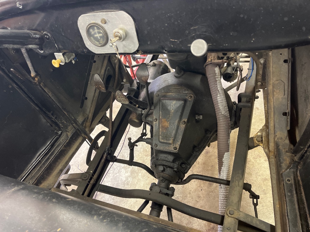

up date!! removed the added wires /wiring from prev owner , head lights and tail light since it had the orig wires in the cloth harness (checked with my DVOM) . looked everything over should work for now. it has a universal key/ starter switch on the dash which is ok for now , i have the orig style switch and guage which will go back in after i test /clean it, so next move figuring it had spark next we need gas and air . i have lot of air so i pulled the elbow and gas valve and drained probably 5 gal old gas (garage will smell for days
) took it all apart and cleaned it out (it was plugged and full of crap) next i pulled the carb and it was pretty clean (sediment bowl did it's job) cleaned it up, float looked good after getting it cleaned no gas in side , blew out the jets reinstalled the float and needle gave it the mouth blow test (upside down and right side up) needle and seat were working good. put the carb back on hooked up the throttle , mixture and choke along with the gas line and i'm ready to go , put in 5gal new gas , went in the house to get my gas guage stick and it showed 4.5gal perfect!! now the best part ... turned on the gas (the valve has kero,off , gas pretty cool) opened the drain on the bowl , yup got gas, key off, timing full retard , 1/4 throttle , jumped the solenoid with a screw driver and cranked it over 4-5 times , choke in/off (gas pored on the floor ) quick wipe up for safety double check full parking break and turned the key . coil start buzzing so i hit crank it turned over 4-5 times and started up nice !!! pulled some timing into it smoothed out backed down the throttle and it runs great!!! happy guy today!!!
more to come!! thanks for all the info and comment's from all of you this is a great site and people for newbies/newT's like me and many others!!!! next question will be about magneto , i see a what looks lik a singel wire connection on top of the bellhousing behind the head , hope it's all in there , lots more reading to do 177 pages to go lol
