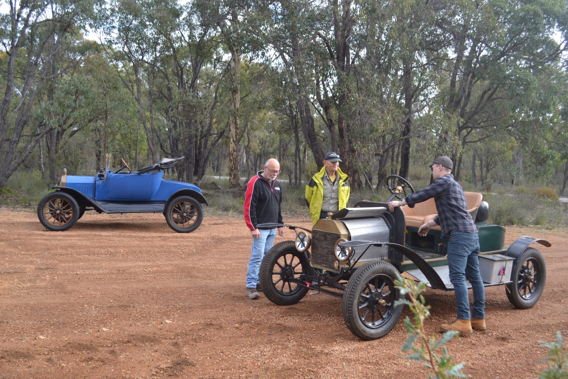

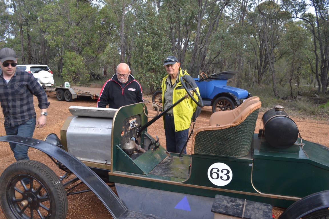

It began as a casual chat a few months ago. We live in Western Australia. We we were kids we were told a great story about a stockman who was trampled in the most isolated part of the outback in the Kimberley region of WA at a place called Halls Creek, in 1917. He was taken into town, which had a population of only a dozen or so people. There was only one doctor in a part of the country the same land area as Spain - and he was on vacation. The telegraph operator in town sent a message to a doctor in the State capital city of Perth, 1,700 miles away. With only a pen knife the telegraph operator conducted the operation under the doctor's instructions. The patient survived the operation, but he got sick in the next couple of days. The doctor took a ship to the nearest port of Derby and then he was raced up the Fitzroy River valley across the wild outback about 350 miles by Ford Model T on a rescue mission to save the stockman. When they arrived he had passed away two days before, probably from complications and a recurrence of malaria. It's a sad story, but it has a happy ending. The Reverend John Flynn, known in Australia as "Flynn of the Outback" had an inland mission dedicated to helping people in need. He used the race across the outback my Model T to justify beginning a medical service using doctors and nurses in aircraft. That medical service is today known as the Australian Royal Flying Doctor Service, one of the most important medical services which brings city medicine to people in the outback.
So, back to the casual conversation. Why don't we drive the trail of the good doctor from the cost to Hall's Creek? Why not? So we decided to drive not on the main road, but cross-country, on the cattle station tracks which the rescue mission would have driven. Have some fun and draw attention to the good works of the RFDS. So we're doing it in August 2024.
Our first step was last weekend, where we drove the two Model Ts we will use (a 1914 speedster and a 1915 James Flood (Australian bodied) roadster on a rough local track called the Powerlines Track. We wanted to see how well the cars would respond to such a terrible track. Well, they did brilliantly and we concluded that we needed to do minimal modifications. We should install truss roads on the back axle (in the original trip they went though three broken axles). Our radiators weren't up to the task of climbing a steep incline. We'll need re-cores. We will also need a small fuel tank on the dashboard to keep fuel flowing to the carb during steep ascents. A common accessory in those days were also discs of steel which were screwed to either side of the wooden spokes to strengthen the wheels. With all the lateral motion of the wooden spokes maybe new wheels with these discs or even steel disc wheels are in order. The other car has Sankey steel artillery wheels. They seem up to the task.
One car has a Bosch distributor, so we will probably take that off and return to coils as it will be easier to keep it simple. After all, our cars were made for rough roads. We will also be camping in "swags" in the bush for a week or two depending how long it takes. We will have a support vehicle so we can keep the Ts travelling light.
We thought that in the months ahead, we will put regular posts on the forum about how we prepare the cars and how we test them. Then, if we can obtain a sat phone or a starlink, then provide regular updates when we are on what we are calling the "Saving Jimmy Darcy Expedition". It should be fun.
Here are a few pictures from day one.

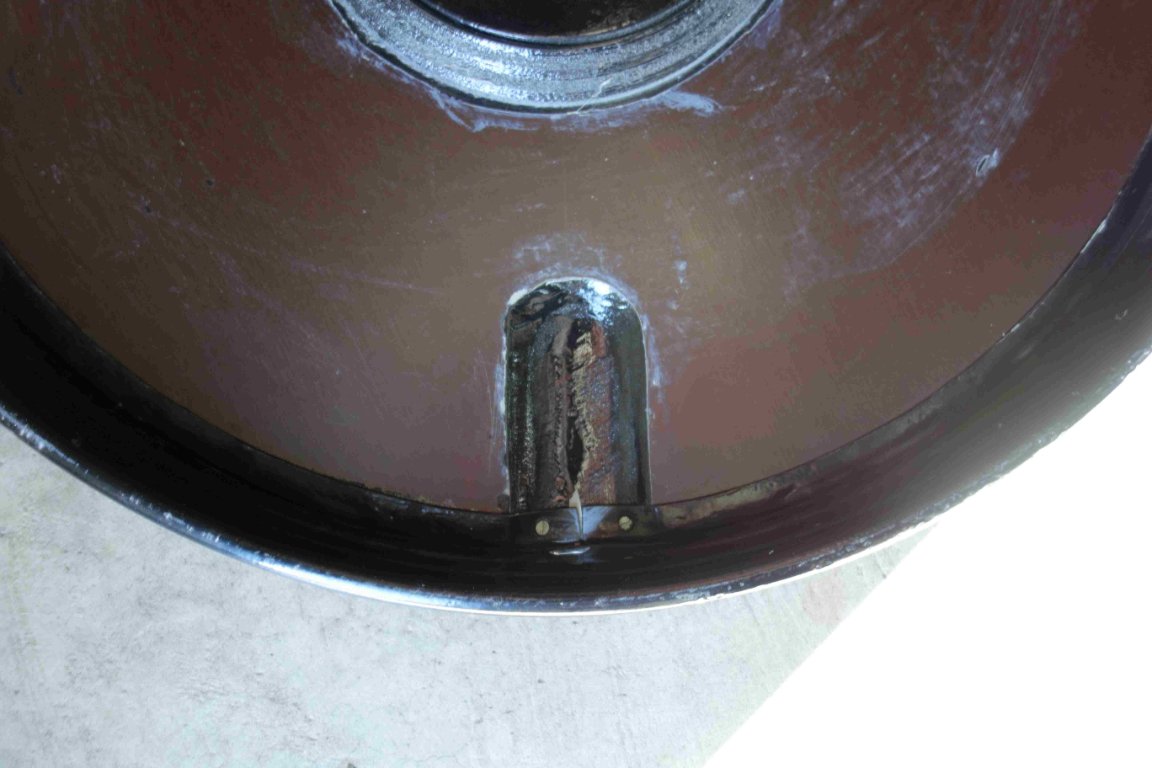

I am surprised no one has replied about your mention of wheel discs. Never heard mention of them adding strength to wooden wheels.
They seem to have been a cosmetic accessory only. Driving through dirt and sand would cause problems. They were available in the era of demountable rims and were held on by the four bolts clamping the rims. They needed a door to gain access to the tire tube valve so dirt and sand would be able to easily get inside and could cause the wheels to get out of balance.
Wood wheels are very strong if yours are good they will not be a problem, originally that kind of work was an everyday occurrence for Ford owners.
Sand dunes reminds me of a newspaper story from the 1920's from South Australia. The locals in an area with sand hills were trying to get government to help with obtaining a water supply. The Premier of the state took a journey to the area (south west of Adelaide) but his car became hopelessly bogged and damaged trying to negotiate the sand hills. He had to endure a cold wet night in the car without a roof and needed to be rescued with horses the next day.
He announced after the trip where the car (no name given) then had its front axle ripped out from more poor country terrain and that the area was not suitable for consideration as it was not possible to travel easily to the area. In next weeks newspaper a Ford Dealer wrote a letter which said." I have travelled over those sand dunes several times in the past few month in my Ford with out the slightest trouble" That probably help him sell a few more Model T's.
Here is a photo of a steel disc wood wheel cover which shows the valve door open as you can see it would be hard to stop dirt and sand getting between the two discs. Your thoughts on solid disc wheels is good but they may be hard to get and expensive and the wood wheels would be OK anyway.
Sounds like a great trip to do especially as you won't have to contend with others on their mobile (cell) phones as you would be if using normal roads .

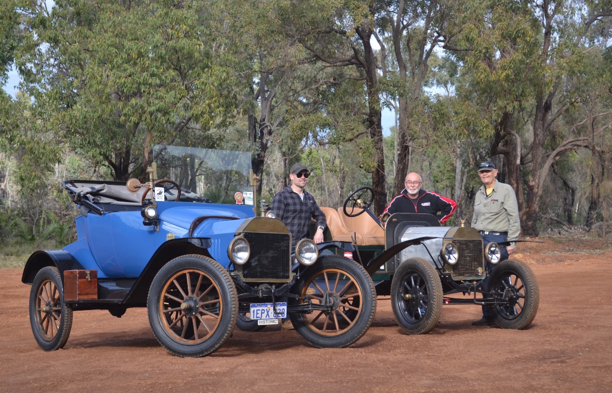

Here are a few pictures of the James Flood roadster. James Flood bodied many Model Ts. The great thing about the car is it has a very wide and comfortable seat and a decent sized boot (trunk) which is good for storage. As far as I can gather, it is the only one left. Maybe someone else can show us a sister car! It was restored in Tasmania during the 1980s with the help of Francis Ransley (who passed away recently). It was then brought to Western Australia and spent a few years as an exhibit in the York Motor Museum. A doctor from Singapore bought the car and he had it in the tropical climate for many years where it deteriorated. I brought it back to Australia and went through it. An Australian-bodied T on an Australian reenactment - can't get better than that.
Michael Terry's book is one of the inspirations for our trip. I will post the modifications he made to his car when I get some time. I think people will be interested. We are currently working out making some radiators using the large top tank "colonial radiators" we have. I think new radiators will be our single biggest cost.
Also we have a copy of Dr JJ Holland's diary of the scramble across the bush to get to Hall's Creek.

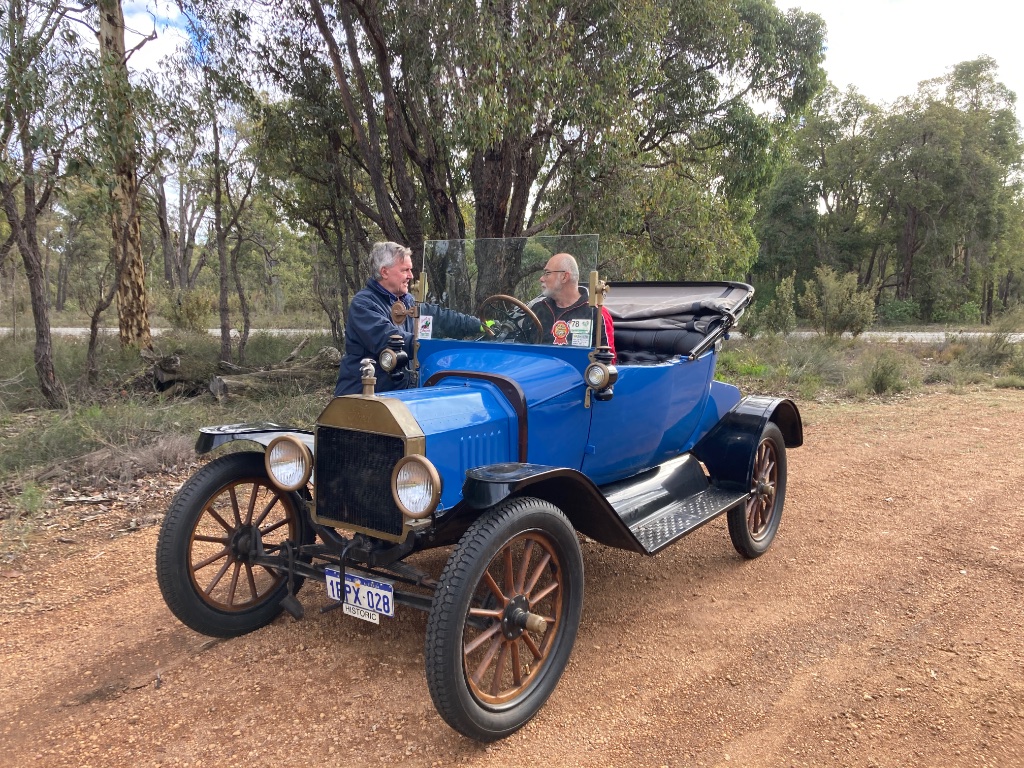

Is this an earlier photo of your car?
Topic author - Posts: 38
- Joined: Sun Sep 22, 2019 7:22 pm
- First Name: Graeme
- Last Name: Cocks
- Location: Perth, Western Australia
Re: Saving Jimmy Darcy Expedition
Yes, that is the same car. Note the Singaporean number plate. You can see that it wasn't in good fettle when I brought it back to Australia in 2012. The wooden wheels were rotten, too. Here is a picture of the car when it was restored originally back in 1981 by J Saward and Francis Ransley. It was a stunner.

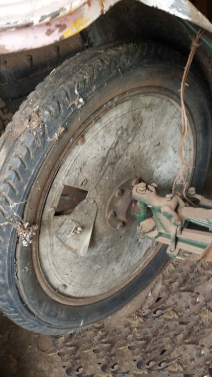

Coincidentally, yesterday I was visiting a mate and he is in the process of restoring a T which has disc wheels. These wheels don't have any identification on them so maybe someone here can enlighten us.
The wheels have a plywood disc which is screwed to the beaded edge rims at about 8 inch spacing. Around the outside of the disc is a metal trim which covers the edge and both sides of the plywood. The valve hole requires relieving for easy access to the valve stem. The hub center has a build up of more layers to make the hub area thicker. There is a metal disc both sides and the wheels can be detached as the wheel hubs have studs which go through holes in the hub and the wheels have nuts to hold them on, similar to normal steel rims we have had for so long. Here are some photo''s
