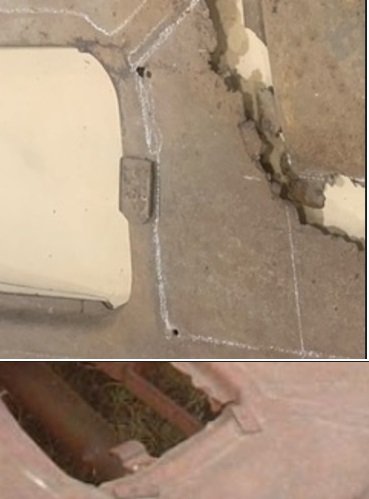

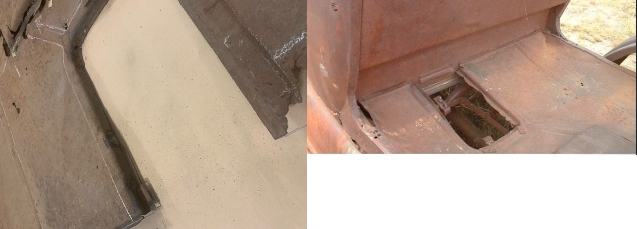

There are two main differences in the battery access opening. Some photos show full-length ledges on the left and right sides to support the battery cover. Ken’s floor has a full length ledge on the left and a short ledge at the front on the right side. All photos that I have seen also have a ledge at the rear of the opening. I assume that Ken’s floor is Canadian-made since he’s in Calgary, but I could be wrong. The other floors that I have seen are most likely US-made. I am planning to make a floor like Ken’s with a short ledge. I think that access to change a battery would be better with the short ledge on the right.
Ledges
Ledges
There are differences in the battery cover hold-down at the rear. The hold-down in Ken’s looks the same as the front floorboard hold-downs on my Runabout. But some photos show two narrower hold-downs.

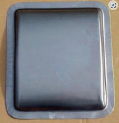

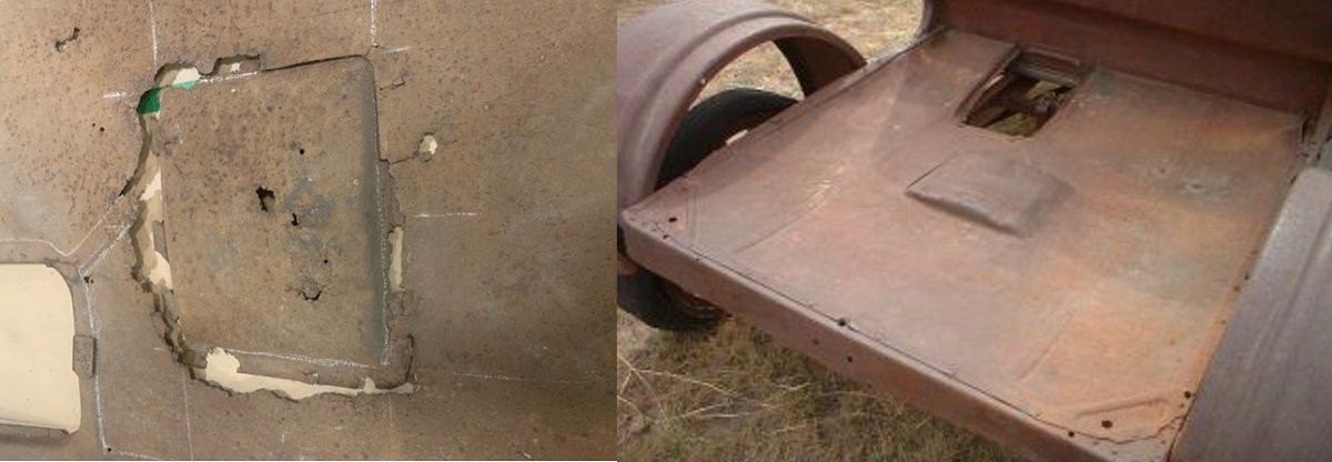

Another difference is whether the differential hump is formed as a separate part or integral to the floor stamping. Ken’s photos clearly show that the hump is a separate piece. It’s placed in a hole of the floor stamping and attached from underneath. If anyone has a measurement of the radius at the corners of the hole, I would like to know what that is. Other photos look like the hump is pressed in the overall stamping. I plan to cut a hole and install the hump that Howell’s makes. If anyone knows of other differences or has better photos, let us know.

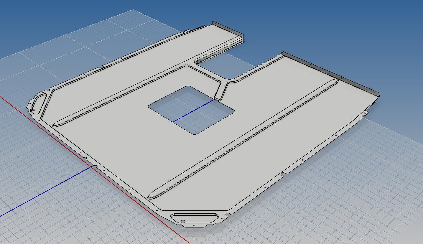

Hank used a bead roller to form much of Jennifer’s floor panel. The bead roller that I had access to was, apparently, decommissioned so I need to work on another forming method. I have thoughts on that. But for now, I’m creating a 3-D model of the floor and will eventually create a scale drawing that I can share in the forum Gallery. I have a lot of measurements to confirm before finalizing the design. I can imagine that the final rivet holes may need to be drilled in situ. Each body and platform might have slight differences. But I will include them on the drawing with a cautionary note. Here is a work-in–process of the floor.
