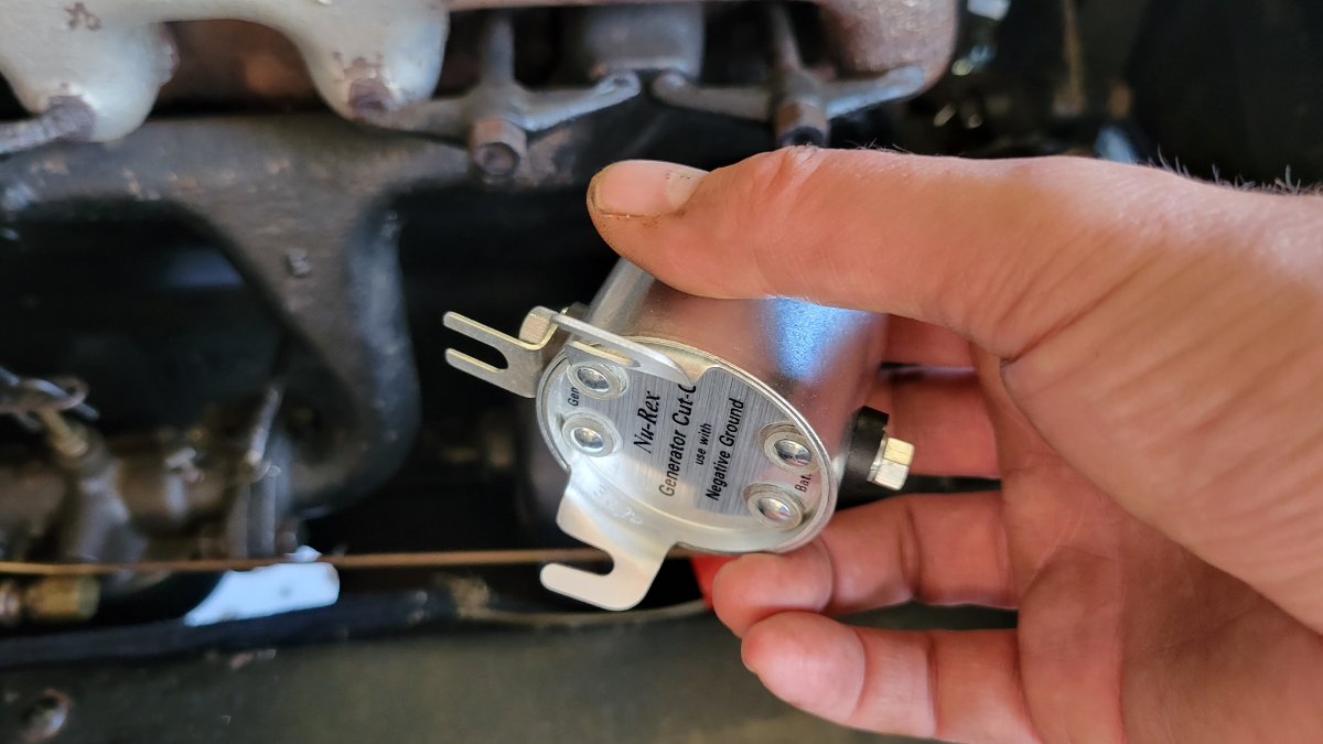

Got a new cut out. The old one is toast. I'm planning on installing it this evening with my helper. Is there any harm in hooking this up as instructed and just firing up the T to check the ammeter?

What does the instruction sheet say about amperage? Most of them like the generator output around 5 amps so the cutout doesn’t burn out and the battery doesn’t get cooked.

Joe Reid wrote:
Thu Nov 10, 2022 4:30 pm
It doesn't say anything other then it can handle 20 amps. Is the ammeter supposed to be this high?
Posts: 6642
Re: Just adopted a T - It was supposed to be a quiet project
Post by Scott_Conger » Thu Nov 10, 2022 4:44 pm
I would be inclined to (disconnect the battery) do a resistance test of the battery wire from the generator to the barrier strip and then to the starter button.
You appear to have had some sort of high resistance in that line (loose connection?) which burned up the insulation in the old cutout
The failure of your old cutout may have been a symptom but not the illness. Because the generator is an expensive item to replace if damaged (as is the garage if things go south), it is sound practice to check for continuity/isolation of all electrical circuits before putting them into service.
Just saw your picture: NO!
You have some Forum Study to perform regarding dropping your amperage on the generator
On it. Thanks.

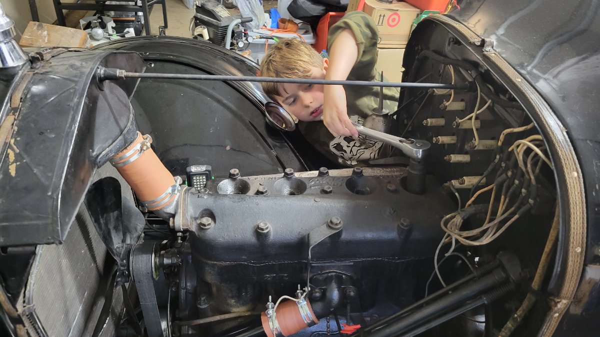

And Dan.... if/when you elect to adjust that generator 3rd brush; select a 5/16” open end. NOT a pipe wrench 😜😂

Post by Arbs » Thu Nov 10, 2022 6:26 pm
But I only own a hammer... That may be part of the problem. :D

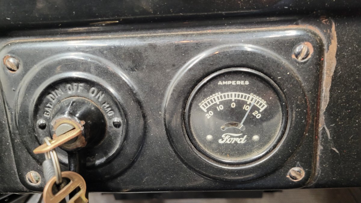

I adjusted the 3rd brush. It is very sensitive. This was as low as I got it. It seems like if I adjust it any lower it falls to zero on the amp meter.
BTW, I don't know how old the wiring is but it looks old.
No lights:
Lights on:
Thoughts?

Post by speedytinc » Fri Nov 11, 2022 5:16 pm
Did you reset the null point?
Service manual.

That doesn’t look terrible, especially with the lights on. Why was it pegged before? If you keep running it does it come down more? I would look at replacing the wiring if it is old. Do you have an electrical shutoff on your battery? I would recommend one.
The only thing I did was adjust the brush, so maybe it was just way out of adjustment? I haven't run it long since the adjustment, but will let you know.
As far as the wiring, are you suggesting replacing all of the wiring in the T or something specific?
I don't have a battery shutoff but it would certainly be convenient. Do you recommend a fuse as well? I haven't found any on this car.

Post by Arbs » Fri Nov 11, 2022 6:46 pm
Service manual.
Thanks John. I did not reset the null point. I just reviewed the manual again and I noticed it has the process start by setting the 3rd brush to maximum output, tightening the brush holder assembly (4 screws) then adjust the brush until you get to the desired amperes. This modeltforfix.com article seems to work in the other direction, setting the brush to where it is just registering amperes and locking the brush holder before adjusting to the desired amperes. I'll try one of these and see if I can dial the amps down a bit more.
Luke

Post by Luke » Fri Nov 11, 2022 6:54 pm
Dan,
Take note of what John said re the null.
FYI here's the 'official' documentation, but please note that unless you're doing a lot of night driving I'd never set the current that high, especially with old wiring and generator etc. IMV 5A is plenty, and if you're running LED's you could probably get by with something less than that. BTW unless they've been fitted there are no fuses on a T.
Luke.
EDIT: Looks as if were were typing at the same time and you're on to it. I'll leave this comment and image up there though in case it helps others later on - and the 5A suggestion remains!

Post by speedytinc » Fri Nov 11, 2022 7:01 pm
I dont have my manual with me @ work to compare the methods. I do like Ron's method. Go for it.
Unless you are driving a lot @ night or using your starter frequently, I would set the output @ 4-5 amps. This might make for a bit of discharge with the lights on, but, thats not important for the few miles driven after sunset & its easy on the charging system & the battery.
Add on. Luke posted the ford method. Its not the 3rd brush that is set for max. Its the "brush holder"(4 screws)

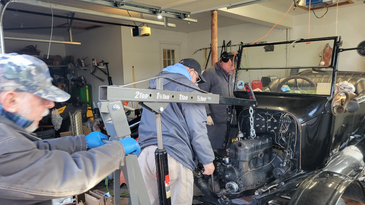

My new friend Joe from the local club stopped over today. He swapped out some coils, adjusted some bands, and got the timer to stop rubbing on the belt. The T runs alot better. Best of all, he schooled me on driving technique and showed me what to expect the T to do on hills and in other driving conditions. I feel much more confident in my driving ability and the reliability of the car. Who knew that the biggest problem was the nut between the steering wheel and the seat?
Joe has also offered to help install new bands over the winter. Thanks Joe!
We pulled one of the wobbly wheels. By tightening the spoke bolts, I think we reduced the wobble a little. It's still not great. The key was a little mangled too, so a new one is on order.
We also found a shim on the axle. I didn't know that was a thing.
Joe adjusting bands mid trip:
My son and I enjoying a much smoother ride with Joe driving:

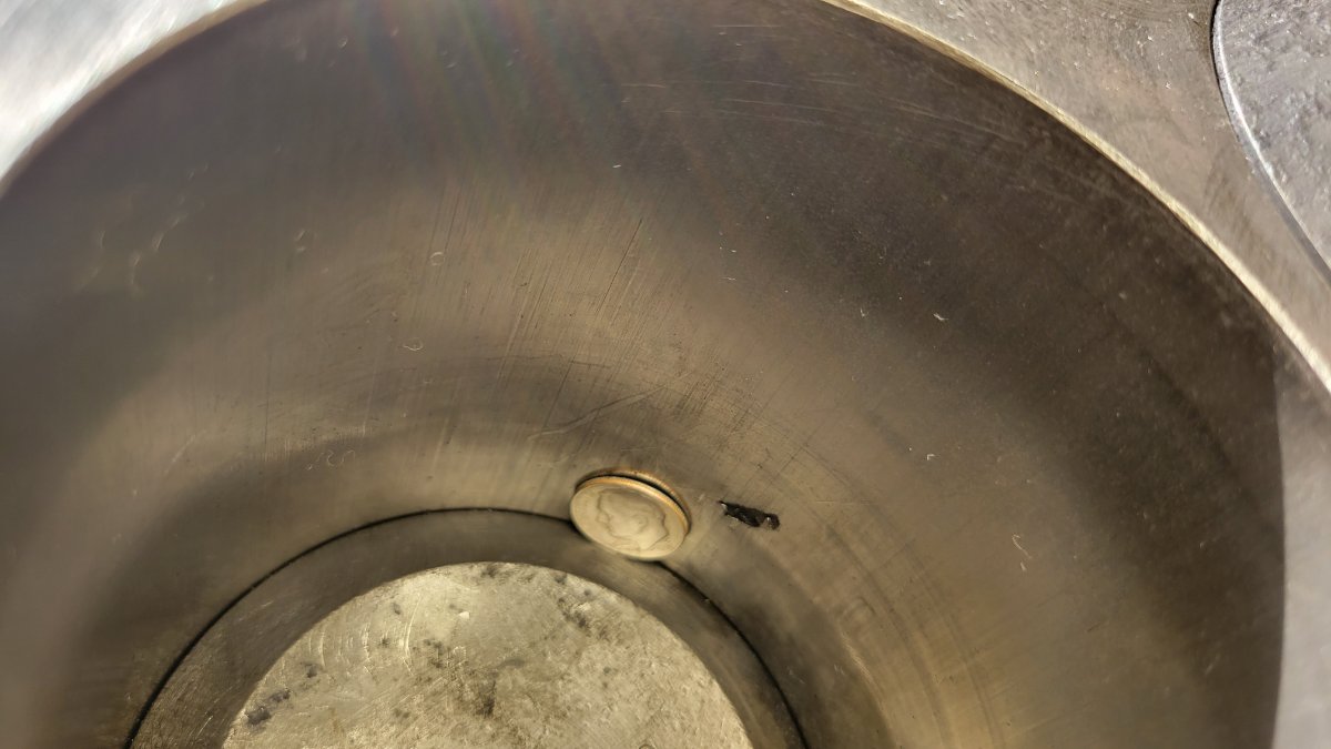

Uh Oh...

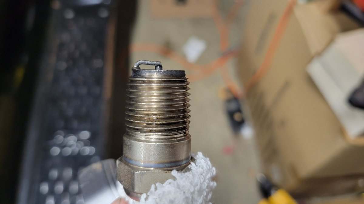

I drove my son around our neighborhood having a good time. I dropped him off at home and decided to do one more trip around the block before it got too dark. Everything was fine until it wasn't. Luckily I was about 100 yards from home when the car's power dropped. I was able to get it into the garage.
Cylinder 2 was dead... Uh Oh...
Pulled the spark plug and saw this:
Well, that's different. I just checked the gap on this last week. I googled reasons the gap could disappear and the results were not encouraging. I broke out the scope and saw this:
Uh Oh...
Time to pull the head... I was planning on doing it once it was too cold to drive anyway. Of course I got some help.
Funny, the other problems with this car aren't as concerning anymore...
My son had fun anyway pulling the head, and he didn't seem discouraged one bit that we have some work ahead of us before we get back on the road.
Posts: 6642
Post by Scott_Conger » Tue Nov 15, 2022 5:48 pm
The old 3 piece 2-piece valve routine. At least you didn't lose a piston and didn't beat things up.
Neway cutters are your friend. Email me for pix of a reamer guide if you get into reaming the guides (which is a near certainty)
Funfunfun!
Posts: 8153
Post by TXGOAT2 » Tue Nov 15, 2022 5:49 pm
The valve itself is no loss. I don't see any damage to the cylinder, and the block looks like corrosion is less than average. I'd replace all the valves, springs, and keepers and make sure the new ones are seated properly and adjusted properly. Check valve guides for excessive wear. Oversize stems are available if needed.

Got the culprit out...
No damage to the seat... yay!
Posts: 4306
Post by Jerry VanOoteghem » Thu Nov 17, 2022 9:08 pm
There is damage to the seat. Maybe not from the valve breaking, but it's pitted and appears rusty. At the very least, it needs to be reamed.

Jerry,
It is difficult to be certain with that photograph, but I wondered if it was possibly just a bit of crud that needs properly cleaning off with a rotary brush, followed by a light lapping in of the new valve?
Luke.
That's my plan. My first look with the bore scope had me worried that a large chunk was missing from the seat. I'm just glad that isn't the case. Just one of those photographic anomalies.
Posts: 8153
Post by TXGOAT2 » Fri Nov 18, 2022 10:40 am
I'd want to use a seat cutter (gently) with a good pilot on all the seats. They can look good and still be out of round, off-contour, or out of alignment with the valve guide. Lapping valves can cause issues, especially with new valves. I'd keep it to a minimum, if it can't be avoided altogether.

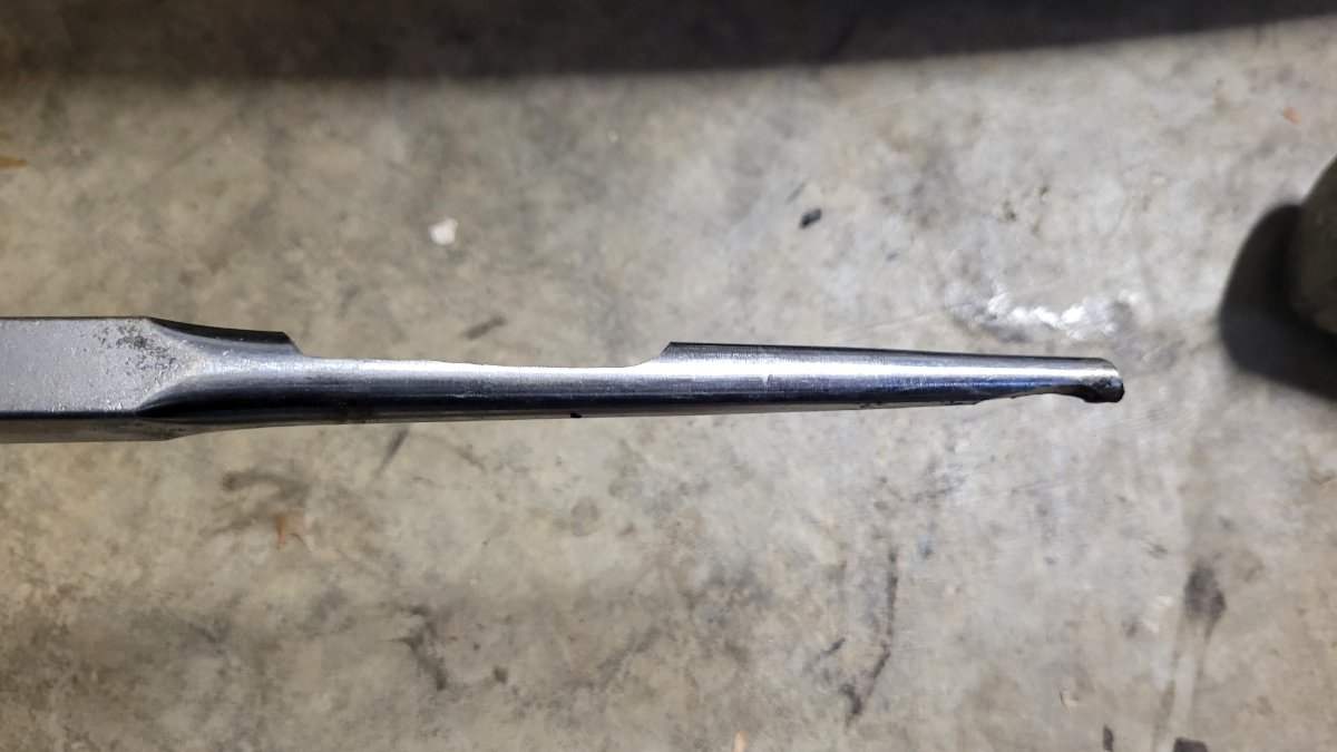

mbowen wrote:
Tue Oct 25, 2022 6:05 pm
When you check the oil in the rear end the first time, have a catch pan under it before you remove the plug. Engine oil can leak and run down the driveshaft tube and overfill the rear end. Also, if you have access to one of the (relatively) inexpensive borescopes that display on a smart phone or tablet computer, you can get a pretty good look at the thrust washer on the right side to tell whether it’s babbitt or bronze. This one in my ‘24 touring is bronze:
I'm working down the list. :D I hand pumped the oil out of the rear so I could try to find the thrust washer. Is this the shot to show the thrust washer? It seems like it is bronze to me but I've never seen babbit in person. Thoughts?

Looks like bronze to me as well. The "babbitt" version will be a silver/grey color. Looks as if it had some fresh lube as well. Most are filled with a dark molasses like goo that wouldn't allow such a good view of the bearing. You may have finally lucked out on something!

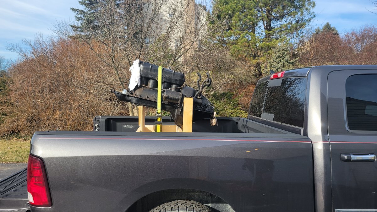

Post by Arbs » Fri Dec 09, 2022 8:14 pm

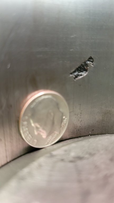

Things were worse than I initially thought...
Upon closer inspection I found damage in the cylinder.
Once I saw that, I knew I couldn't fix this in my little garage. Since then I've been looking for, and found, a shop to give me a hand. This is thanks to the club based in Valley Forge, PA. So now it's time to pull the engine, with some help.

Others will disagree with me, and possibly rightly so, but I'd ignore that damage. It's so far down in the stroke I believe it would have little to no effect on compression and if the edges of that pit were not sharp, I don't believe it would damage the rings either. It might introduce a bit of oil into the cylinder however.

From the zoomed-in photo it looks like a casting void. If so, it’s always been there.

It really doesn’t look like damage to me. How deep is it? What size are the pistons in the engine now? 010, 020? Have you taken the pan cover off and looked for debris? Did you find pieces of the valve? I think if it was damage the wall would be gouged and the piston damaged.

Cylinders still show a little of the cross pattern from reboring. Are your valve stems still standard?

Others will disagree with me, and possibly rightly so, but I'd ignore that damage. It's so far down in the stroke I believe it would have little to no effect on crompression and if the edges of that pit were not sharp, I don't believe it would damage the rings either. It might introduce a bit of oil into the cylinder however.
If it leaks water worry. I see no evidence of that.
This one thing would not make me pull the motor apart.
I would address it @ the time of a complete overhaul.

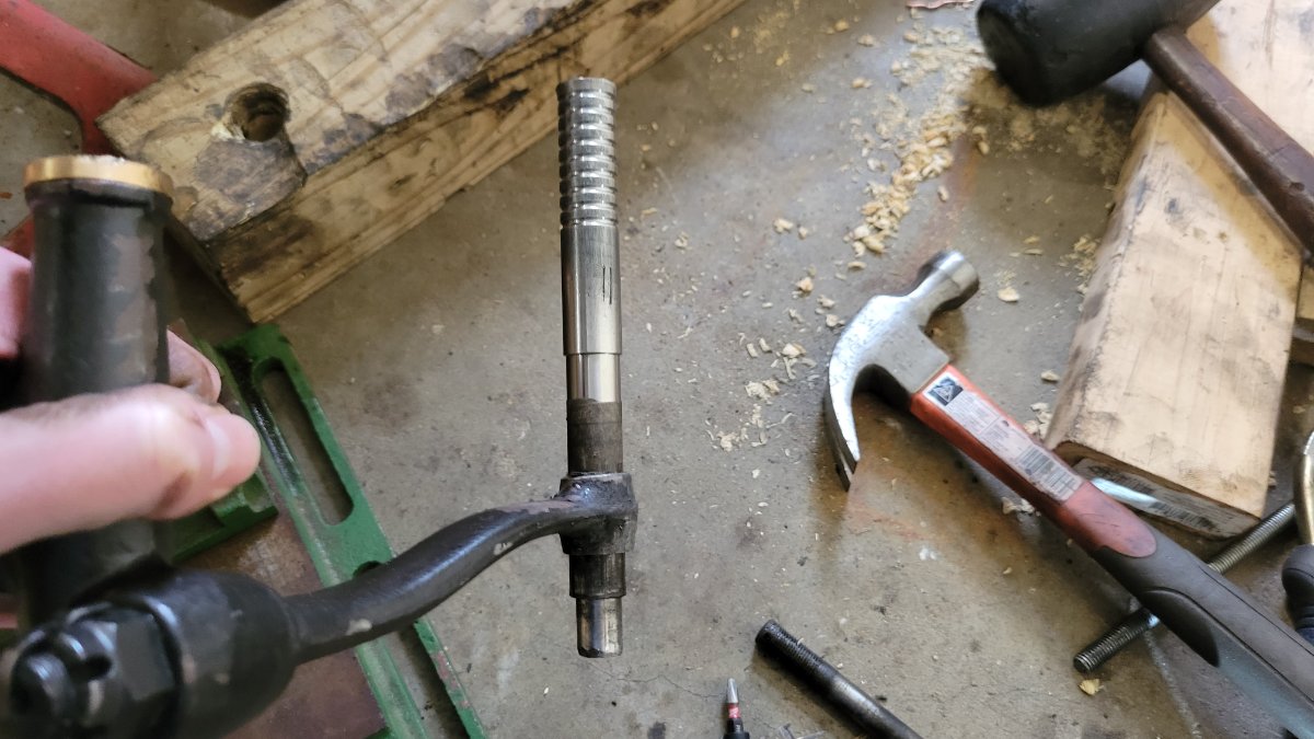

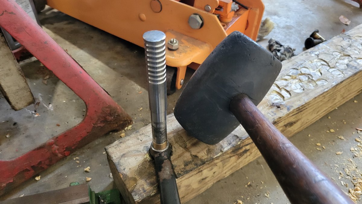

I replaced the spindle bushings today, for more details see this thread.

Since the wheels were off, I replaced the spindle arm bushings. It was a quick change using the spindle arm bushing remover/installer tool from Langs. (link) I ordered the exact tool linked but the one that came in the mail was slightly different than the Langs photo. It has 3 size steps on the tool rather than 2 as in the Langs photo and worked great.

To recap, I blew a valve in November and I used the opportunity to pull the engine and send it to an engine rebuilder. Friends from the local Model T club descended on my house to help pull the engine and eventually reinstall it.
*When I say local, some folks drove 1.5 hours or more to help. I can't thank them enough.
The rebuilder was about 2 hours away, in northern Maryland. I got his name through the local Model T club as this wasn't the first engine he rebuilt for them. If anyone want's further information on an excellent rebuilder in the PA,NJ,DE,MD area, let me know.
He provided play by play photos and stayed in contact the entire time.
Getting ready for the club guys to show up
Painted the engine a very unique color
Dave and John installing the exhaust manifold

Like always, my son wanted to be involved in the rebuild. Here he is with my friend Joe. As the youngest member of the team, he tends to get the jobs in the hard to reach places. Here he is under the car helping my friend Joe.

Magneto testing...
There is still a touch of hesitation/misfire I'm trying to track down so I figured I'd test the magneto. I followed the forum's instructions by using an 1156 bulb and measuring the voltage across it. The results look good to me based on what I've read here.
(The ground wire isn't laying on the exhaust, it just looks that way in the photo)
At idle I got 6v
I hit 12 volts easily with just a little throttle. The lever was less than 1/4 way down.
Sorry for the bad lighting
I could tell the blub wasn't going to last if I opened her up so I stopped before it broke. Should I have kept going? Is it important to get far enough that the bulb breaks? I think the test I did showed the mag is more than adequately powering the coils. Thoughts?

Post by Arbs » Tue Sep 12, 2023 5:43 pm
I was tightening the original spark plug nuts on my autolites just about every ride until a friend recommended the brass ones from the vendors. I thought they were just for show but now they are nice and tight after quite a few trips. This can only help performance.

Post by mbowen » Wed Sep 13, 2023 9:57 am
My aluminum spark plug nuts work fine as long as I give the terminal a little push in the tightening direction while tightening the nut. You can feel it tighten up.
