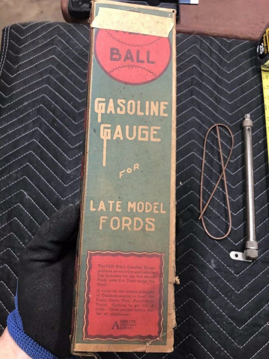

Where does this mount? On the front seat kick panel?
Thanks in advance.

It mounts along the passenger front door pillar for the 26-27 fire wall mounted fuel tank.

I’ve never seen one but judging by the ad “ for late model Fords with the gas tank under the hood” leads me to believe it connects to the ‘New and Improved’ sediment bulb. If so, I’d think this accessory would be fairly unnecessary because it’s easy to lift the gas filler lid, unscrew the gas cap and get the wood gauge out to check gas level. Now the earlier Model T s with gas tanks under the seat requires your lady to get out and you wrestle the seat springs to check the gas. That gas sight gauge accessory of the era that’s still being reproduced today makes a lot more sense.

I had one on my 27 Roadster. It was attached on the passenger side pillar where the kick panel attaches. And yes you can see it from the seat.

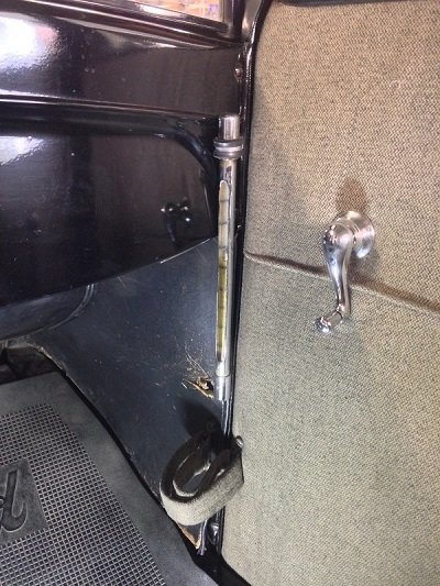

Similar to this one in my 27 Tudor.
gas guage.JPG (87.36 KiB) Viewed 5516 times

Post by George House » Wed May 22, 2019 3:21 pm
OK, I’m a visual kinda guy and now I see where that accessory gas gauge is planted. But how is it integrated into that ‘upside down question mark’ New and Improved gas line ? I wrongly assumed it fastened to the sediment bulb.
