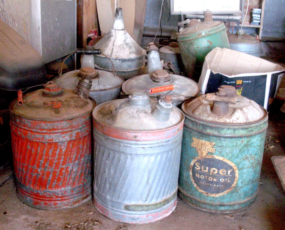

Just for appearance, a repo like this is great. If you do much driving, especially on trips, you want a functioning can or cans. But as most of us have found, original cans are scarce and expensive. I was extremely lucky to find three original Boyco cans at auction for $2 to $3 each. They are a little oversized for a Model T, but making a carrier to keep them on the running board was pretty easy. But I don't expect to ever find a deal like that again, and you're not likely to either. So what is a good alternative?
I see these five gallon cans turn up at estate sales and farm auctions quite often. They frequently sell for $5 or less. The ones with plastic handles and post-1930 brands are not appropriate but I think the generic ones with wooden handles would fit the bill nicely. I often see kerosene cans (similar but two or three gallons) also at auctions.
