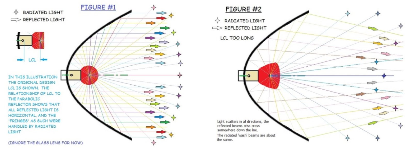

These seem to work well. The Ford headlight reflector isn't needed to focus the beam, it is all internal to the bulb. https://www.logolites.com/products/led- ... eadlights/

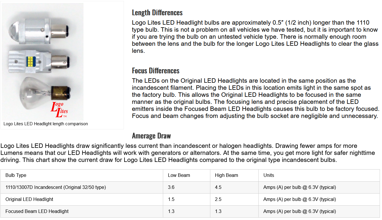

Logo Lights look like a good alternative to both filament & other styles of LED light bulb.

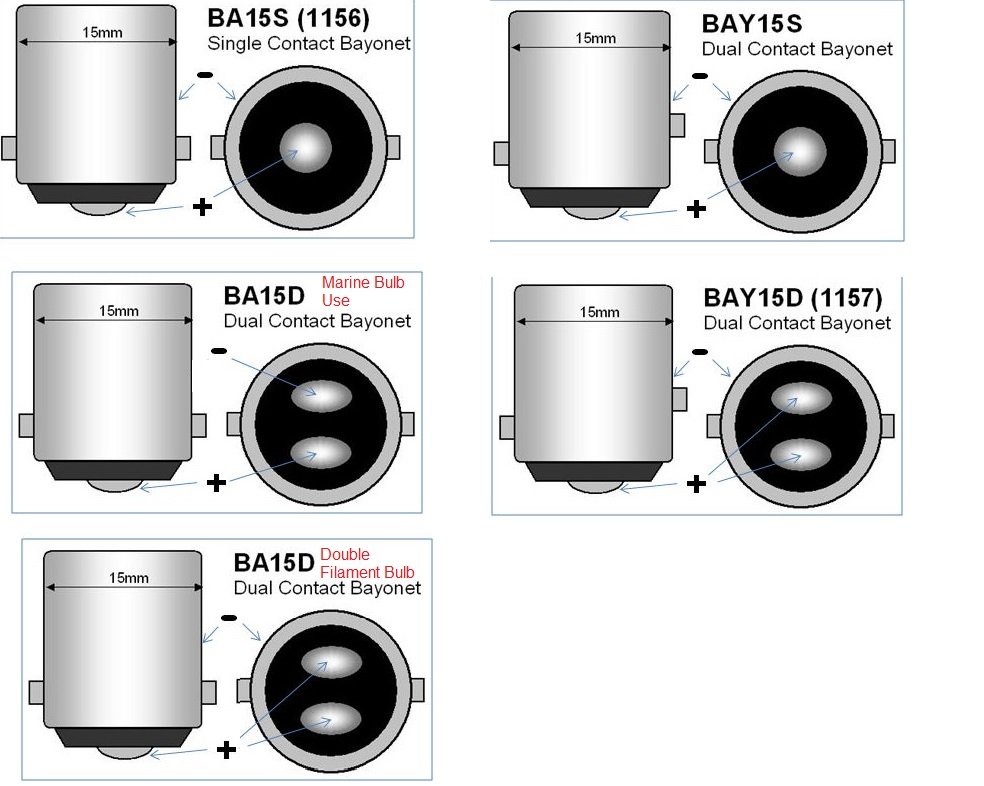

The Model T headlight socket is either BA15S (single beam) or BA15D (hi/Low Beam). The issue with using non standard bulbs is the that source of the light needs to be basically a pin point to be adjusted into the focal point of the reflector. Its important to understand that the reflected light is then projected onto the fluted lens that projects a light beam out onto the road (or wherever). The PROs & CONs of switching to LED bulbs are less amperage draw and apparent brighter light. However their designs don't emit their light into the focal point of the reflector. Actually this is not much different than an original bulb not being adjusted properly. This diagram illustrates the result. So if you would look at the headlight directly an unfocused bulb would make the headlight lens look brighter than properly focused one. Its also important to know that the color of the light (warm 3500, daylight 6000) will make things look brighter (actually whiter) when in fact the same amount of light, measured in lumens, is reflect onto the surface.
The specifications for the Logo Lights indicate that both the Low & High beam light sources are relatively at the some point allowing for the lens to focus the light properly. As I indicated early the fluted lens is design to focus the light, so I'm uncertain if this will interfere with the Logo Light beam.
While the objective is to illuminate the road at night (note I didn't say brighter headlights) the decision to change light source, falls back on amperage draw. In looking at the specifications for the Logo Lights, the amperage draw is outstanding for Low & High beam. Since it a focused beam, the condition of ones reflectors is of less concern. In fact a bit hazy one may disguise the presence of the led.
I would prefer these at 4000K over the Logo Lights 6500K for a more period look ($35 vs $49) shipping for 1 bulb

The video of the logolites seem to have the right focus, so should work. My intrest is regarding conventional headlight bulbs, and what bulbs were the factory bulbs. I could not find anything in the Ford Service Bulletins and Ford Service Manual regarding the specific bulbs. I did find something in a 1928 Western Auto Supply catalog, they list headlight bulbs for Ford cars with starters as 21-2 cp or 32-6 cp bulbs. Cars without starters are magneto bulbs so that is a different story. The generic part number for the 32-6 cp bulbs is 1172. These show up on Ebay under Eveready, Edison, Mazda, Tung-Sol, etc. The bulbs have "TOP" marked on the barrel for correct orientation. I have not found the generic number for 21-2 cp. I did find some 21-2 6-8 V bulbs that are of new manufacturer that are probably for tail lights, they do have "TOP" marked on the barrel but they do not have the typical headlight bulb shape so they may or may not focus, will have to try it and see.

Are the headlight bulbs from LED Light in Arizona a focused bulb or do they rely on polished reflectors?
- Posts: 6579
Re: Headlight Double Fillement Bulb
I didn't see any in their on-line catalogue indicating a Focused Beam. A lens is needed for that. They did have one bulb, wouldn't fit a Model T, that had a lens but the description said "here is only one filament. Built with 24 quantity side firing high quality 3030 chips. 6 3030 led chips for forward firing plus a lens. " A forward firing chips and a lens. So no idea of the light beam is a spot light, flood light etc.Dennis_Brown wrote: ↑Fri Sep 01, 2023 9:02 pmAre the headlight bulbs from LED Light in Arizona a focused bulb or do they rely on polished reflectors?

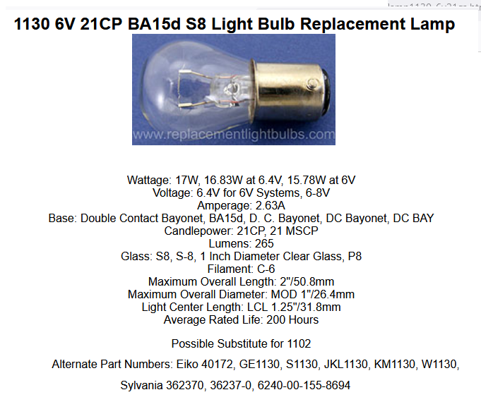

The following was an entry error on my part that Luke pointed out (Calculation Watts to Amps Watts / volts = Amps , 21/6 = 3.5 amps per filament)
I meant to use the watts for the example 21 CP bulb specification attached
Calculation Watts to Amps Watts / volts = Amps , 16.83/6.4 = 2.63 amps per filament
Also if you look at the specification the watt value changes with the voltage drops
There is an approximation of CP to Watts for filament bulbs that is dependent on a performance factor P (assume 100) & standardized variable 12.57
CP = W * P/12.57 or CP*12.57/100 21*12.57/100 = 2.64 https://calculator.academy/watts-to-can ... alculator/

Candlepower (CP) isn't the same as Watts, Ohms law isn't applicable to calculate current draw directly from CP. It may be that Larry's bulbs draw 3.5A, but not necessarily.

Oops, did I do that? Yes I know CP isn't Watts my mistake I thought I corrected that and added some specs I found for a 21 CP bulb
Might have forgot to hit submit on the initial correction
I am correcting my original entry & include the specification
Thanks for the noticing!

I don't know much about electricity, but can follow a wiring diagram. I also know the bulbs they used to make are not the same as what's available now.
The 21 cp bulb pictured above is not the same appearance as the originals. It also doesn't mention what the lower cp is.
I don't think they even use the cp designation any more?

Puzzle solved apparently I need a ba15d automotive bulb and the seller listed as an ba15d auto/rv stop turn bulb and silly me since they never mentioned filiment or marine I assumed it was a stop/tail dual filiment ba15d base bulb. Now that I know since and I don't have time I'll simply rewire it for marine (single filiment dual base) and order something right. Then transfer the bulbs to the speedster as the ground has beed problematic in the past and it's just on/off light switch.

I see references to 24-2 and 32-6 incandescent bulbs. Those must be pretty dim on the low setting. I have always run 50-32 incandescent bulbs. The high amp draw is not really a concern since I rarely drive more than 30 miles after dark.

Thought I'd add the difference between the connections & pins for automotive & marine. The marine bulbs could be used for those T's where the headlight bulbs are wired in series.babychadwick wrote: ↑Thu Sep 07, 2023 9:03 amPuzzle solved apparently I need a ba15d automotive bulb and the seller listed as an ba15d auto/rv stop turn bulb and silly me since they never mentioned filiment or marine I assumed it was a stop/tail dual filiment ba15d base bulb. Now that I know since and I don't have time I'll simply rewire it for marine (single filiment dual base) and order something right. Then transfer the bulbs to the speedster as the ground has beed problematic in the past and it's just on/off light switch.
The bulb base BA15 s/d are mostly called taillight bulbs Today. The BAY15 s/d are also taillight bulbs but brighter but have offset pins so they don't fit the T sockets.

John,
Those 6cp and 2cp are dim, the same as a tail light, makes me think they are not intended as a low beam so much as a parking light or a light to be seen rather than a light to illuminate the road. Based on the wording in the Ford Service Bulletins, the focus and aim point for the headlights may be more for consideration to oncoming drivers rather than lighting up the road. The Ford aim point of 30" high at 25' ahead is not a good distance to drive very fast in the dark. Going to a brighter bulb will only make the same 25' aiming point brighter rather than illuminate a spot further down the road. If I was going to use a 50cp headlight I might be inclined to set up the aim point and focus for perhaps 35 or 40 feet instead of 25 feet. I do not know what modern headlight regulations are, but 100 years ago they must have been way more restrictive.
