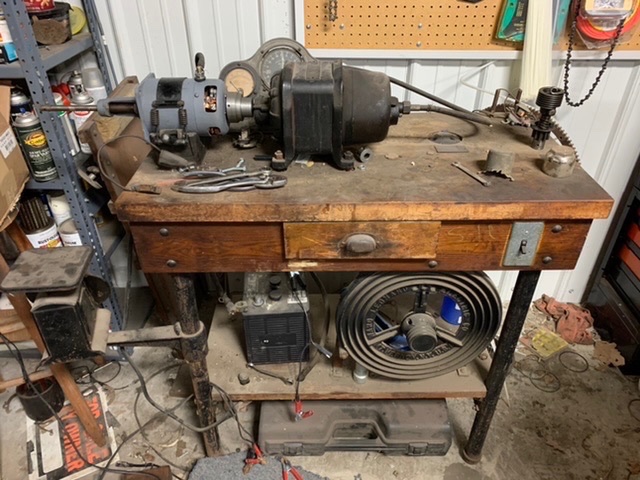

Is one of these on the list?
Generator and starter test stand.
