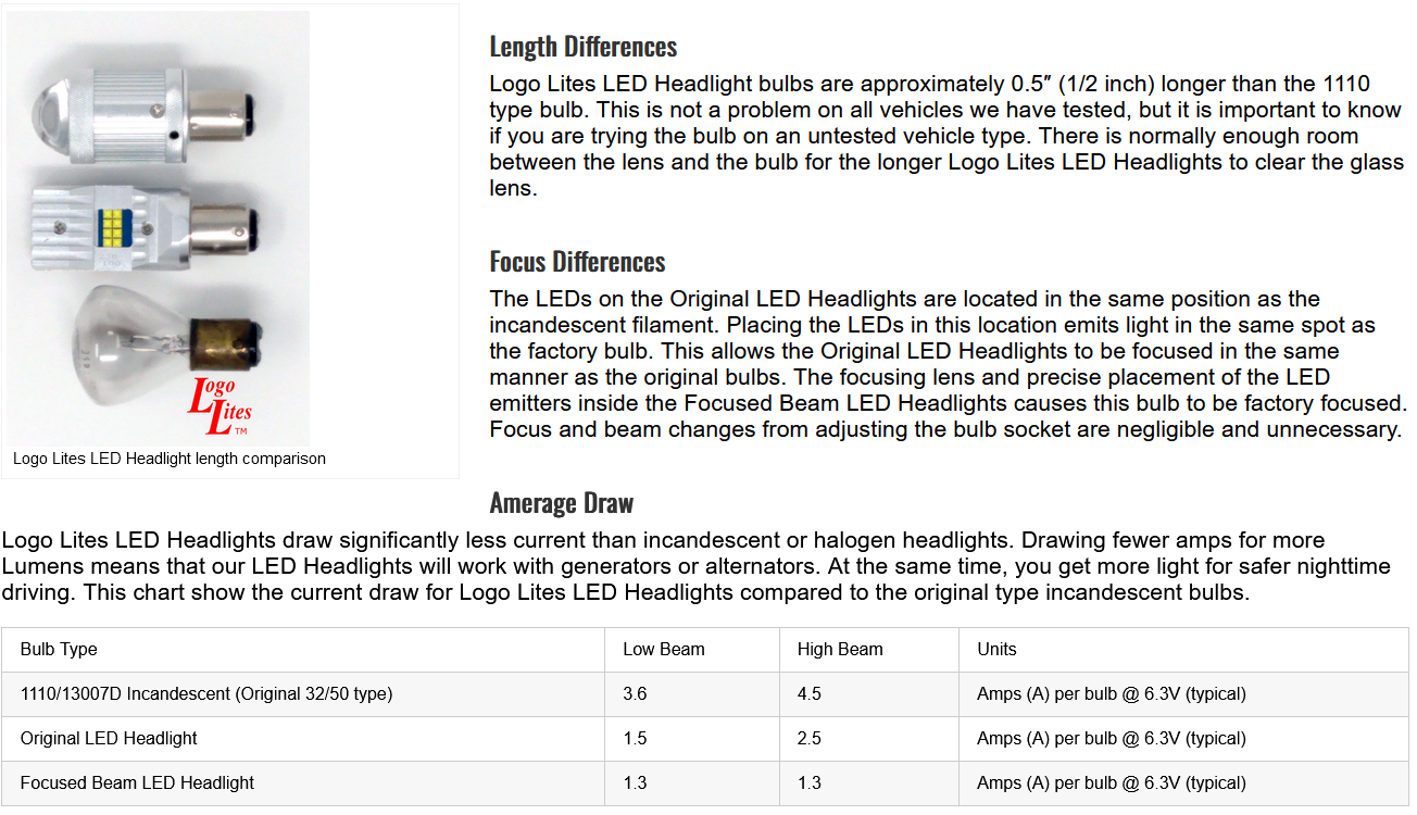

Logo Lights look like a good alternative to both filament & other styles of LED light bulb. 8-) :!:
The Model T headlight socket is either BA15S (single beam) or BA15D (hi/Low Beam). The issue with using non standard bulbs is the that source of the light needs to be basically a pin point to be adjusted into the focal point of the reflector. Its important to understand that the reflected light is then projected onto the fluted lens that projects a light beam out onto the road (or wherever). The PROs & CONs of switching to LED bulbs are less amperage draw and apparent brighter light. However their designs don't emit their light into the focal point of the reflector. Actually this is not much different than an original bulb not being adjusted properly. This diagram illustrates the result. So if you would look at the headlight directly an unfocused bulb would make the headlight lens look brighter than properly focused one. Its also important to know that the color of the light (warm 3500, daylight 6000) will make things look brighter (actually whiter) when in fact the same amount of light, measured in lumens, is reflect onto the surface.
The specifications for the Logo Lights indicate that both the Low & High beam light sources are relatively at the some point allowing for the lens to focus the light properly. As I indicated early the fluted lens is design to focus the light, so I'm uncertain if this will interfere with the Logo Light beam.
While the objective is to illuminate the road at night (note I didn't say brighter headlights) the decision to change light source, falls back on amperage draw. In looking at the specifications for the Logo Lights, the amperage draw is outstanding for Low & High beam. Since it a focused beam, the condition of ones reflectors is of less concern. In fact a bit hazy one may disguise the presence of the led.
I would prefer these at 4000K over the Logo Lights 6500K for a more period look ($35 vs $49) shipping for 1 bulb

The video of the logolites seem to have the right focus, so should work. My intrest is regarding conventional headlight bulbs, and what bulbs were the factory bulbs. I could not find anything in the Ford Service Bulletins and Ford Service Manual regarding the specific bulbs. I did find something in a 1928 Western Auto Supply catalog, they list headlight bulbs for Ford cars with starters as 21-2 cp or 32-6 cp bulbs. Cars without starters are magneto bulbs so that is a different story. The generic part number for the 32-6 cp bulbs is 1172. These show up on Ebay under Eveready, Edison, Mazda, Tung-Sol, etc. The bulbs have "TOP" marked on the barrel for correct orientation. I have not found the generic number for 21-2 cp. I did find some 21-2 6-8 V bulbs that are of new manufacturer that are probably for tail lights, they do have "TOP" marked on the barrel but they do not have the typical headlight bulb shape so they may or may not focus, will have to try it and see.

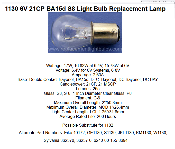

Posts: 6340
Re: Headlight Double Fillement Bulb
Post by TRDxB2 » Sun Sep 03, 2023 1:15 pm
Humblej wrote:
Sun Sep 03, 2023 11:36 am
Larry,
What is the amp draw for 21cp?
Likely it depends on the bulb brand
The following was an entry error on my part that Luke pointed out (Calculation Watts to Amps Watts / volts = Amps , 21/6 = 3.5 amps per filament)
I meant to use the watts for the example 21 CP bulb specification attached
Calculation Watts to Amps Watts / volts = Amps , 16.83/6.4 = 2.63 amps per filament
Also if you look at the specification the watt value changes with the voltage drops
There is an approximation of CP to Watts for filament bulbs that is dependent on a performance factor P (assume 100) & standardized variable 12.57
CP = W * P/12.57 or CP*12.57/100 21*12.57/100 = 2.64 https://calculator.academy/watts-to-can ... alculator/
As Larry indicated these work fine when it's dark and there are no street lights. They should bright enough to alert on-coming drivers
Some seem to be more concerned about the affect of amp draw on the battery & recharging than light output. So lets say your ammeter is at minus 6 amps (for whatever load you have on it - coils, lights, USB charger) and you have a 100Ah fully charged battery. 100Ah / 6amps = 16 hours but that's not reality & would drain the battery. So one can easily expect 10 hours of use. Recharging time depends on the amperage output of the charging system, rated battery Ah, current Ah and even temperature. The formula for estimating assuming needing a full charge. Ah of the Battery / output amps of the charger.
100Ah battery on a 6v smart battery tender output of 2 amps = 100Ah/2amps = 50 hrs on a 6v 5amp charger 100Ah/5amps = 20 hrs
Battery charging - ignore the EV reference - https://ev-lectron.com/blogs/blog/how-m ... battery-at

Luke
Posts: 617
Joined: Fri Dec 13, 2019 1:04 am
First Name: Luke
Last Name: P
* REQUIRED* Type and Year of Model Ts owned: 1926
Location: New Zealand
Post by Luke » Sun Sep 03, 2023 4:40 pm
Frank,
Candlepower (CP) isn't the same as Watts, Ohms law isn't applicable to calculate current draw directly from CP. It may be that Larry's bulbs draw 3.5A, but not necessarily.
Also, with regard to a typical Pb battery, if you want to get maximum life out of them you shouldn't discharge beyond about 30% of their nominal capacity. Thus a 100Ah cell really has circa 30Ah available to the user before they would begin to shorten their life by drawing down further.
Specific cell construction and chemistry can enhance this, and other cell types such as LiFePO4 may be discharged down by as much as 90% without concern, in which case you're able to safely utilise much more of that battery capacity at the standard rate. As LiFePO4 is becoming more prevalent, is a comparatively 'safe' chemistry, and is close to Pb in terms of cell voltage and charging regime, they can be a great alternative if you need extended runtime.
Finally there's Peukert's law which, keeping it simple, essentially means that the available runtime will also be affected by the rate at which current is being drawn from a cell. Cells are usually rated at a standard discharge rate (say 20hr); if you draw more than this the cell will tend to have a shorter runtime than stated, if you draw less it will have a longer runtime. In the case of Pb this could make as much as say 25% difference, with LiFePO4 it could be as little as 1%.
Thus in the example you give it is likely that drawing just 2A from a standard 100Ah Pb battery would in fact give you more than 50hrs runtime (if you chose to discharge the battery to destruction, and ignored the voltage drop), conversely if you drew say 50A you'd have less than 2hrs to run.
Luke.

I don't know much about electricity, but can follow a wiring diagram. I also know the bulbs they used to make are not the same as what's available now.
The 21 cp bulb pictured above is not the same appearance as the originals. It also doesn't mention what the lower cp is.
I don't think they even use the cp designation any more?

Puzzle solved apparently I need a ba15d automotive bulb and the seller listed as an ba15d auto/rv stop turn bulb and silly me since they never mentioned filiment or marine I assumed it was a stop/tail dual filiment ba15d base bulb. Now that I know since and I don't have time I'll simply rewire it for marine (single filiment dual base) and order something right. Then transfer the bulbs to the speedster as the ground has beed problematic in the past and it's just on/off light switch.

babychadwick wrote:
Thu Sep 07, 2023 9:03 am
Thought I'd add the difference between the connections & pins for automotive & marine. The marine bulbs could be used for those T's where the headlight bulbs are wired in series.
The bulb base BA15 s/d are mostly called taillight bulbs Today. The BAY15 s/d are also taillight bulbs but brighter but have offset pins so they don't fit the T sockets.
Snyder's sells the Focused LED bulb for a better price - not sure of color
