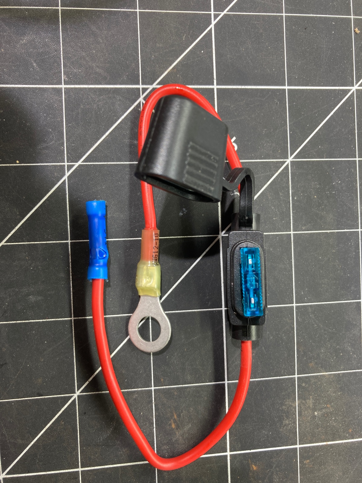

Post by AdminJeff » Tue Sep 05, 2023 12:02 pm
Here's what my inline fuse looks like. 5 minute install. If your power for the car comes off of the starter foot switch, install it there instead.
I'm providing one with every Voltage Regulator I sell. Cheap insurance!
