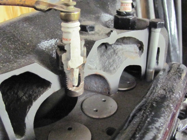

Note the bolt in far right distance, the amount of threads still in the cylinder head, and only the end threads do the chore.

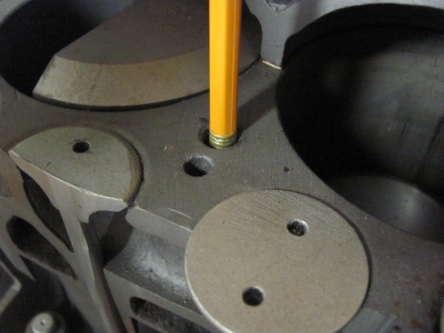

Here is what I did on my car. I used a bottom tap as Dan suggested and blew out the chips with an air gun, being careful not to leave any chips in the cylinders. I measured the thickness of the head. I then screwed a bolt into the block all the way down, finger tight, using some oil, without the head on, and marked the bolt where threads were at at the top of the block. I then added the thickness of the head to the depth of tread engagement and ordered bolts from McMaster Carr that were that were slightly shorter. I ordered grade 8 bolts but grade 5 will do. They come with different hex sizes so if you are not using washers get the larger hex. When the bolts came I placed the head on the block without a gasket and screwed down all the bolts finger tight using some oil. This is to make sure that none are bottoming out in the block. The holes in the block can be slightly different depths so it is important to check all the bolts. If some are slightly too long the ends can be ground off or slightly shorter bolts can be ordered.
I used the standard torque sequence and checked the torque after the first engine warm up and then in about 100 miles and again at 500 miles. If you are using an aluminum head use thick stainless washers, not the ones that come with the head, and follow the torque recommendations from the manufacturer.

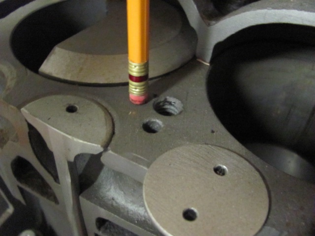

To prevent rust chips, dirt and debris from getting down into the cylinders and lodging between the pistons and cylinder wall on top of the rings, it is best to totally seal all four cylinders with masking tape. It is much better than using rags, which will not prevent debris from entering the cylinders Through the wrinkles and folds of the rag. Be sure to remove the intake manifold and blow out the intake valve port from the top to ensure no debris remains that can be sucked into the cylinders after reassembly. Jim Patrick
PS. As you clean each bolt hole, be sure to place a piece of masking tape over the cleaned hole, so no debris from the holes you are cleaning fall into the newly cleaned holes.
