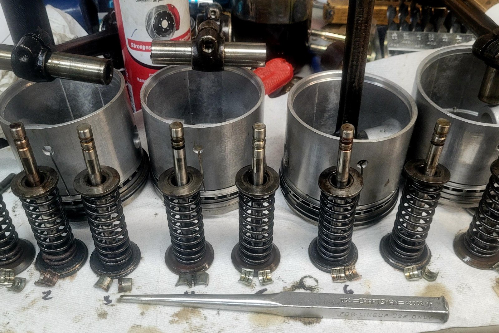

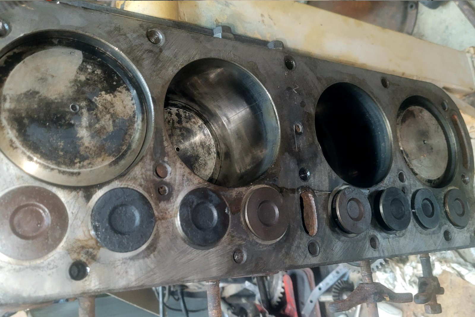

I went out just now and had a look. The top of the valve galley is clean and mostly raw Cast iron colored:
3211
3210
Then I noticed a spot that initially concerned me:
3213
So i hit it with a scraper and some steel wool. Almost all of it came off to reveal solid cast iron underneath. I'm confident the galley roof is fine.
3212
This is the gasket (head surface side). You can see where it was weak or not sealing. The block side is pretty consistent
3209

One thing about an external anti-freeze leak that ran down and seeped through a valve cover gasket, all of the fluid that got into the engine would stay there. No evaporation.
It's also possible that the engine accumulated some internal condensation while in storage. It would also remain in place, protected by a seal of motor oil.
Internal condensation rarely occurs here, but it might be a problem in Vancouver.
I have seen metal objects, especially things like engines, streaming with water condensation on a warm winter day. I've seen the inside of uninsulated metal buildings stream water under the same conditions. Tools in tool boxes become soaking wet. Concrete floors become soaking wet. Under those conditions, engines will sweat water inside and out, as will axles gear boxes, fuel tanks, etc.
(Cold night, followed by Gulf warm front laden with heavy moisture)

No, it never froze and I don't see any cracks in the block, cylinder walls, valve galley so its possibly in the head.
I feel the real issue is the head being slightly warped and needing a re-torque that was never done. You can see from this photo of the Gasket (Head Side) that it was not completely sealing, allowing it to run down the cylinder walls past the rings and wicking in through the valve galley cover.
This rig sat a lot, so i think was a slow process. it sat in the same heated storage from 2001 to 2022 with Anti-Freeze in it until i drained it yesterday. I think it ran last 5-6 years ago.

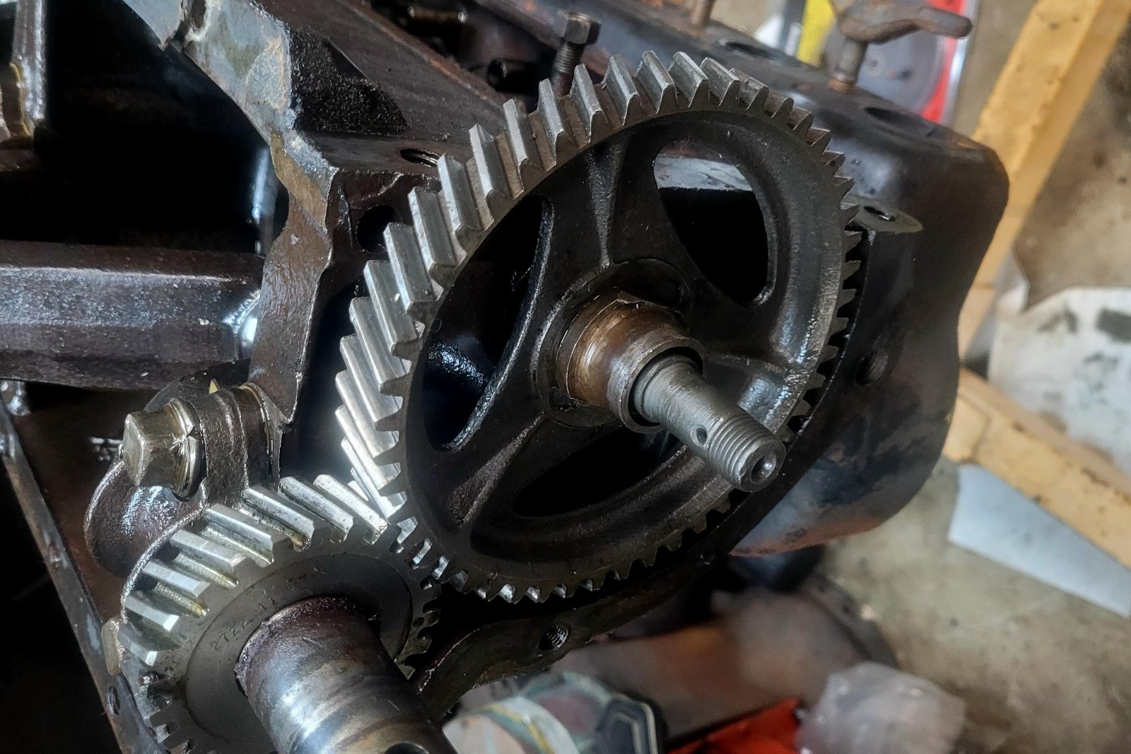

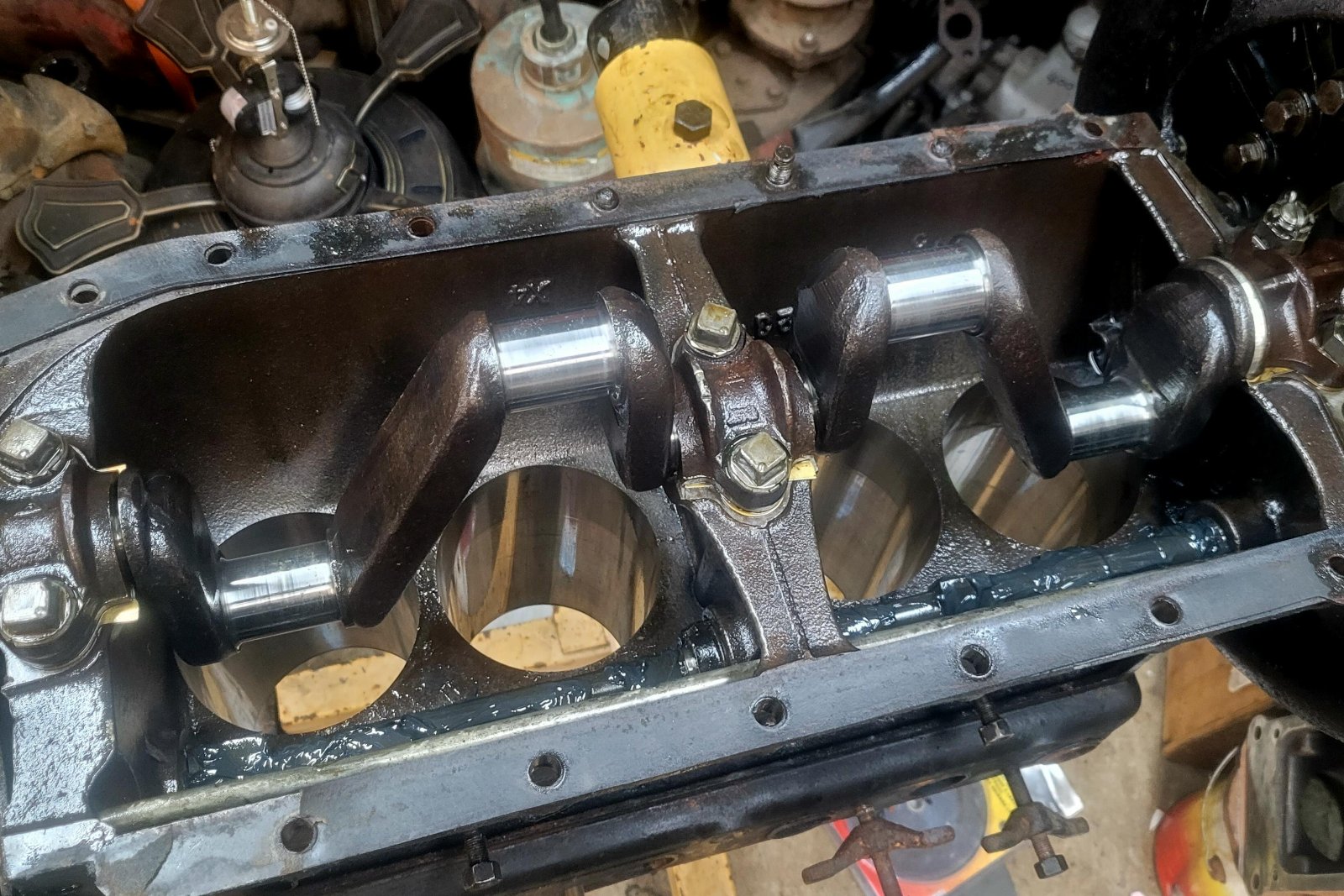

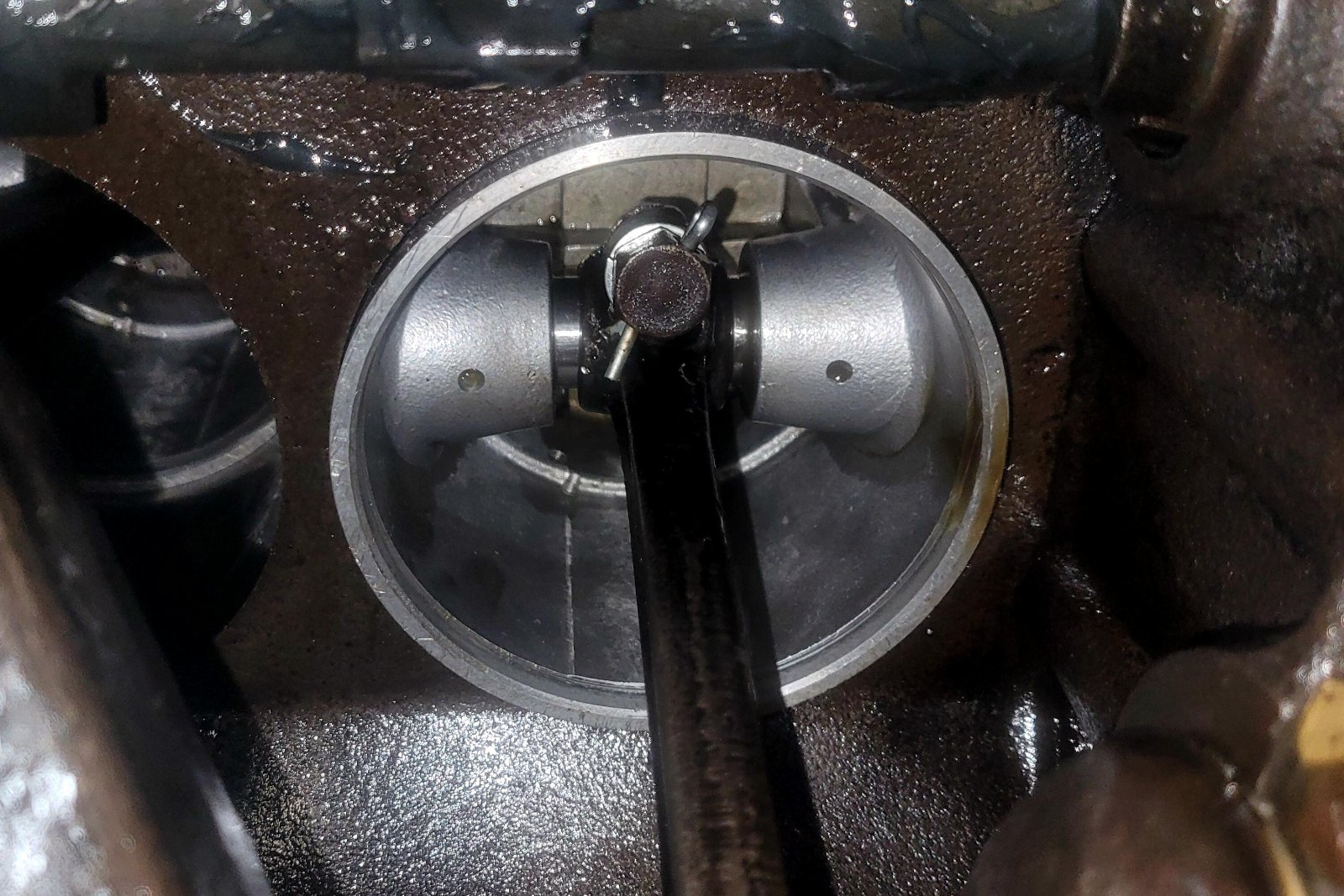

So I pulled the inspection cover and the hogshead cover and here is what I found. There has definitely been some moisture in this engine, not a lot, but a little bit. its most evident in the transmission. Looks bad, but should clean up fine.
3214
The good news is the bottom end looks pretty spotless. It needs to be pulled apart and cleaned real good, but other then that, its pretty clean.
3215
The inside of the inspection cover however....yuk!
3216

So I got the TT engine torn down and cleaned. For the most part, it was pretty clean but it certainly had water (not anti-freeze) in the oil a while as it was everywhere. The Anti-Freeze was a newer addition, but it had not run with that in it as far as I can tell.
I did find that the aluminum pistons were in backwards (slot away from the cam), so I pulled them all out, Drilled the wrist pin oil holes as suggested and flipped them the correct direction.
I also took the opportunity to pull and clean the valves (they had water them a little bit) and swap out the stock cam and fiber gear for a .300C full race grind and a steel gear.
Also flushed out the bands (which were new looking) and pulled and cleaned out the clutches. Glad I did, they were gross. On reassembly now, hopefully it will be together and back in this weekend.

New piston rings?

Post by ClaytonPaddison » Wed Sep 13, 2023 7:20 pm
TXGOAT2 wrote:
Wed Sep 13, 2023 6:49 pm
New piston rings?
No, they were fine and had little hours since it was rebuilt. Didn't see the need. Last time I heard it run, it didn't smoke and had tons of compression when I pulled it over by hand.

Think they will be an issue?

Pretty sure the expansion slot in the piston goes opposite the camshaft Clayton.

Post by ClaytonPaddison » Thu Sep 14, 2023 11:38 am
RajoRacer wrote:
Thu Sep 14, 2023 11:08 am
Yup, you are correct....*sigh* I'm like 0-2 on this thing. Was REALLY sure with myself it was towards the cam. Guess I have to redo it now.

Just a few thoughts, based on our pictures.
1. Your main bearing shims look so far out of alignment, with the one end poking out, that it makes me wonder if the other end isn't hanging into the bearing and getting pinched by the crank shaft journal. Wouldn't be the first time that has happened.
2. Your camshaft timing gear looks fairly worn. Have you checked the backlash? Not saying it won't still turn the camshaft, but with the high lift you're running it may be very loud.
3. As Pat alluded to, reusing the rings might not be good thing. The old rings will have been seated in to match the existing bores. They will never go back in with the exact same alignment that they've been seated to, and they will not likely re-seat themselves against the existing mirrored bores. Especially considering that your bores are apparently being used "as-is". I believe new rings, and at least touching up the bores with a light honing, would be best.
1) I will check and re-adjust.
2) It is a used one, but it's not too bad at all. I will check Lash, but i doubt it will be much of an issue.
3) Will order new rings then and hone the cylinders. I don't want a smoker
