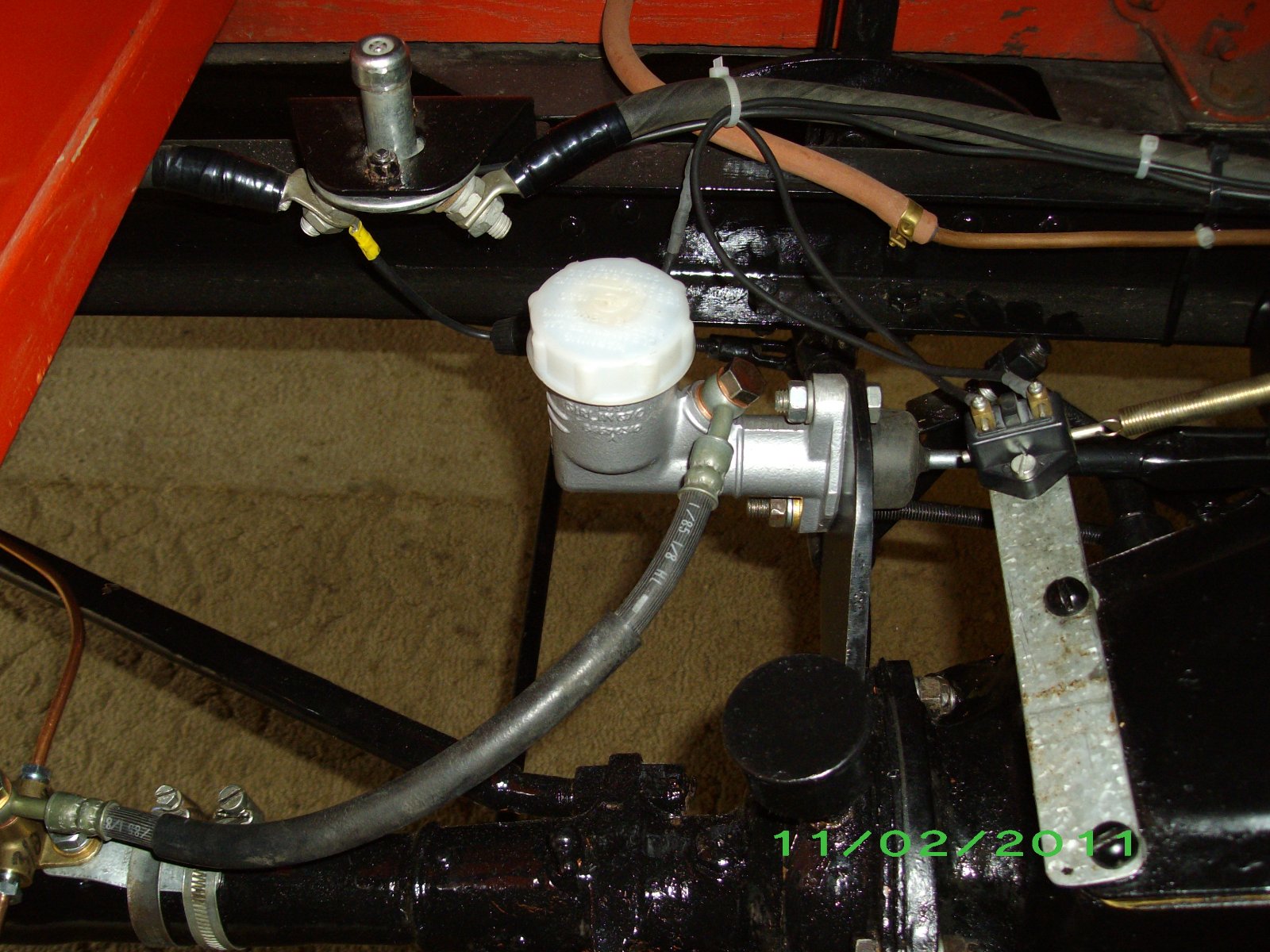

Re: starter switch in a 1912
Joe ; I mount the switch on the same location as by the later once's .
Toon
