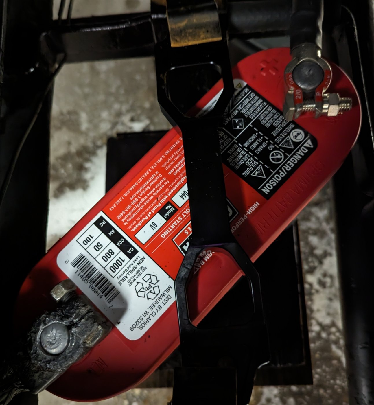

For the 6 volt Optima battery , I used two battery boards underneath to support and lift battery in the carrier, 2/0 battery cables ( picture shows old braided negative) , split sections of gas hose , covered battery holding frame, to protect positive cable from grounding out, and got cast metal battery hold down from e-bay to fit and more importantly be retained by original Ford battery clamps. Later modifications to hold down were made to have hold down straight between front and rear clamps, and negative cable was replaced with a 2/0 negative cable.

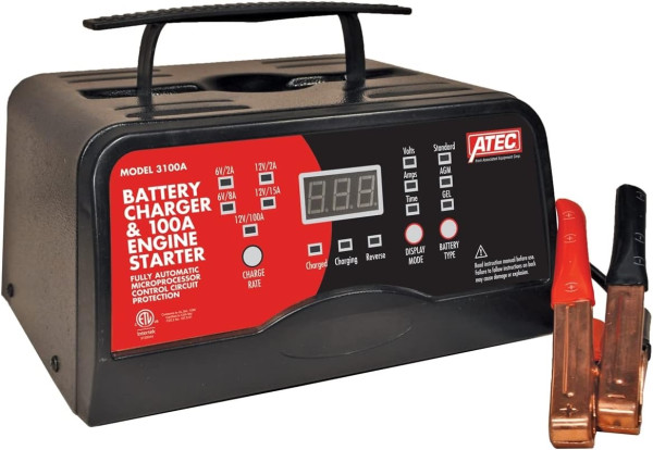

I recently purchased a really nice computerized battery charger that automatically discerns whether you are charging a 6 volt or a 12 volt battery. You don’t need to flick any switches or anything. Just plug it in and connect the clamps to the proper posts and let it do its’ work. Do you think it can discern that it is charging an 8 volt battery and make the necessary adjustments? Jim Patrick
Posts: 5294
First Name: john
Last Name: karvaly
Location: orange, ca
Re: 8 volt battery
Post by speedytinc » Wed Oct 04, 2023 10:43 am
jiminbartow wrote:
Wed Oct 04, 2023 9:46 am
No it cant.
There are 8V battery tenders. I finally broke down & got one.
Charging with a 6/12 V charger is a bit tricky. if the battery goes dead, I use the 40 amp 6v charge. It will get to 6.5-7V.
Then use the low amp setting @ 12V for 20-30 minutes, then check.
