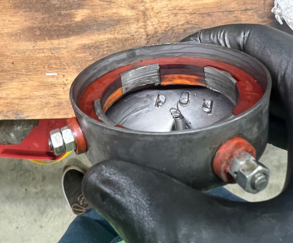

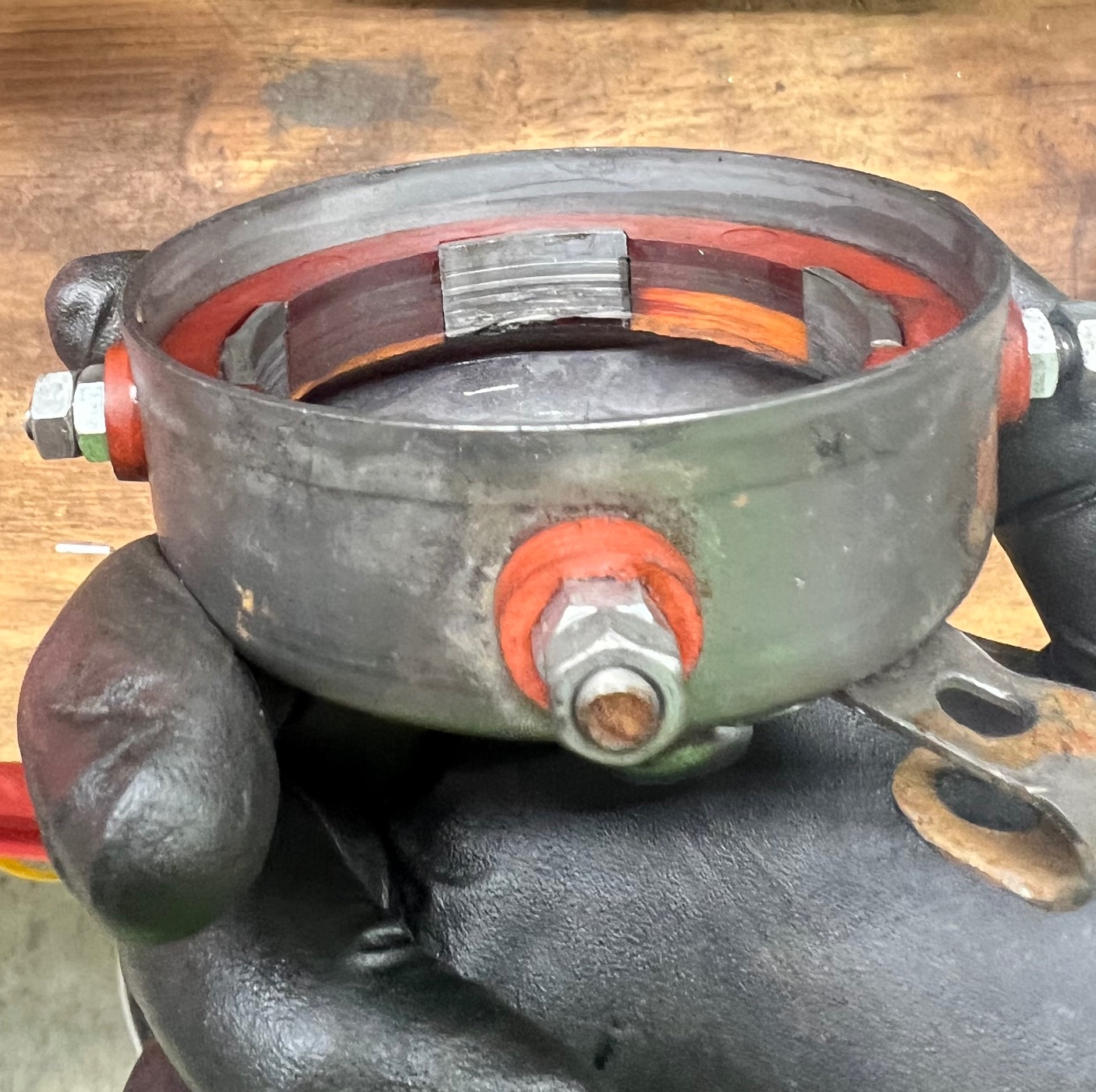

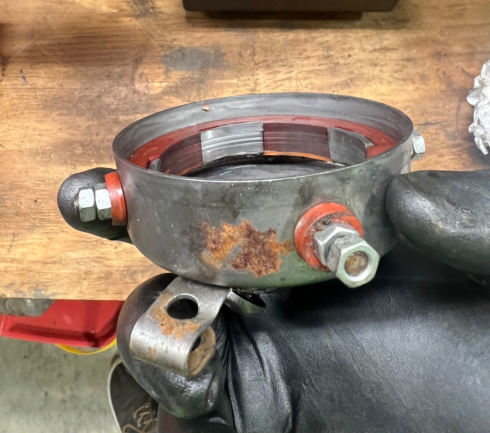

Just got back into the house from the shop. Here are some photos of the timer after I took the housing off and cleaned it up. I noticed a lack of any type of lubricant and TONS of metal shavings. I cleaned it out a bit and took some photos. I do not know what kind it is, you'll have to forgive me as I am new to this. This is my first model T.
With the little research I've done, and just common sense, this looks pretty...not okay.

I recommend purchasing a new timer. If you can afford it the best timer is a electronic solid state one. Next best is a brush type and lastly is the standard roller timer.

Make sure there is no metal shavings behind the insulator ring. Oil the roller & put it back on. See if the mis is gone.
If it runs OK do so..... (while you wait for a new timer.)

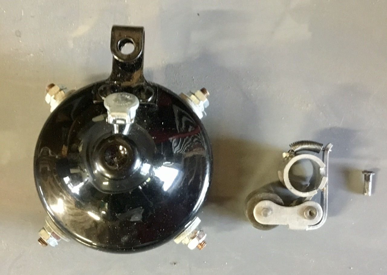

I can't tell you much about installing timers other than New Days. It's pretty obvious - the cap shows which color wire goes to which contact. You just have to route the wires so they don't interfere when the cap is rotated.
Hopefully a previous owner replaced the original felt camshaft seal with a neoprene one and discarded the brass plate that went with the felt one. It's easy to do and might be something to consider if it hasn't been done.
You install the brush over the camshaft, holding it in place with a little pin that comes with the kit. There is a special washer that slips over the pin and holds it in place, then you tighten the nut over that. If the hole for the pin goes all the way thru the camshaft there is the possibility of installing the brush 180 degrees off from it's proper position. If the hole doesn't go all the way thru then no problem.

Those deep scratches inside your timer could cause the roller to bounce and are almost certainly the source of your misfire. I purchased my roller type timer from Snyder’s. It looks just like the original, is well made, is made in the USA and my T, which I have had for 53 years and has used a half dozen different types of timers over the years, has never run better. I highly recommend it. Part #T-3165, $69.95. I lubricate mine with a mixture of Vaseline thinned with 3 in 1 oil wiped around the contacts ring with my finger. Be careful of the oil or grease you use and be sure it does not contain conductive (electrical) elements such as graphite or molybdenum or it will ground out. It needs to be totally non-conductive on Model T electrical components. Jim Patrick

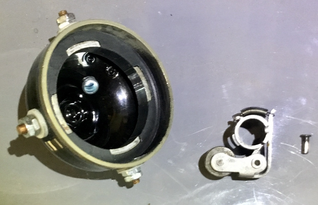

I have all new wiring ready to be installed, just waiting on the timers to arrive so I can take a day and do it all at once. The coil box still has wood panels in it, I was thinking about refurbishing the coil box as well. I can't tell if it'r original or not, but it looks clean. All of the connections in the box appear to be in good shape and not flattened out. I figured I'd start with the wiring and then refurbish the coil box later on this winter. I have been eyeing up the wooden replacement kit from Lang's as I'd like to keep the care as true to its original manufacturing as possible. Thank you for your kind words!John kuehn wrote: ↑Sun Oct 15, 2023 8:19 pmYou mentioned the wiring being in really bad shape and pieced together saying it’s been frakensteined together. That’s a big sign to rewire your 24 Coupe! What’s happened is it may have the remains of the original wiring patched up and I don’t know that but whatever it is it’s got to go!
The battery cables may need changing too. Old cables do get hard and brittle insulation.
When you get your new timer use the wiring diagram and start with no.1 from the coil box and do 1 wire at a time. Same thing replacing the ignition switch wiring. It’s not hard to do and take your time. You will be surprised what new wiring will do for a T.
Is the coil box original or has it had the wood replaced or has the old wood been replaced with the improved coil box material that’s popular to use. That will come if it’s necessary after the new wiring been installed. Good luck!
John Codman
- Posts: 1532
- Last Name: Codman
- Location: Naples, FL 34120
Re: Missfire
When I bought my T nine years ago, the first thing (second thing, actually) that I did was to order a complete wiring harness from Lang's. The original harness was in bad shape, and I have seen several collector cars burn due to bad wiring. Lang's harness fit perfectly and all of the color codes were correct. It appeared to be of excellent quality. I don't know if they are still using the same supplier, but if so, you should be happy with it. FWIW: Be sure that you know the proper routing of the wires. You have said that the wiring has been "Frankensteined", do not assume that the existing wiring is routed correctly.
- Posts: 4578
Re: Missfire
Another point about replacement Model T wiring besides the correct color is the size of the eyes on the wiring. A while back a supplier used the pretty much correct colors but the eye connectors were a bit to large. They would work but were a little large and you had to make sure they weren’t to close to each other where they attach to the ignition switch back.
