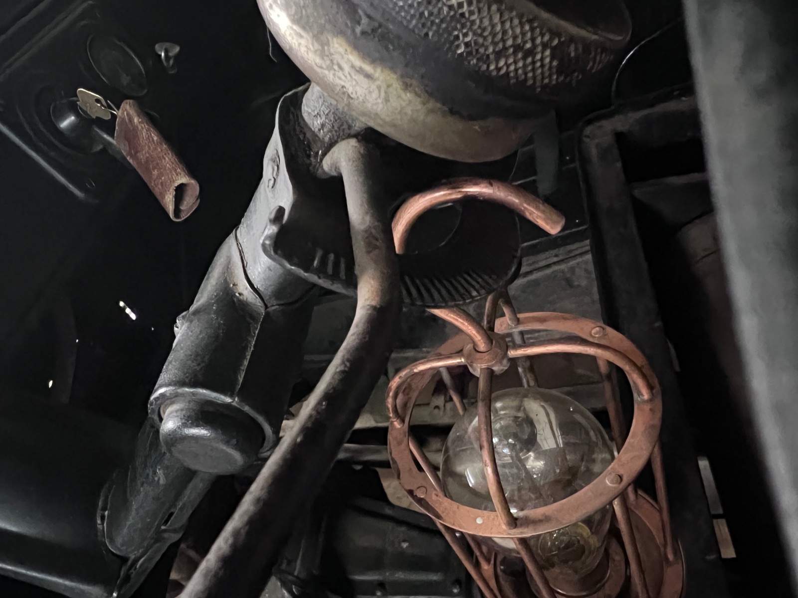

As it was ,, here is a photo of how far the timing lever would have to be to be in the commutator hole .
So , I have a little bending to do .
The way it was , I’d have had that lever half way down till it fired right at tdc .
Obvious someone didn’t have it “dialed “ in
