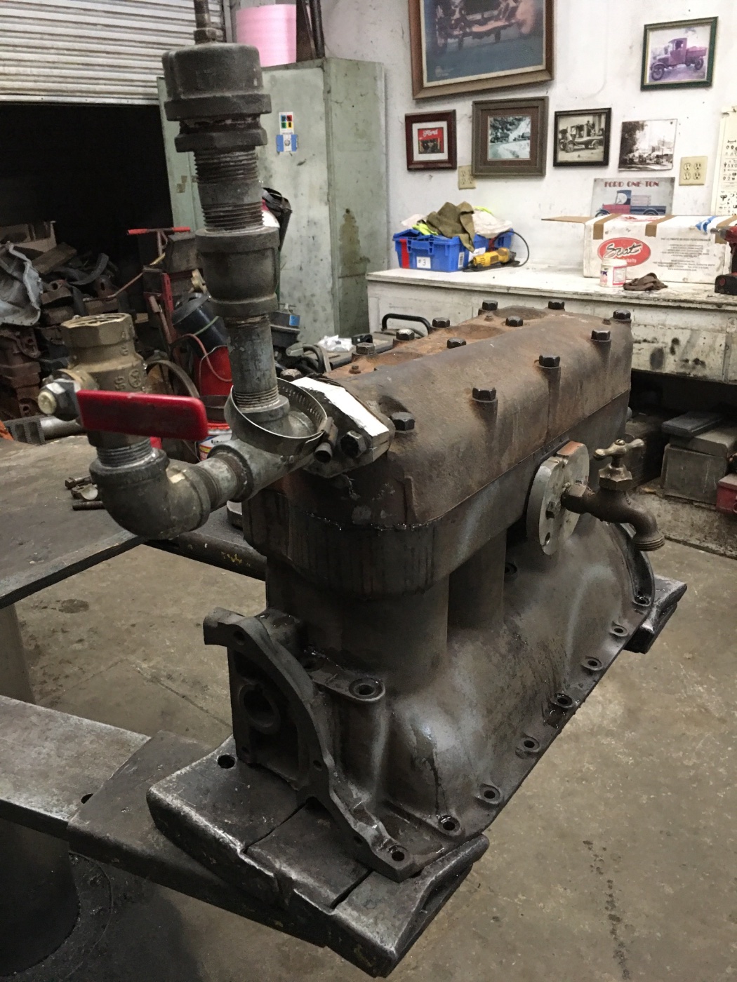

Here is my pressure test setup. Whole thing is filled with water and 25 psi is delivered to the pressure dome on top. Then watch for leaks.

Heres my setup on Model A , but I have one also for T'shttps://youtu.be/t9USpJEbLLQ?si=P7PIAz-dmz4G51fL

Snyder’s use to sell a plate for T & A for pressure testing. Had a rubber gasket glued to it. You can also test heads with it.

Erik Barrett wrote:
Wed Oct 11, 2023 11:00 pm
I think that is just the absolute neatest thing! I love seeing stuff like this.
