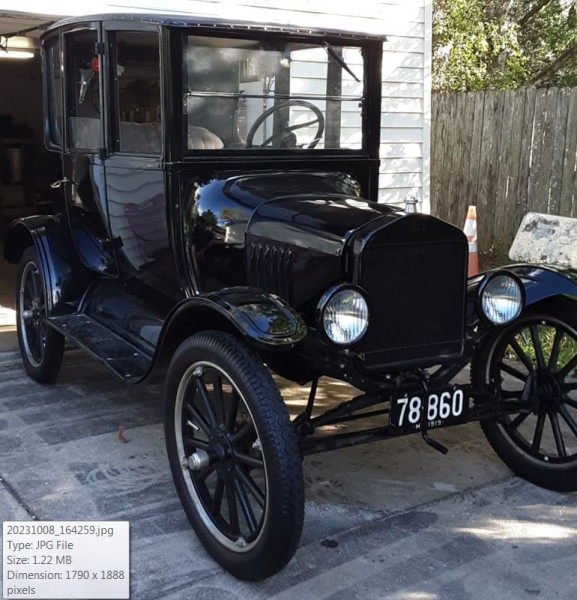

I added another Model T project car to my plate - this time a 1921 Centerdoor.
The restoration is quite far along with new paint and interior sitting on a running chassis but the progress stopped and got stuck on the windows. It i has lift strap glass on all 6 side windows. I did not disassemble the car so I am not sure of some of the details.
Where they got stuck is getting the windows to close. Two windows are missing and the other 4 are mixed up. The curves on top do not match the roof profile. I have to remove the installed ones and measure everything. The glass specs book will tell me if the existing glass is even cut correctly.

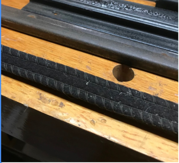

I have a '22 Center Door that I replaced all the glass in once I bought it in 2019. It had all original plate glass in it. I replaced it all with safety glass.
Right or wrong, How I did it.
I Used the foam in the top of the windows you asked about. Glued it in, Works fine.
The glass side felts I got from Sniders I think they all use the same felts. The deal is the new felts are so much better than the originals I pulled out. They thicker, metal backed, so much improved. But being thicker, which makes the glass harder to move. Mine now, after a few years move pretty good. If I had to do it over I would have my windows cut a little shorter on the sides. Not much, maybe 1/4 inch.
I didn't use rubber in the windshield. I used a silicone tube sealant. The brass edging that Ford used is really thin and will be destroyed when you remove the glass. No one I know if reproduces that brass edging. You wouldn't want it if they did reproduce it. Its about as thin as tin foil. I don't know how Ford got it to work.

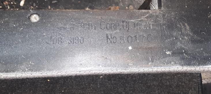

My 1922 center door has brackets on the forward windows. They changed them that year. The only windows with straps are the rear two. You didn't say which window bottom channels you needed. Maybe they are all the same, I don't know, as like I said. have brackets on the front four windows.
But, When I bought a Touring car it came with some extra parts. See below. I have two windows, with glass, that I think are for the rear center door windows. Still have the original straps. If interested, let me know.

Nobody reproduces the original felt glass channels. That takes a specific industrial sewing machine.
You’ll need to use the available metal/felt channels. I was going to see if I could re-use my originals but I can’t because the thread is rotten.
The metal channels at the bottom of the glass will need to come from glass from another car as they aren’t reproduced either.

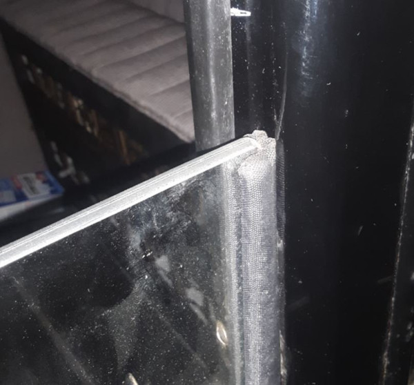

The replacement window side seals that someone installed is glued to the glass with a soft seal with a tough outer shell so that it does not wear out sliding up and down the wood channels. It is not like any of the normal window felts I have ever seen. Looking at Snyders (and others) nothing strikes me and says it will work. Do you have a suggestion to which one might work?
I have an industrial sewing machine but not sure if what I have is a good sample or not.
The window glass bottom channel is length matched to the size of the window. On mine the front, door and back are different sizes.

I am pretty sure my extra windows are rears. See below, channel is about 18 3/4 inches. Don't think they are what you are looking for.The window glass bottom channel is length matched to the size of the window. On mine the front, door and back are different sizes.

This is the stitch that the original felts used. I’m not exactly sure the technical name for the stitch. The stitch itself causes the felt to be sewn at a 90 degree angle. It appears to be one piece that has had two 45 degree pie pieces cut and then the machine folds it and stitches to make a channel. AFAIK there is no machine on the market today that does this.Mike Silbert wrote: ↑Tue Oct 24, 2023 12:05 amThank you for the information.

That original seal is very interesting, How and where is it supposed to be fastened?
The glass goes up and down plus in and out during normal operation. Quite different from normal car windows.
It is nothing like what is on the other windows of the car.
And I can not find a match to what the other windows used, not that they fit properly anyway.
One answer leads to lots more questions.
I have more research to do and maybe someone will chime in with a "This Works Good"
The original seals look they were done on a serger or hemming machine machine, which I do not have.

It definitely appears to be a overlock stitch.
The felt seal I showed goes down each side of the pillars for the glass to ride in. It was attached with a large nail top and bottom. There was nothing remaining in my window headers for sealing.
