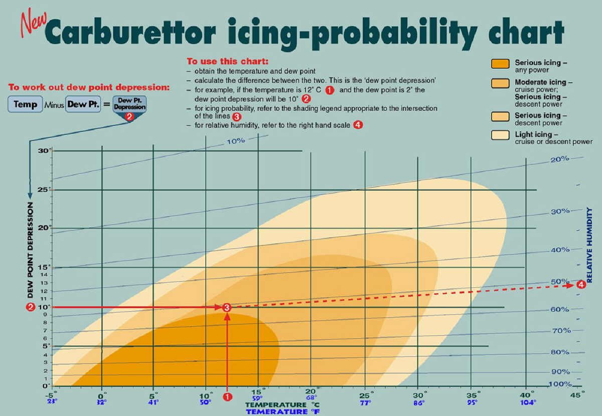

You have to understand the Venturi Effect to understand the icing problem.
Professor Fate
Posts: 763
Joined: Tue Jan 08, 2019 12:39 am
Last Name: S
* REQUIRED* Type and Year of Model Ts owned: '23 and '26
Location: Taxachusetts
Re: **CARB ICE**
Post by Professor Fate » Mon Oct 23, 2023 4:34 pm
That chart is awesome!

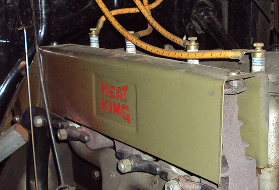

"Hot Spot?"
3
________________
**FATE**
Posts: 7677
Re: **CARB ICE**
Post by TXGOAT2 » Tue Oct 24, 2023 12:31 pm
A T engine would benefit from a well-regulated hot spot arrangement. Under severe conditions, both intake air preheat and a hot spot would be beneficial. Some newer vehicles have rather elaborate manifold heat and intake air preheat systems. They work very well when they are in good condition. If you live where icing/condensation are a frequent issue, modifying the heat pipe to collect more heat may be an option. The exhaust pipe from the manifold back to about the hogshead gets very hot very quickly, and putting a sleeve around it that is attached to the stock heat pipe would probably be helpful. A damper arrangement to prevent excess heat would likely be needed.
