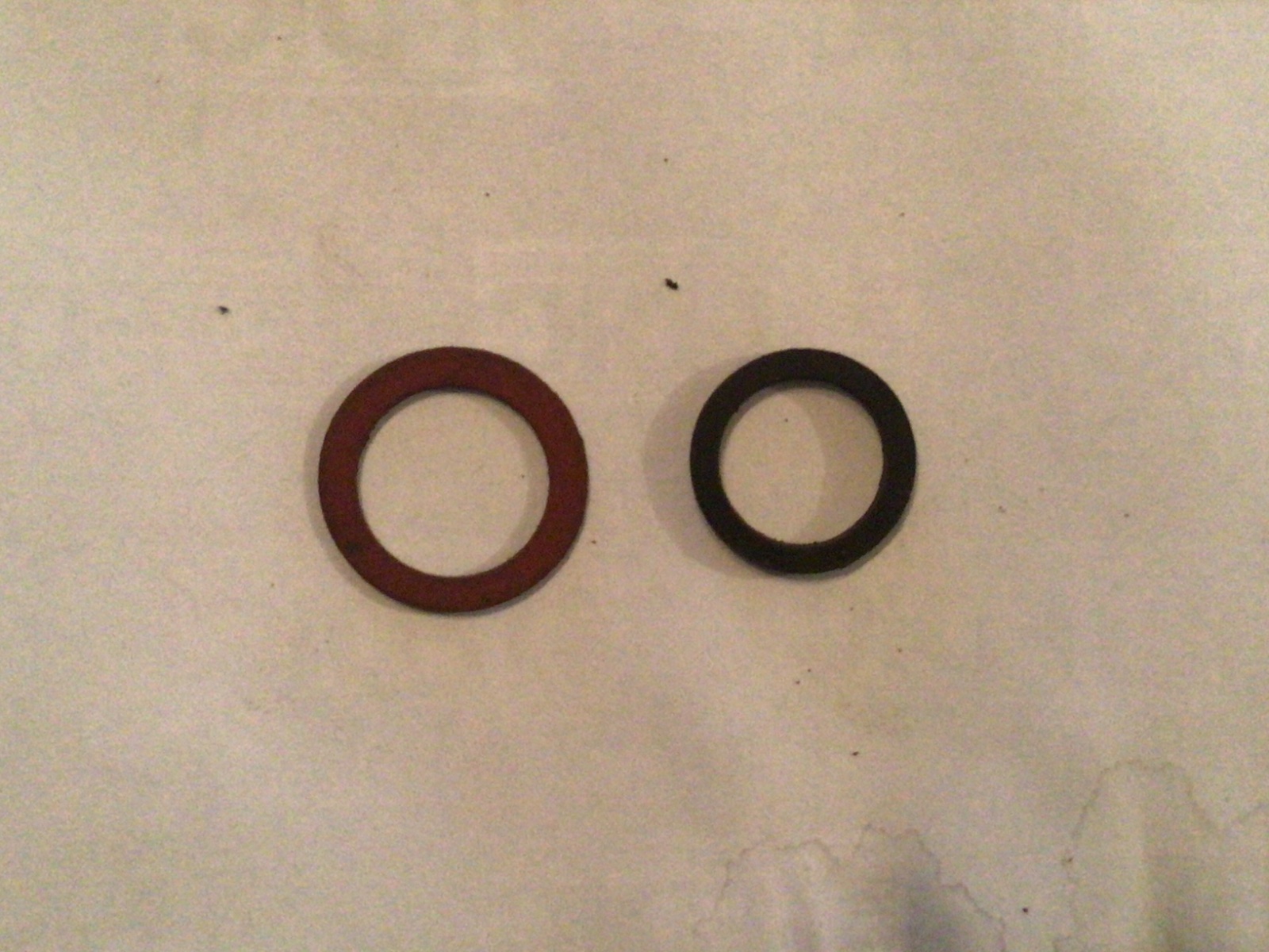

I noticed the last few sets of NH gaskets I’ve received were missing the spacer that goes between the body and the bowl (left in picture). Today I got a couple more sets in the mail and once again this piece is missing. I wonder was there was a batch of sets put together without them? I’ve been finding some in a bag of loose gaskets I have but they won’t last forever. I’m aware of the fact that you don’t have to put it there but it crushes the bowl in when you tighten it. Curious if anyone else has gotten these sets without the spacer?

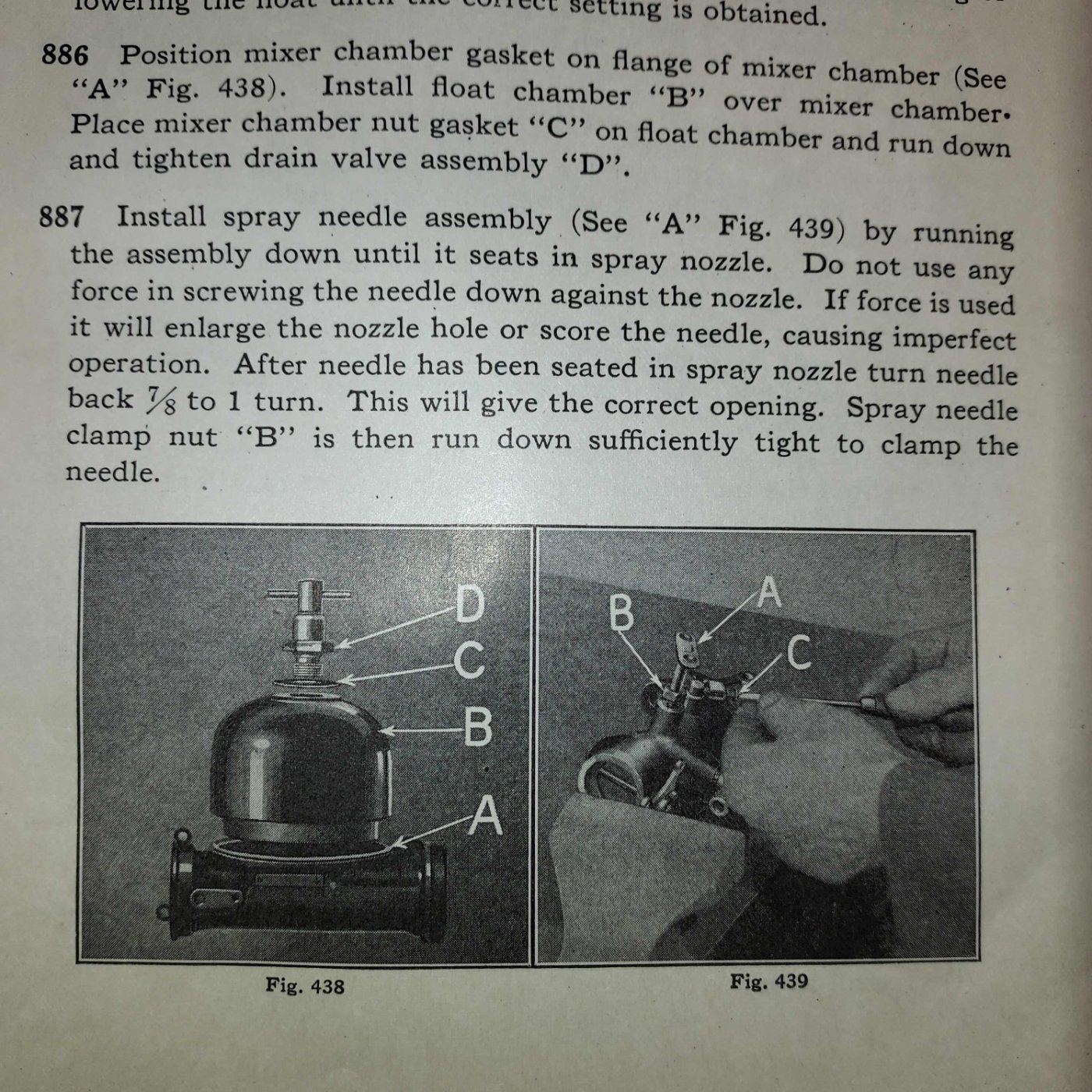

I do not remember ever using two gaskets at the bowl drain. Looking at the Ford Service Manual para 886, fig 438 just shows a gasket on the outside of the bowl.

The sets I have been using for years dont have that extra gasket.
It isnt needed. Per the manual, as shown.

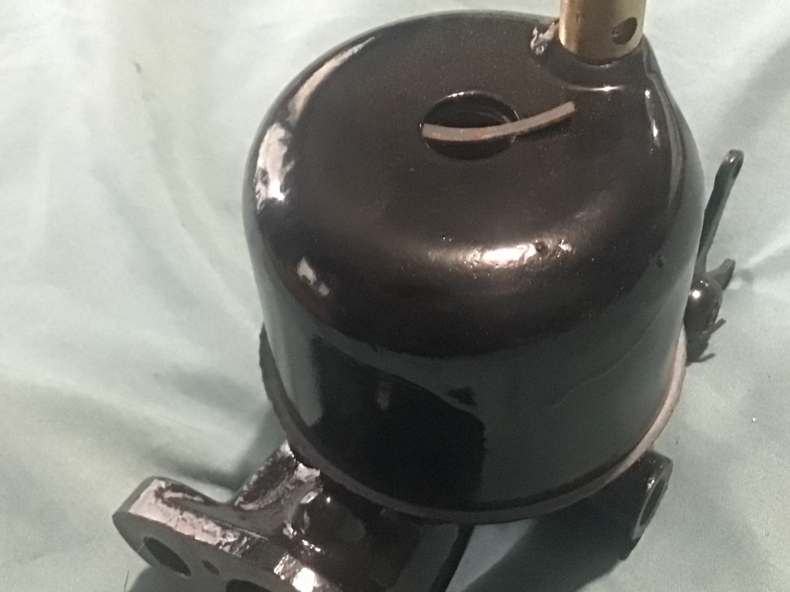

I know now why the gasket sets were like that. A lot, probably most, of those bowls are bent in at the bottom but they were originally flat and can be straightened to be flat again. This bowl appears to never have been deformed and as you can see with the bowl gasket installed there is that much space between the carburetor body and the bowl. That little spacer sandwiches between there to keep everything flat, but no, it doesn’t have to be there.
