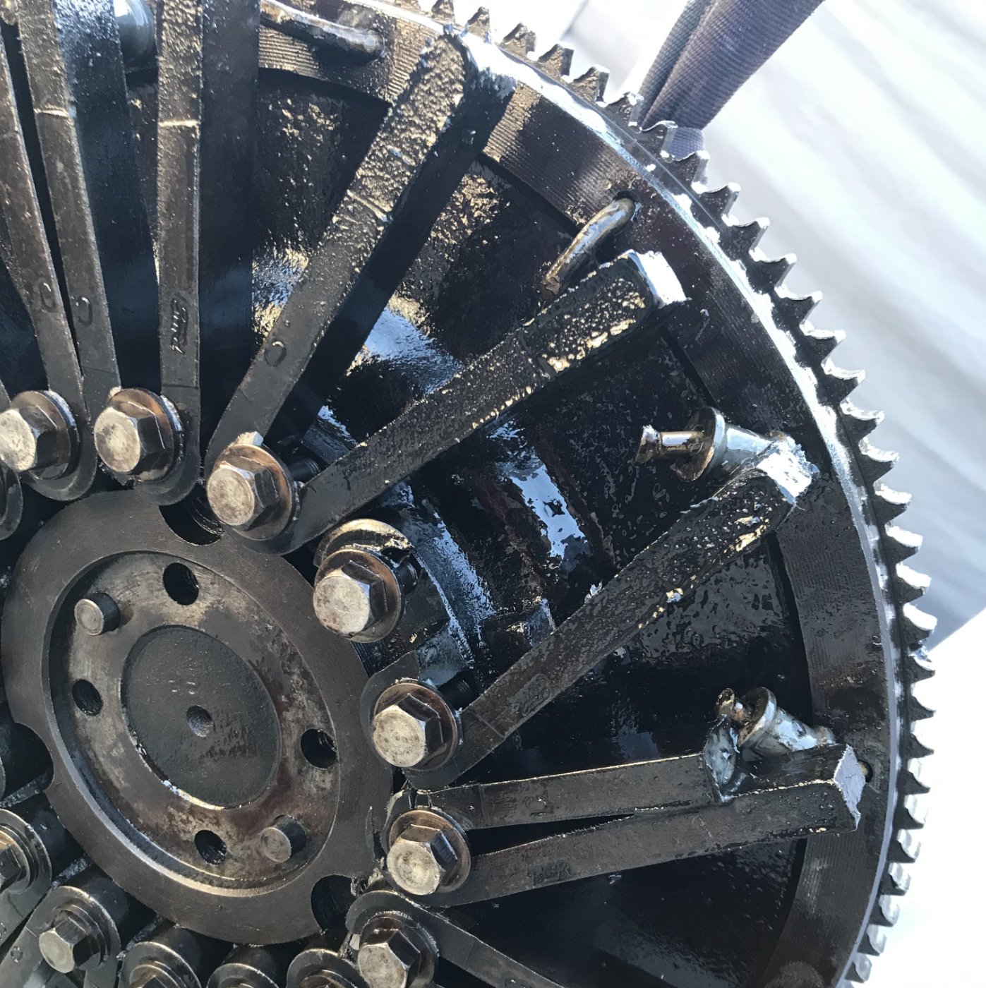

I used synthetic oil and this happened!!
jiminbartow
- Posts: 2473
- Last Name: Patrick
- Location: Bartow, FL
Re: What oil do I use?
Can you blame that type of damage on a certain type of oil?

Dan McEachern wrote: ↑Mon Oct 30, 2023 11:26 pmI used synthetic oil and this happened!!

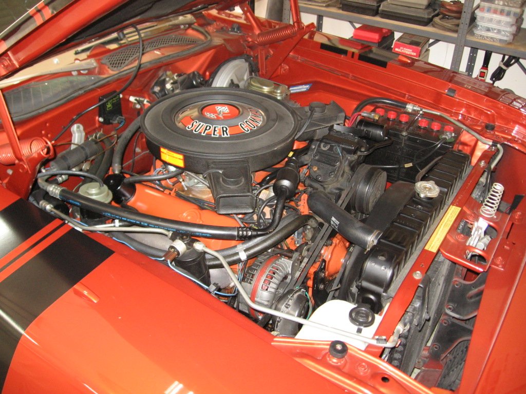

I expect my GTX needs it less than my T due to its better design & not relying on an inconsistent splash system.
Its my understanding, lubricative metals(ZDDP's) are removed, refined out & not added because of the possibility of clogging catalytic converters.
I dont run a catalytic converter on my T so......
Anyway, the oil I use is more in line with the motors design.
It may not matter, but Ill buy the cheap insurance with oil I cant get really, really cheap @ Wall Mart.
Thats my thinking. I dont preach either way.
- Posts: 2548
- Last Name: Strange
- Location: Hillsboro, MO
- Board Member Since: 2013
Mopar 440 (and other big and small block V8s of the period) still rely on splash to lubricate the cam lobes.
I used to own a 1971 Plymouth GTX:

The T4 oil might improve transmission and brake band performance. The T clutch is metal-on-metal, and designed to operate with plain motor oil, so I doubt it would either help or hurt it. Mutil-grade oil is the best thing for Model Ts and similar engines.
