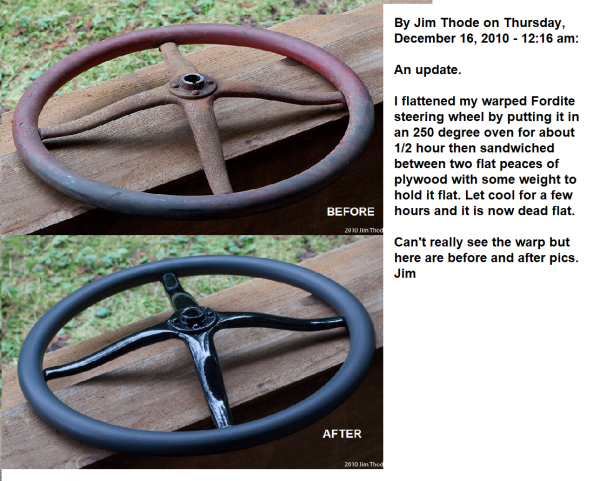

Posts: 6547
Re: Fordite steering wheel finish?
Post by TRDxB2 » Mon Oct 30, 2023 11:24 am
From two earlier posts above https://www.mtfca.com/discus/messages/1 ... 1292601172
from another
