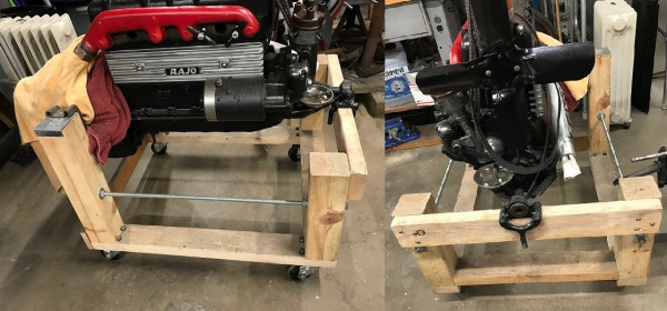

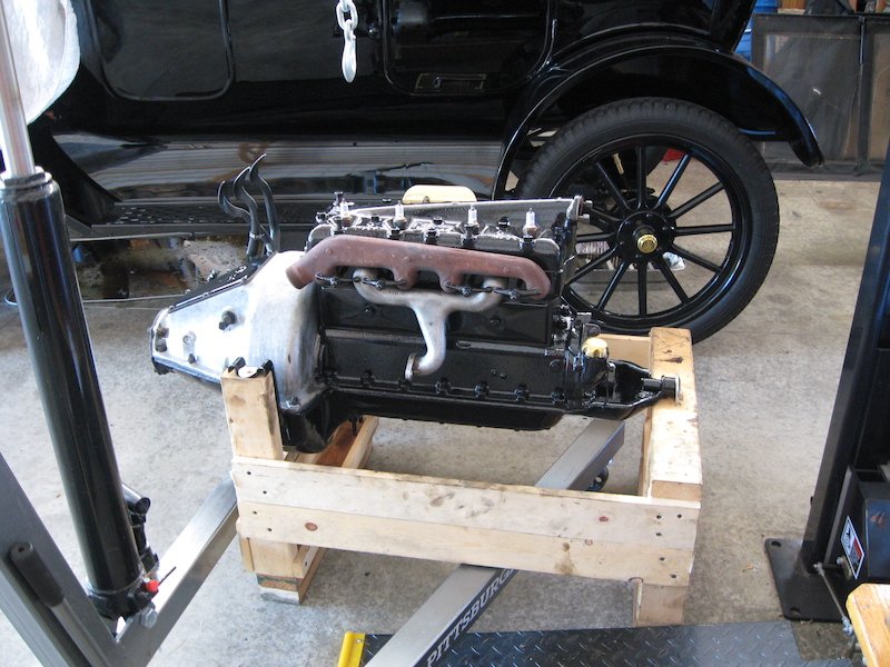

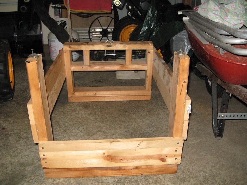

Post by TWrenn » Wed Nov 01, 2023 7:44 pm
Campbell Tellman wrote:
Wed Nov 01, 2023 3:44 pm
I have a 1916 Touring with a 21-22 motor with generator and starter. What does the trans/engine weigh? What would you recommend to carry engine after removal from chassis?
Thanks,
Campbell Tellman II
Beaufort, NC
Something like this works real well for me. Stole the idea/dimensions from Joe Bell!
