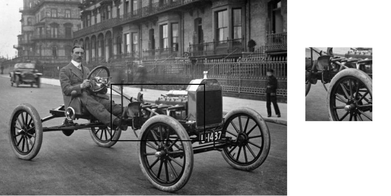

I have been looking at this picture thinking of making a model of this racer and wondering about this one part. Is it a deflector or shield for the exhaust, especially because of the right hand drive? I don't remember seeing it anywhere else

I believe you are correct and it also protects the Stewart speedometer.
You can see the cable running from behind the shield to the right front wheel where the road gear is mounted.
The exhaust pipes appear to be the tapered like the early tail pipe.
Great photograph of an early Ford Model T racer.
