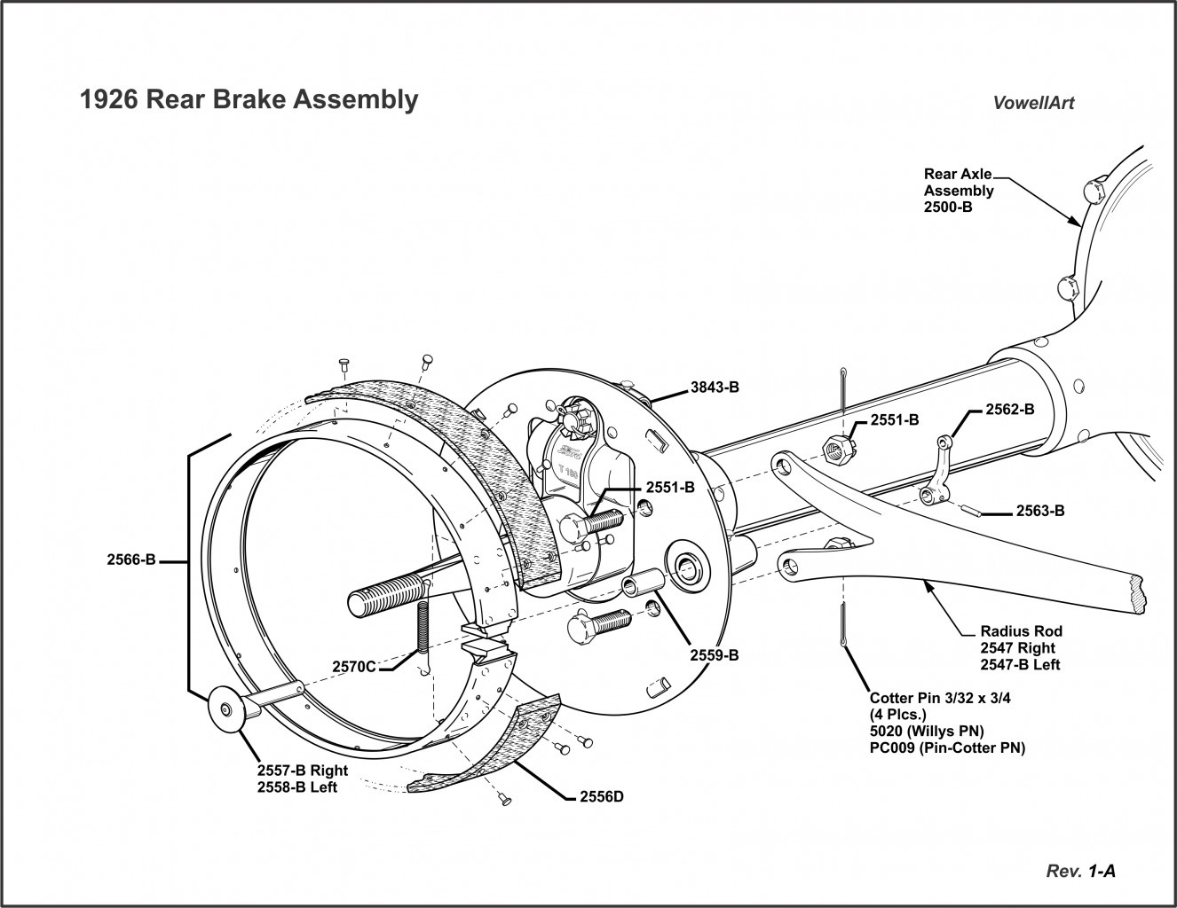

Here are a couple of diagrams. Even though my T is a 1926 coupe, manufactured in March of 1926, mine has the brake style shown in the 1927 diagram. Jim Patrick
