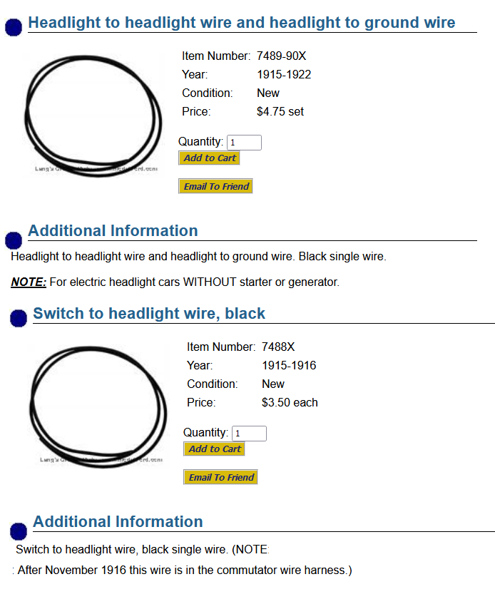

15/16 was a single black wire from the switch to the light, Langs have it listed.

1) Despite an extensive search among the Ford Engineering drawings and documents in the Benson Ford Research Center collections at the Henry Ford, I have found no evidence that fork mounted headlights were ever used in regular US 1915 Model T production. There are photographs of a pre-production Model T 1915 centerdoor sedan showing this style of headlights on the car, but only on a pre-production car. Some have noted that the earliest 1915 Canadian Model T parts catalog shows what appear to be fork mounted head lights, but even these disappear by the time the next Canadian parts catalog is issued. Put them on a car if you want, but don't look to me to establish their authenticity.
2) The early 1915 magneto headlight wiring consisted of four wires. One wire led from the magneto terminal on the coil box to the headlight switch. The second wire ran along side the four wire commutator wiring loom used on 1914 and early 1915 cars from the headlight switch, through the hole in the side of the radiator up to the right angle connection plug. Yes, it was simply an add-on wire. I think it may have been taped to the commutator wiring loom in two places. It was remarkably crude.
The third wire ran from the right side headlight plug back through the hole in the radiator then through a steel tube across the back of the radiator before emerging and passing through the hole in the left side of the radiator. This steel tube was initially soldered to the fins on the back of the radiator. The Ford engineers soon learned that vibration fatigued the fin. or the solder, or both and moved the location of the headlight wire tube to the radiator cross bar. After passing through the tube and the hole in the left side of the radiator the wire was connected to the plug on the left headlight. The last wire ran from the left headlight, back through the hole in the side of the radiator and was grounded by soldering the end of that wire to the radiator cross bar. It was a simple system to say the least.
The insulation on the wires was simply black. The ends of these wires were stripped of their insulation for about 3/8 inch and tinned with solder. Most of the connections for these wires as on the headlight plugs and many of the early headlight switches secured the wires by inserting the wire into a small brass conduit and were locked in place by tightening a small screw. The ground wire leading from the left headlight to the ground on the radiator cross bar had one end stripped for about 1 inch before being tinned and soldered to the radiator cross bar.
Respectfully submitted,
Trent Boggess
Then there are these sources
Kerry
