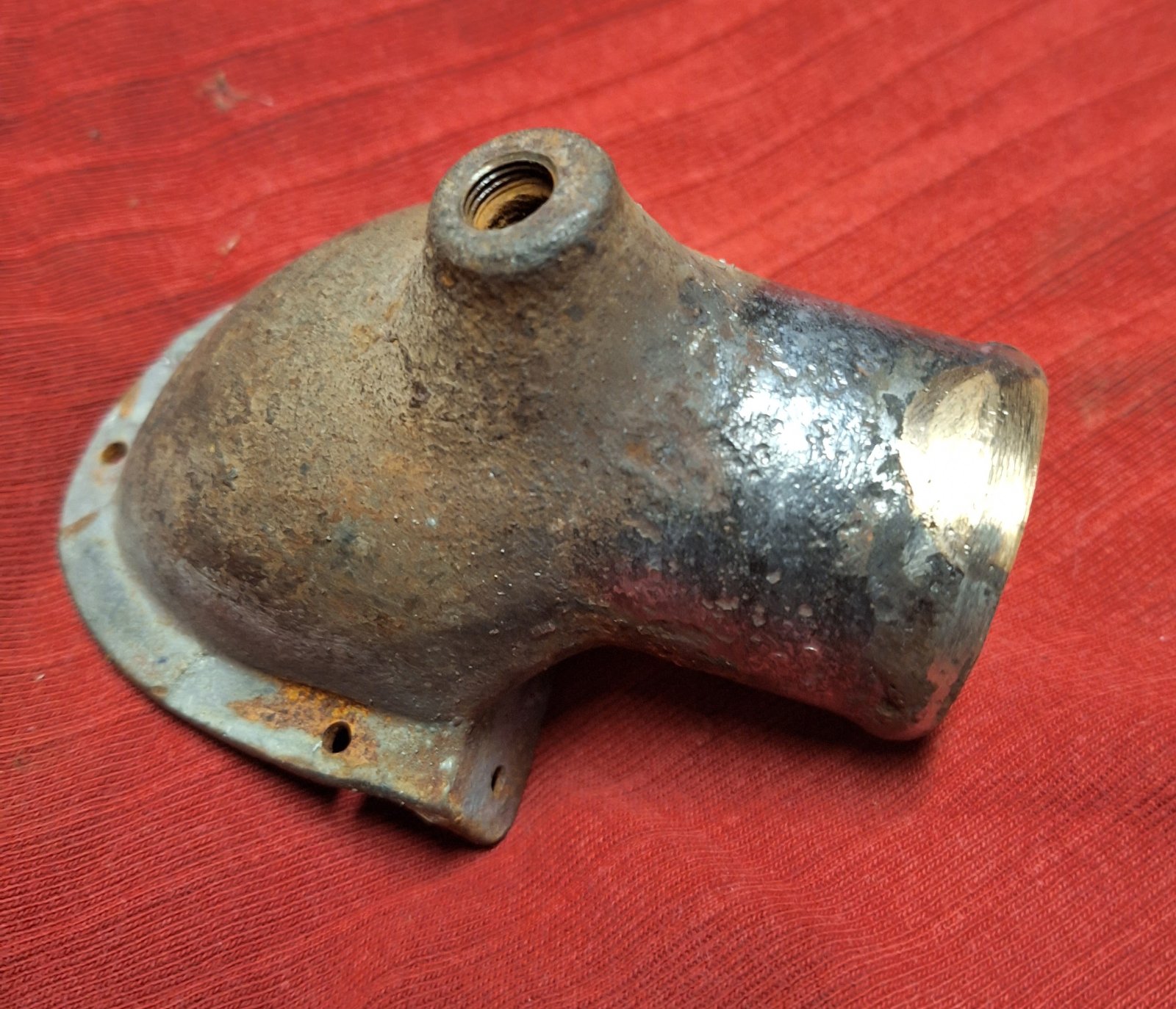

Previously I have used sections of a reverse gear bush to rebuild brass truss rod mountings where the spring leaf hanging from worn shackles wears a groove in the mounting bracket.

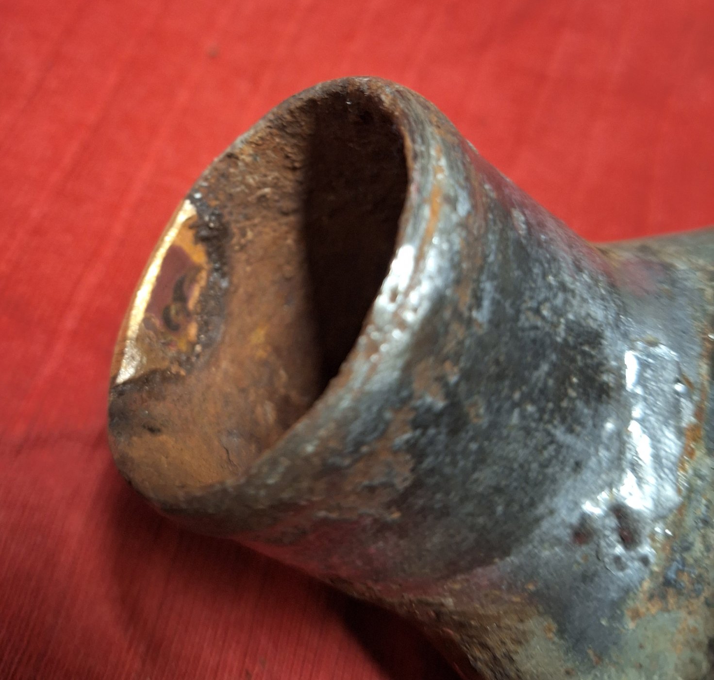

Today I used another piece of the same bush to repair a broken bottom radiator outlet
The piece was shaped and silver soldered in place.
I used to put them in the scrap bin but glad this one hadn't made it.

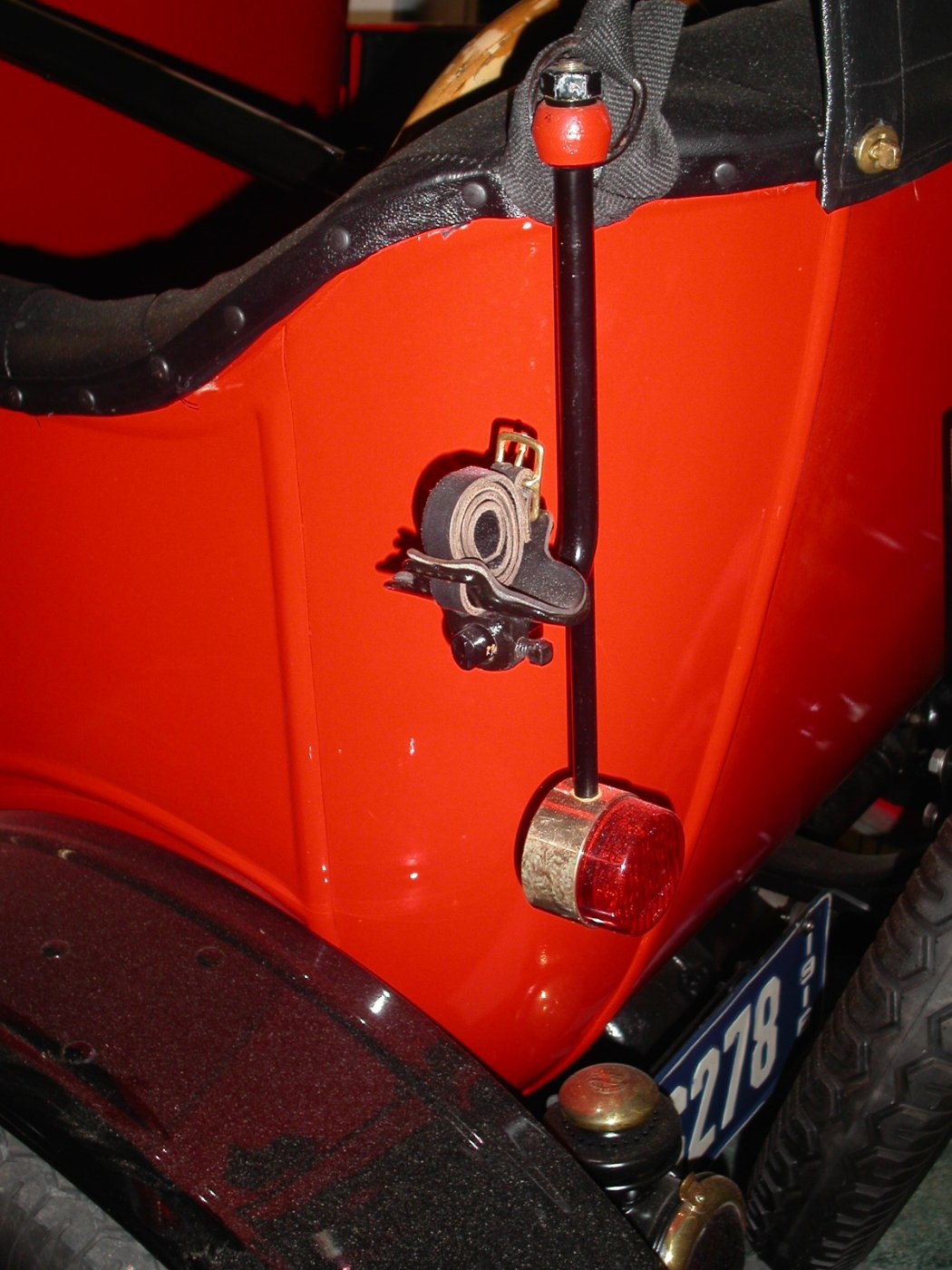

Another use for a reverse bushing. :D

That's really neat Bob. Are there laws governing the height or rear lamps in Washington? Here I could mount those to the top support arms to act as eye level brake lights. I love the red tourer. My 15 tourer was also red, a little more maroon than yours.

I am not aware of any laws concerning tail light height.
The reason that I extended the light below the top cradle
was to make the light visible when the top is folded down.

Post by Allan » Sun Nov 26, 2023 4:25 am
That makes sense.
