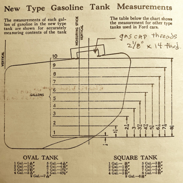

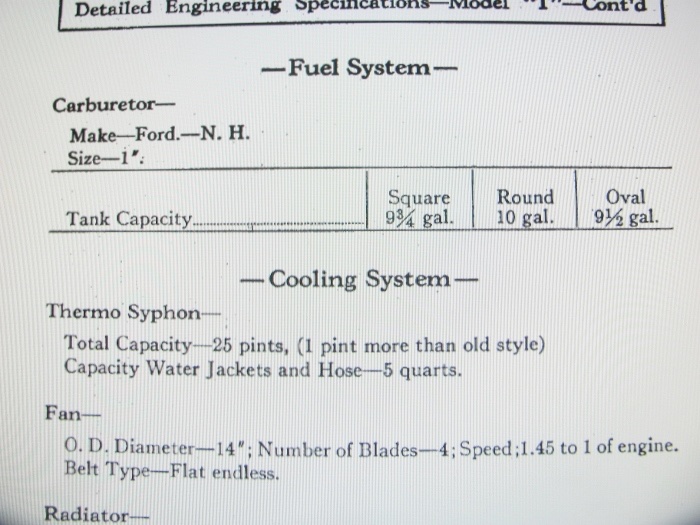

What is the capacity of the fuel tank on a 1927 coupe?
- Posts: 4057
Re: What Is the Capacity of The Fuel Tank ?
Approx. 9 1/2 - 9 3/4 gallons.
Anymore than that it may over spill when using a gas pump nozzle. And place nozzle away from the baffle side or you will get some splash back if the pump is fast flowing

9.75 gallons, and if you fill your tank that far, you'll have a gasoliney mess...
Get one of the tank dip sticks... run your car at 9 gallons...

I fill mine to 8.5 to 9 gallons, except for winter layup.
At this time, I fill it to near the top and add stabilizer.

I’m just guessing but aren’t all Model T gas tanks around 8-9 gallons for an average? An overall average? Maybe if it was in the 9 gallon range it was because in the T era people just didn’t drive as far and it was thought that was an adequate amount for the times. Food for thought!
