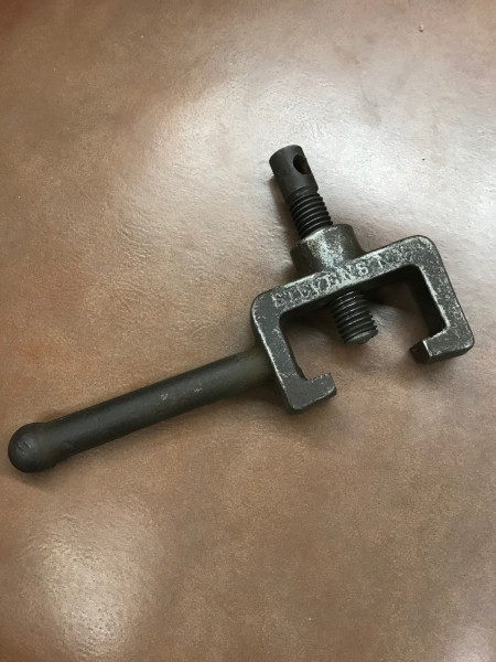

I picked up this puller, which is missing the stand and handle/punch. Could anyone with a good one measure exact dimensions of the punch so that I get it right? Thank you.

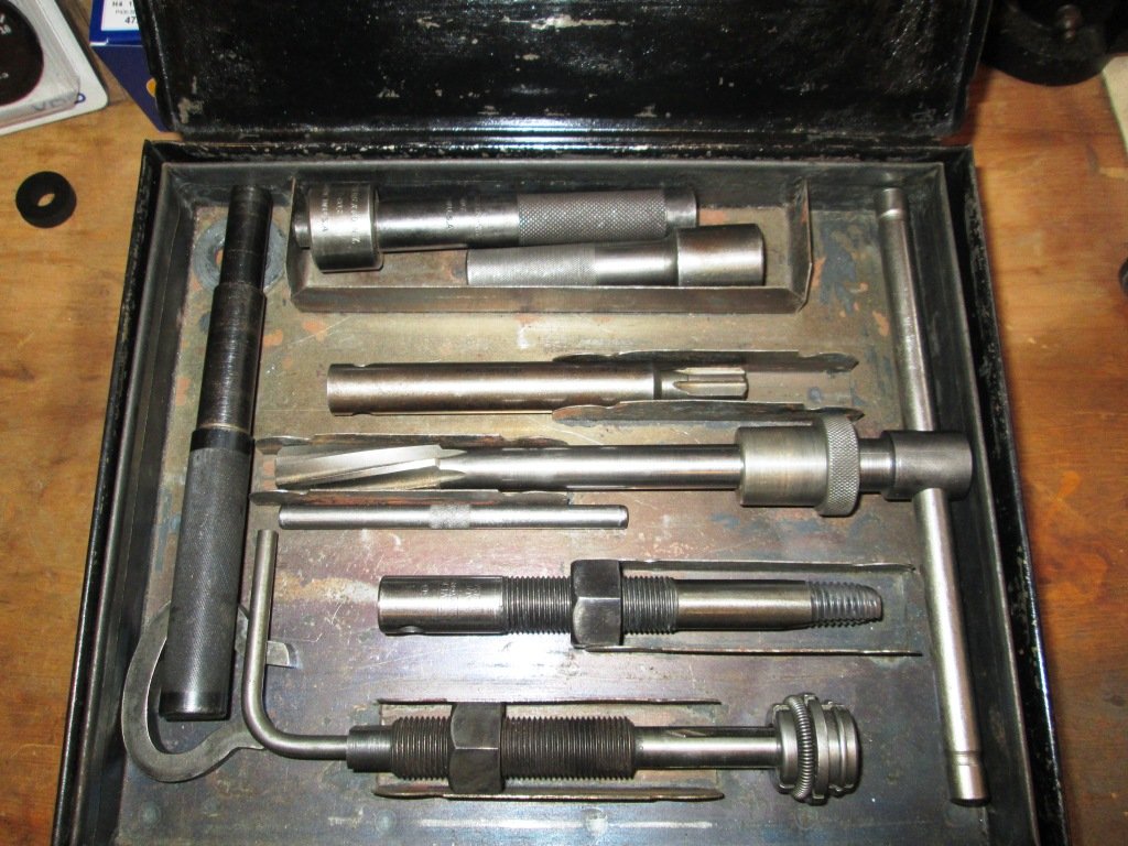

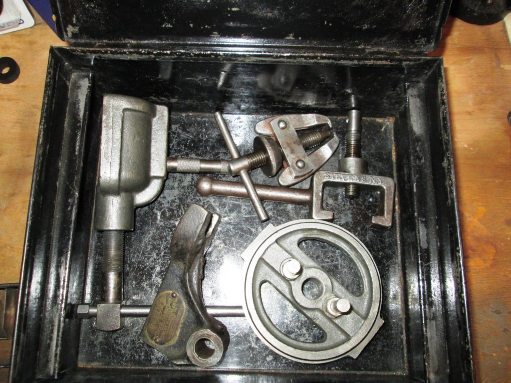

I've been collecting Stevens tools for 30 + years - never have had the pleasure of finding the Stevens stand - I have a copy of the Allen holder. I have the puller & will measure my handle for you.

Thanks! It doesn’t look like there is a handle/punch in the one in the box either! Out of curiosity, what tool has the Hassler arm been turned into?
Posts: 5500
Re: Stevens T-180 Generator Gear Puller
Post by RajoRacer » Fri Dec 08, 2023 10:59 am
The handle's in the top tray - I turned the Hassler arm into a peining jig for the gear pin.
Posts: 5500
Post by RajoRacer » Fri Dec 08, 2023 4:03 pm
Mine measures 0.310 in diameter - 4.50" in length - knurling is 1/2" wide & 2" from either end.

Thanks, that’s interesting. The one in the catalog has a punch for the gear pin built in. Maybe they figured out this was a clumsy setup, or maybe yours lost its original too. My handle hole is 5/16”. There is a square dent like some locknuts have, presumably to create an interference fit for the punch.

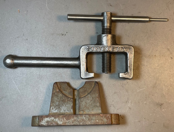

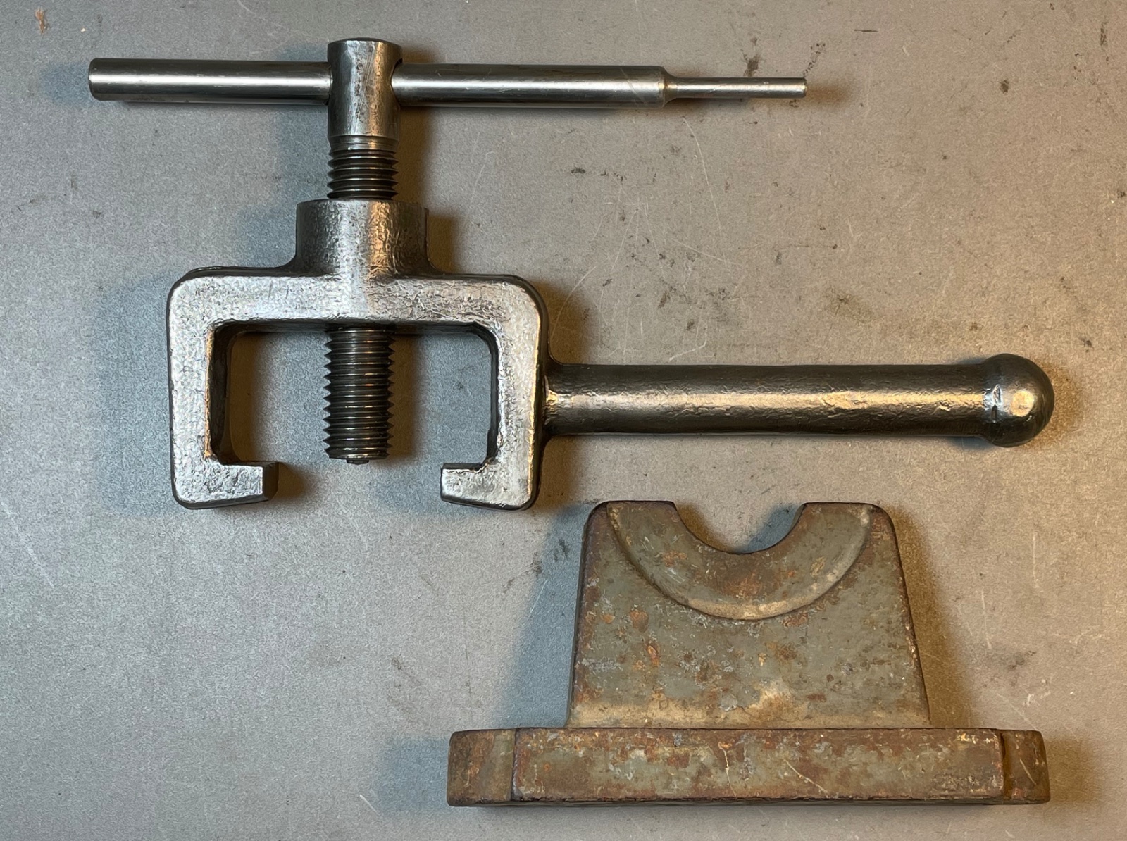

This is a NOS Stevens T-180 I found at Hershey this year:

Wow! Could you give us the two diameters and two lengths?
Posts: 5500
Post by RajoRacer » Fri Dec 08, 2023 8:44 pm
Nice score Trent !!! First Stevens base I've seen.
TrentB
Posts: 218
Joined: Wed Jan 09, 2019 12:19 am
First Name: Trent
Last Name: Boggess
Location: New Hampshire
Post by TrentB » Fri Dec 08, 2023 8:49 pm
Certainly.
The overall length is 5.525 inches.
The major diameter is .328 and is about 4.440 inches long.
The minor diameter is .162 and about 1.112 inches long.
The lengths of the major and minor diameters do not quite add up to 5.525 inches because of the transition from the minor to major diameters.
