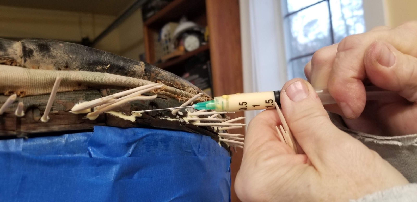

A million toothpicks in the old tack holes…[image][/image]

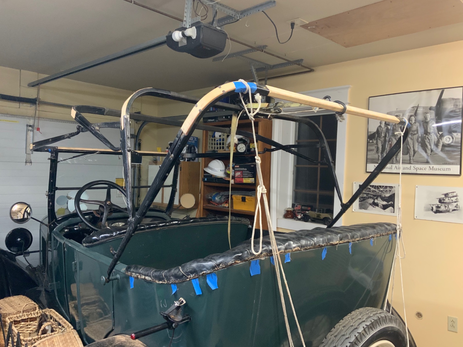

Re: ‘26 Top Irons Header windshield bracket help
This is an early 26 and the top has been on the car for the 15 years that I’ve had it. It did work fine and looked great. It’s just much harder to use than every other 26 that I’ve seen. It’s been on there for a VERY long time judging by the amount of dried mud and dust under the back joints. As much as I would love to put the later irons on, I’m going to continue with what we have. My wife has gotten used to the work involved in using it…
Here’s how she looked:

So long as you’re happy with it, that’s all that matters.
When you order your top kit, make sure you tell the supplier you have ‘23-‘25 top irons on a ‘26-‘27 car and they should be able to produce something that fits reasonably.

If your using Classtique upholstery to buy your top kit from I would send him a picture of your car and top so he can see any differences in your car that’s an early 26. If anybody would know they would. When enlarging your photo of the car it appears the bottom edge of the top has a curve on the bottom edge compared to the factory photos that are shown. Those appear to have a straight bottom edge.

Thanks, John. I did buy the top from them back in the springtime and didn’t mention it at that time. The old top was severely shrunken and getting very hard to use. I’m hoping that the visible curve in the bottom edge in that picture is due to it having shrunk and wasn’t made that way years ago.
