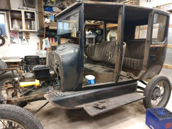

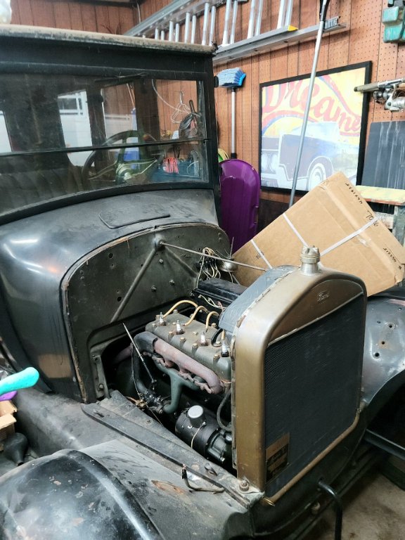

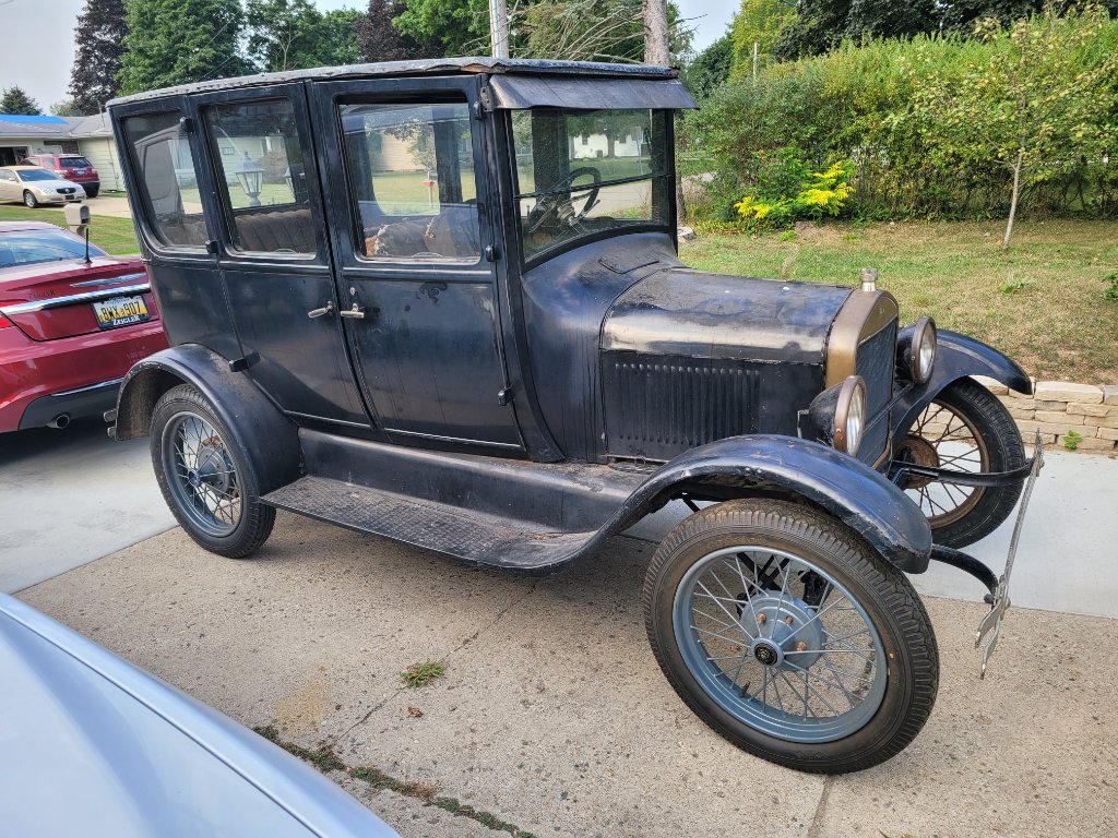

With the mechanical restoration of my '13 Touring nearly done it is time to turn my full attention to the next project, the family '26 Fordor. For those of you who may not be familiar with the car or me, I will give you a very brief introduction to both.

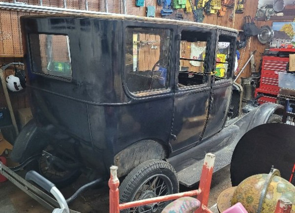

My car was purchased by my father Dave and his brother George as a basket case out of a junkyard in 1952 or 1953. They paid $50 for the car and a family friend towed it home. The car was used for daily transportation by the family and was kept until my dad left home for college in 1956 or so.
My dad stayed in touch with the buyer and bought the car back in about 1970 and it has remained in our family since that time.
My dad used the car daily for several summers until the engine developed a serios knock. With the help of Mark and Phil Eyre, we replaced the incorrect engine in about 1997, performing some mechanical rehabilitation along the way. A Model T enthusiast before this work began the hook was set for me as the work progressed.
I suggested a full restoration of the car at that time but my idea involved securing a Touring body to replace the stodgy Fordor. Dad wouldn't hear of it, suggesting that I buy a Touring of my own if I wanted one. I did so and that car went on to win the 2006 MTFCI Stynowski Award while the Fordor languished.
While on tour two years ago the rear axle began growling and ultimately broke leaving me stranded 20 feet from my trailer.

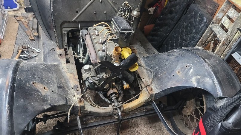

Since then I have been accumulating parts and began the disassembly process three nights ago. Why start it on February 26? It would have been dad's 85th birthday.
Here are a couple photos.

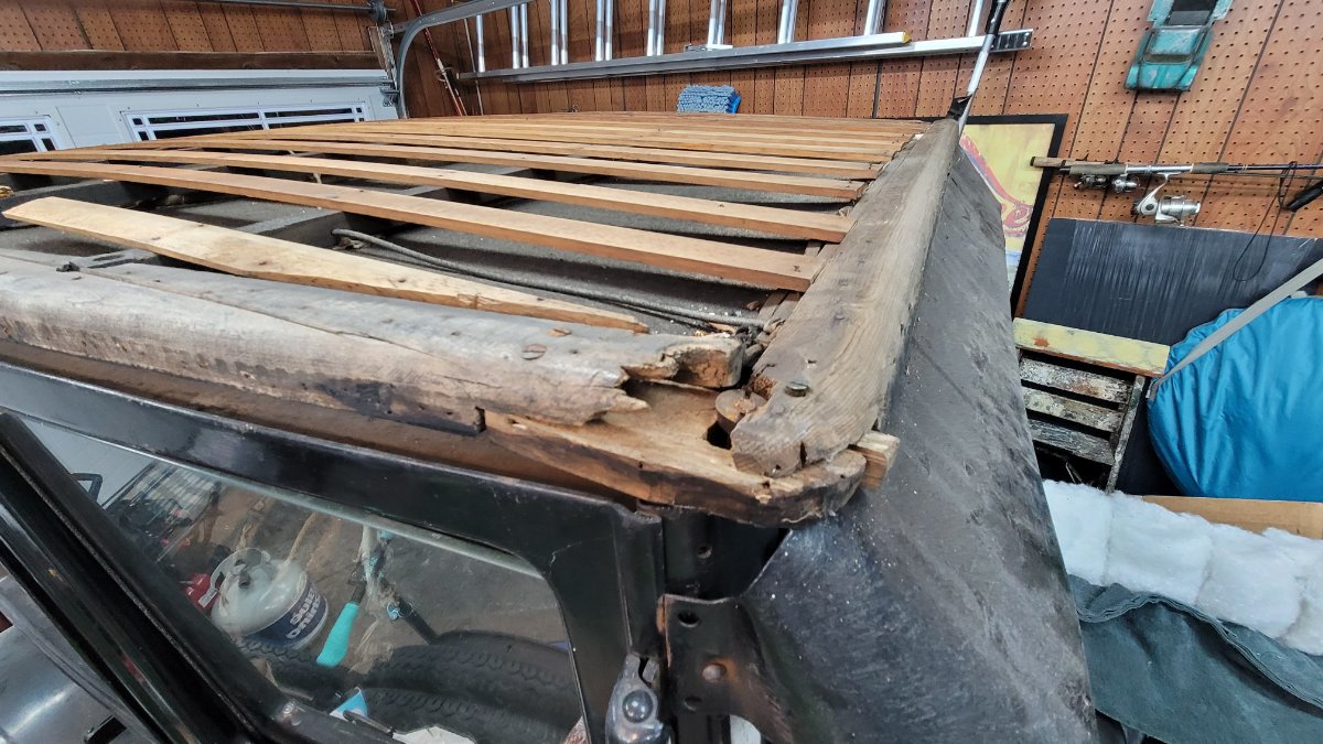

Post by EricMac » Tue Mar 01, 2022 7:14 am

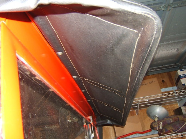

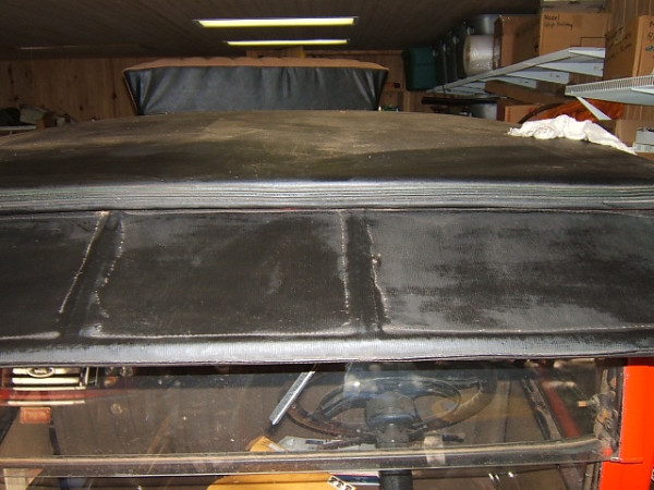

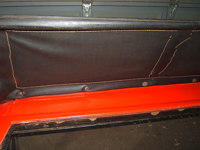

Forum member Don Booth won't be surprised but I was stunned by the extent of the rot evident on the top structure. This photo depicts the first step of the disassembly, removal of the old top covering.

Post by Joe Bell » Tue Mar 01, 2022 7:28 am
Not uncommon years ago a few of us in my area made four sets of wood for a fordor two cars got finished, I kept a set of wood for patterns, evryone got good at making the pieces, when a saw is setup you might as well make some extra's because some one out there will want them someday! Helps pay for your wood on your car.

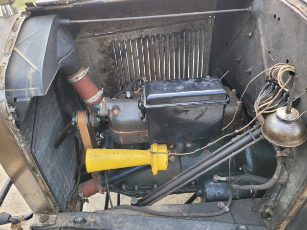

Some people over the years have asked me about the yellow horn. All I can say is dad liked the horn yellow as it matched the yellow of the wood wheels that were on the car for years. If I can find it I have a very old photo of the car as it looked when dad first brought it home. It was sitting on wire wheels that dad incorrectly thought were from a Model A, thus the change back to wires for the car. I'll be posting photos as we go along.

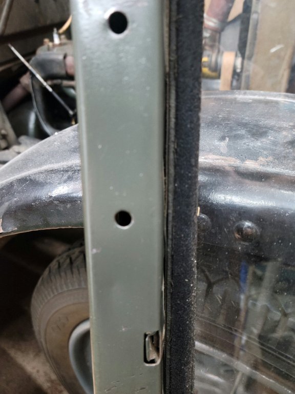

Post by EricMac » Fri Mar 04, 2022 7:11 am
I got nothing done on the Fordor two nights ago but was able to pull one of my daughter's baby teeth, process that took over an hour. Last night I removed the passenger side front door. The top hinge pin was really stubborn but I attribute that to the structural damage of the body thus most of the weight of the door was carried by that hinge alone.
Why that door? First off that was the side easiest to access in the garage and secondly, that window has not worked in at least 50 years so I want to tear into the door to see if I can restore it to functional status.

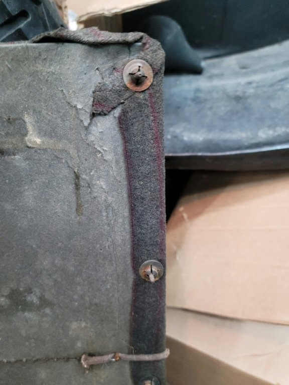

Post by EricMac » Thu Mar 10, 2022 9:11 pm

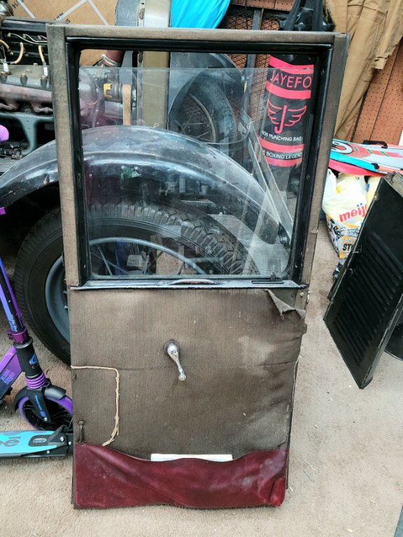

I have the fist of the upholstery off the door. This revealed a lot of original paint (much of it in excellent condition) and the original upholstery color. Tonight I plan to remove the window regulator mechanism to see if I can figure out what has brokenn.

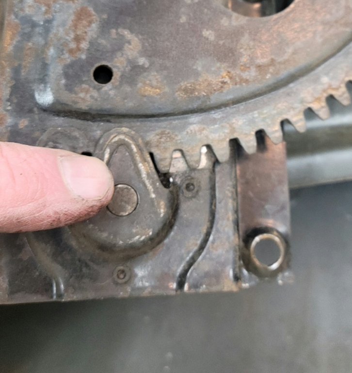

Post by EricMac » Thu Mar 10, 2022 11:17 pm

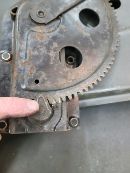

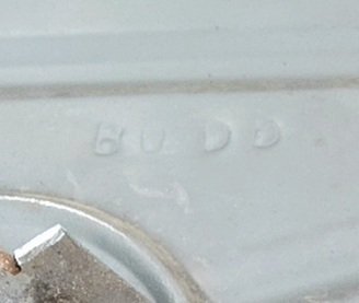

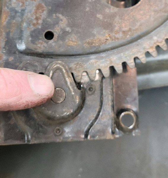

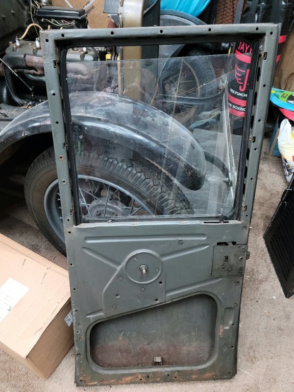

I got the innards of the door apart tonight. After 50 years I figured out what was wrong with the window mechanism. The part of the regulator where my finger is pointing allowed the gear to slip off and the crank no longer worked. A couple firm hits with my ball peen hammer and the mechanism works like new.
On another topic, one can clearly see this was a Budd built body.

Post by John Codman » Fri Mar 11, 2022 11:17 am
When regulators "go off the track" as yours has, the cause is often that the car was left outside in inclement winter weather and snow and ice got inside the door and froze. Instead of waiting for warmer weather or moving the car to an above-freezing location, someone strongarms the window handle.
EricMac

Post by EricMac » Sat Mar 12, 2022 12:23 am
I have no doubt you are right...in fact I remember the day my mom did it...and my dad was passed. Keep in mind this was a 28 year old car my dad bought out of a junkyard. It was abused.

Going back to the wood rot in the front corner, that happen on my Coupe. Do you suppose it's caused by condensation under the fabric at a low point it can travel too? The rest of the wood seems better.

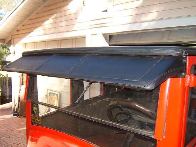

Are you going to get a proper sun visor for it? The one that is on there may have been on it when your Dad bought it, but the correct one is a frame of metal covered with vinyl and sewed around the openings. I have pictures of an original sunvisor on a factory original Fordor if you need me to send them. Jim Patrick
PS. You can’t take too many pictures. Document thoroughly and keep a picture album of all phases of restoration. The one picture you may think you won’t need may be the most important one.
Except for the red color that it was painted with many years ago by a prior owner to preserve the original paint job underneath, I owned this 1926 all factory original Fordor from 2004 until June of 2022 when I sold it. I bought it to restore it, but never got around to it. I’m going to miss it, but it has a good new home with a Model T guy who has started restoring it. I have a lot of pictures of it I took over the years if you need any.

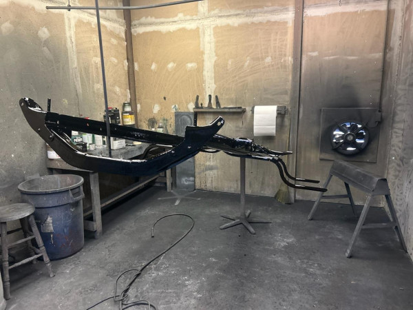

Post by EricMac » Sun Dec 17, 2023 7:30 pm

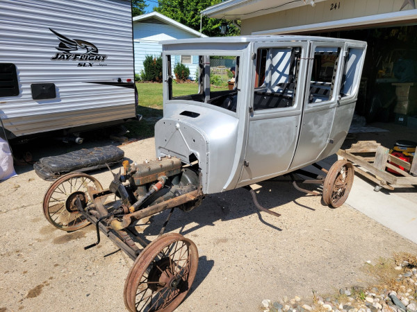

The project continues. While many of you would be well founded if you thought the project had been abandoned. It has not. Currently it is coming back the other way. Don Booth has completed the woodwork on the body and Mark Eyre painted the frame this week. The car is coming along nicely.
