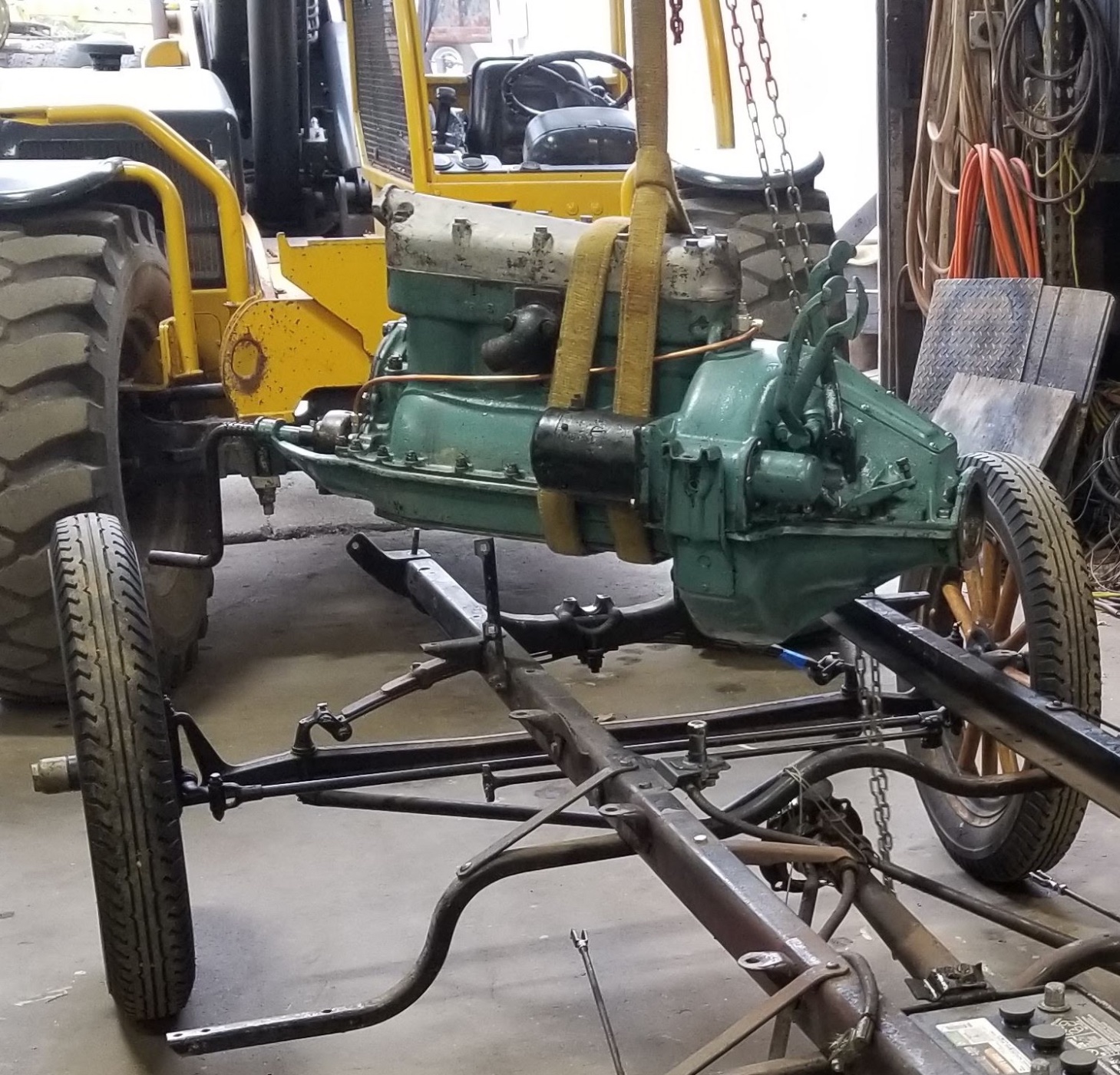

I just use a nylon hoist sling and make a basket loop with it- its adjustable and works just fine. Around the bottom of the pan and pass one end thru the loop and ready to lift. Of course it saves me a trip to my tool box to grab my spark plug with the hoist loop in it. Either way works for me- aluminum or cast iron head.

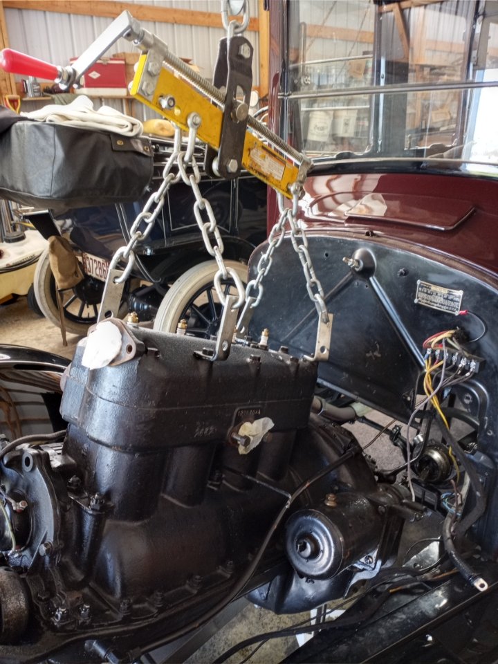

I typically lift my engine with two lifting eyes (Aluminum Z head.) It also allows me to adjust the angle as it is going in or out. I asked the engine rebuilder about the safety of using a lifting eye with a aluminum head and his comment was that it was strong enough to lift the whole car.

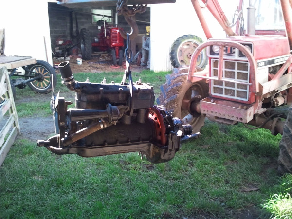

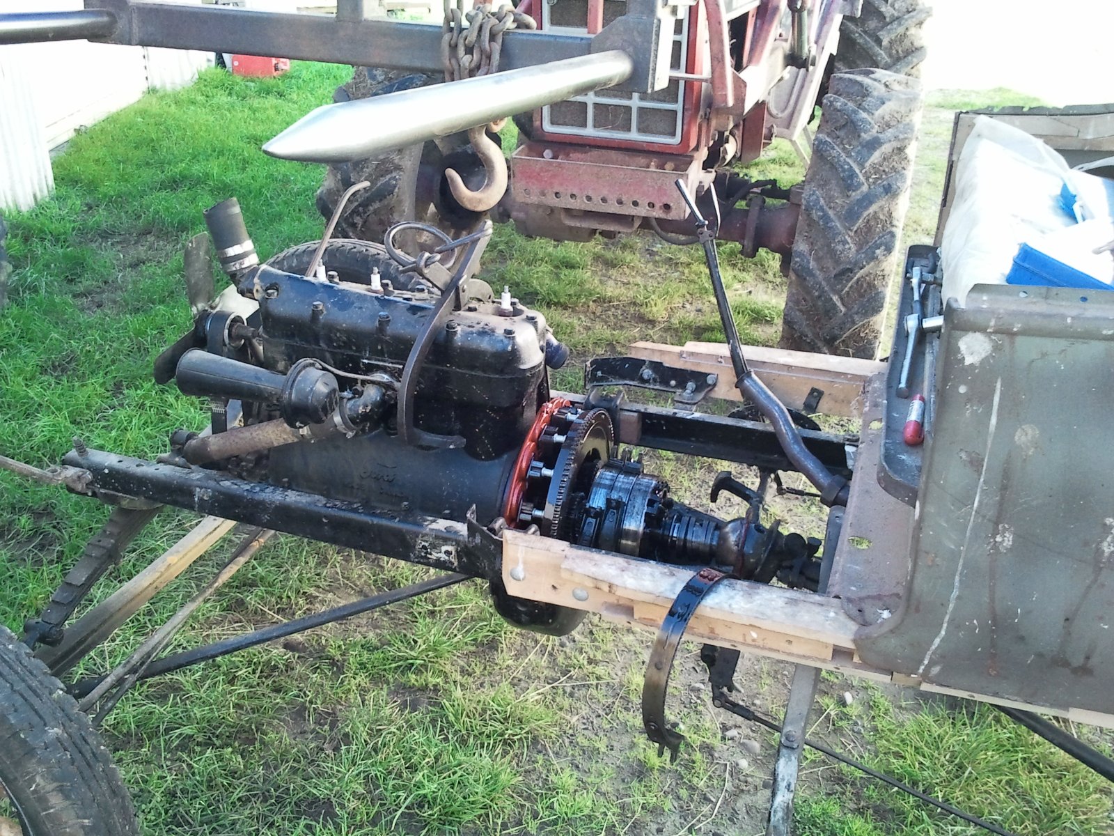

This is one of those "preference things" but here's how my engines go in and out! Bolted into the block witj the handy balancing thing

Twice, I used an "engine cradle" like what Tim Wrenn shows above. Once engine out, later engine in. It worked very well when working by myself.

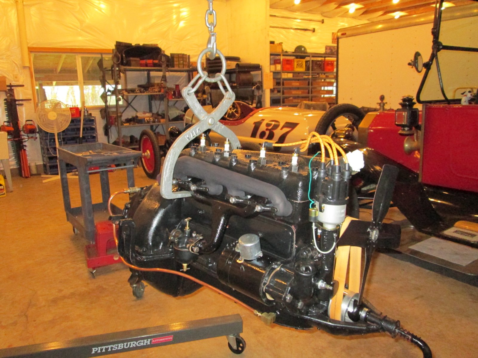

Does anyone else use a clamping system like this? Not sure where it originates from as it was borrowed from a since deceased friend, but seems to work well enough and balanced ok when clamped around number 3 cylinder, but have only used it with firewall removed so could do a straight lift/lower.

Re: Removal of an Engine With an Aluminum Head
The lifting prongs were used on the assembly line in the Ford factory, several old films show them in use and there are lots of old photos of old workshops where you can see them.
The prongs are even in the Ford model T Bible i believe.
They are a very quick way to hoist the engine, but the eyebolts in the plughole are a very safe way to do the job.
Leo van Stirum, Netherlands
- Posts: 5500
KR Wilson was one such producer of engine lifting tongs - best for flat firewall T's with firewall removed but one can reposition to get an angle on them to remove from others.

The easiest way is to just choke a nylon sling under the oil pan and cinch it between #3 and #4. If you need more tilt, move it closer to #3.
