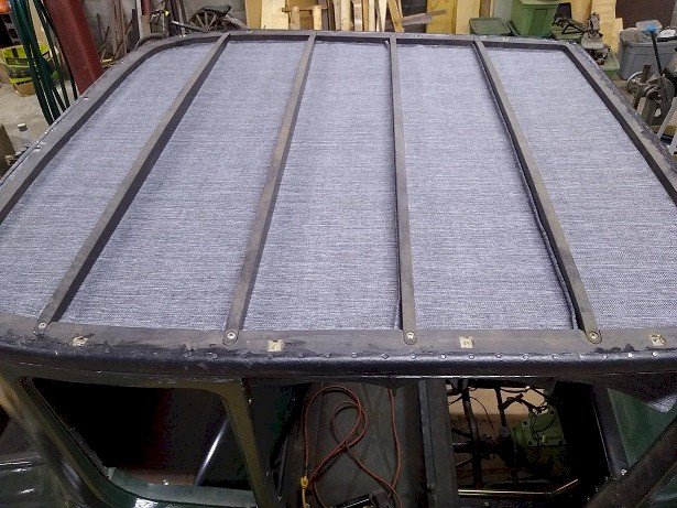

We bought grey "duck" cloth, sewed in green lines, upholstered the seat back & lower. Used the same grey for the top, sewing in folds and stapled to the cross members, then stretched to the outside edge. Used same staples to attach to the corner. Patch panels will cover the corner staples.
(I had already tacked some vinyl around the outside edge of the top wood, tucked it under, tacked it. Then ran a bead of black sealant on the sill and bolted it down. My mistake.)
I have more of the same grey duck cloth for panels. The body is missing most of the inserts which the panels attach to. I have seen all kinds of snaps and nails from the vendors and don't know what to use. (Late 26 Coupe) some of the panels must attach to wood while other parts to metal.
Vern (Vieux Carre)

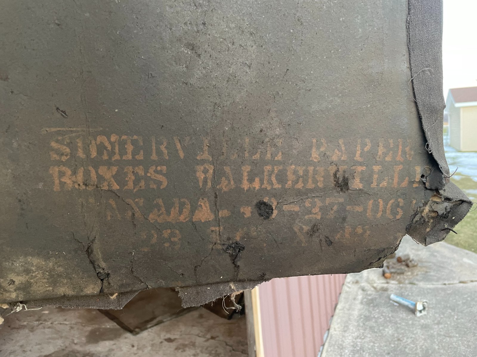

Re: Original material to back interior cloth?
Post by Paperman » Thu Dec 28, 2023 1:56 pm
This was printed on the original panels of my 27.
