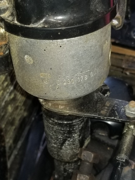

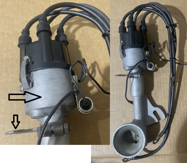

You may have a distributor because of magneto issues or that it was removed.

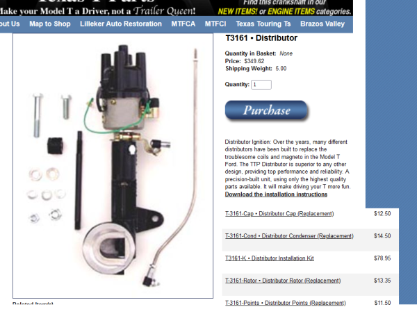

You need to properly identify the distributor. The "original" American Bosch, included centrifugal advance, and require the period replacement parts. Original 009 VW Robert Bosch distributors became a popular modification but required advance curve changes. AND some of these were available for purchase. Texas T now sells a 009 knock off modified for the Model T.
You can see the differences in these two - the first appears to be marked as a VW, as Craig noted. Also has the same lever for the commutator rod as yours
The current Texas T's version.
nstallation instructions should be close enough for either
Texas T instr.pdf
(1022.68 KiB) Downloaded 84 times

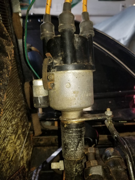

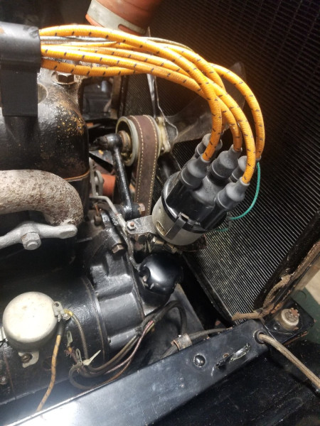

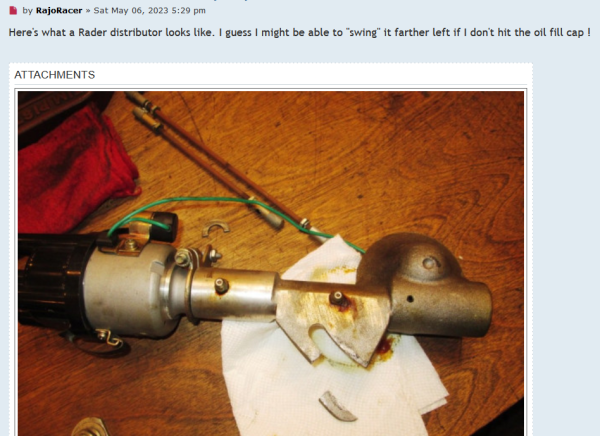

It appears that distributor set-up could be a Bill Rader item due to the bell crank for the spark lead arms.

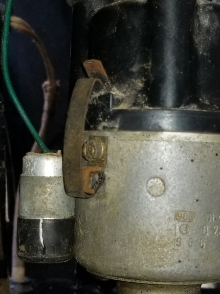

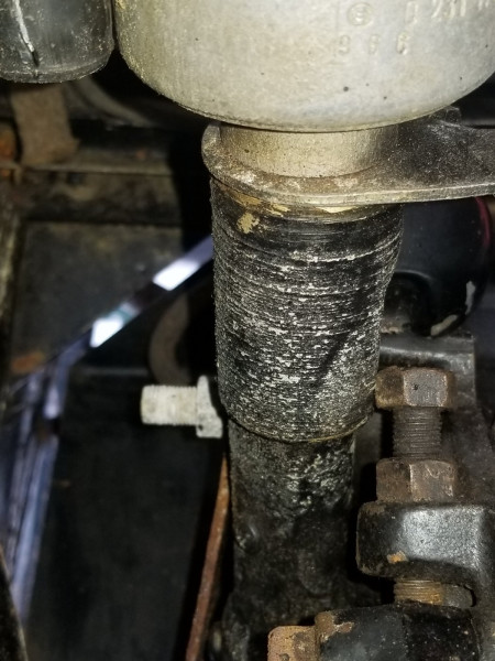

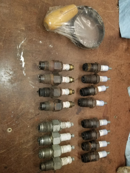

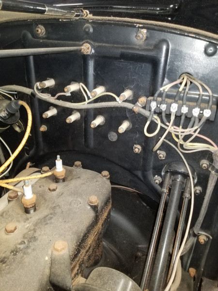

Here's more pics of what I have. Seems just the plugs are not attached. The inside of the dizzy is spotless.. Wires look new.

Distributor is a Hella, which is VW(?)
I'd use the original ignition system. It appears that you have most or all of it.
It offers reliability, easy starting, period correctness, and free starts.
If your magneto is inoperative, I suggest repairing it. The original ignition system with battery and magneto is hard to beat, and it can be easily equipped to charge a small 12 volt battery for modern conveniences like a cell phone and a Garmin device.

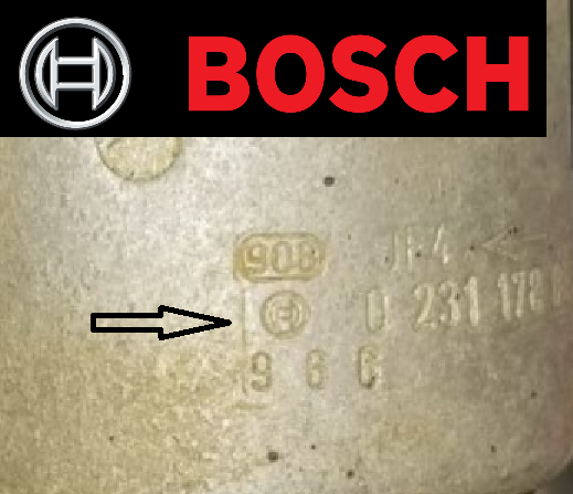

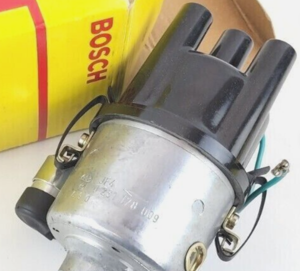

The distributor is a Bosch 009 , used on VW's BUT likely an original vs repro or new oem
These had centrifugal advance and if it is
bosch logo.png (159.85 KiB) Viewed 4591 times
Distributors were period correct items as were external magnetos, mostly used for racing,.

Trademark misled me. I thought the "H" mark was Hella.

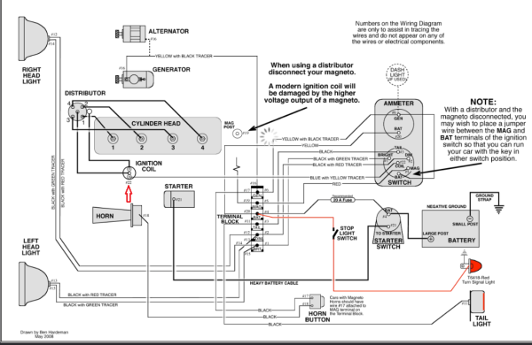

If I was installing a coil and distributor from scratch, does anyone have written instructions on how to do so? Just so I can see if the PO installed them correctly.

vping wrote:
Wed Jan 31, 2024 5:43 pm
Here does 6v & 12V instructions
Not sure what you have but they are pretty much the same.
Texas T instr.pdf
(1022.68 KiB) Downloaded 53 times
Ralph Reeder.jpeg (67.73 KiB) Viewed 4162 times
Focus on the wires to the coil the + - that's the important part

go to www.texastparts.com and click on ignition system, then click on distributor, and you will find the instructions (6 pages)
