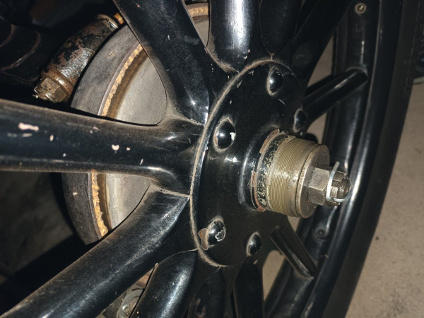

Greetings everyone,
on my car, on the rear axle there is a washer on each side between the axle shaft nut and the rear wheel hub. I had always assumed they belong there, however I can't find any reference to them in the service manual and I haven't found anything searching the forums.
Without them, hub and nut would be too far inboard for the cotter pin hole and the castle nut to line up, so my fear is someone put them on to mask worn hubs / axle shafts...
Do you think I'm on the right track with that thought? Or maybe I'm overthinking things...?

Yes you correctly identified what is going on. If the hub is tight on the axle and there is no rubbing on the inside of the hub or brake drum you are fine, there is no problem to be concerned about.

Looks like some sort of external accessory brake also, so maybe it was needed for that? Otherwise, if the hub/axle was or is that worn I'm betting there's almost gotta be a shim in there too.

The wheels turn freely, no rubbing that I am aware of, and the stock handbrake works well. And yes, the car has a "Stronghold" auxiliary brake, which was apparently sold by Montgomery Ward and is very similar to the AC brakes. I guess it's possible that someone modified the hub to install those.

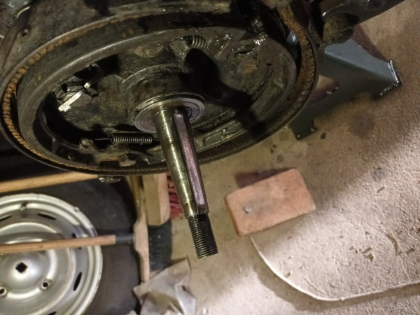

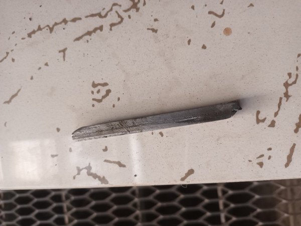

Ok, I finally got around to taking the wheel off... first of all, no shims in there! But, the key was put in the wrong way:
So, I suppose it is time for new hubs? Also, I'm kind of concerned about the axle shafts. With the key deformed that way, it must have put a lot of pressure on the axle...
deformed key:

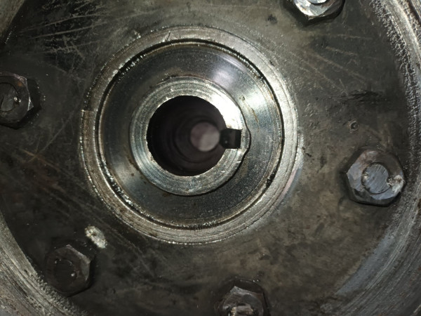

I suppose that was what spread and cracked the hub:

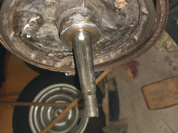

tapered portion of the the axle shaft.... looks... kind of ok I think..?
I don't have the axle book yet, but found a drawing that states the diameter of the axle shaft before the threaded part begins at 3/4". I measured it and found it to be 0.03 undersize. The taper is even, without worn spots as far as I can tell.So, I suppose it is time for new hubs? Also, I'm kind of concerned about the axle shafts. With the key deformed that way, it must have put a lot of pressure on the axle...

Well the key is definitely junk. That's the easy part. Re the hub crack, unless I'm missing something, I can't see a crack in the picture. But the keyWAY in the hub looks to be "spread open" somewhat, making it junk. And if the keyway on the axle allows the key to "floppity flop" the least little bit, so is that axle. I subscribe to an age old axiom: "When in doubt, throw it out". Just an opinion, you'll get far more from here and maybe even better thoughts and ideas and expertise than me.

Tim, there are two hairline cracks in the raised center part of the hub, going out from the square corners of the keyway at 45 degree angles. Concerning your comment about the axles, that is pretty much what I've been thinking... but, I don't have any experience with rebuilding rear axles. So, I fear I'l need to get some outside help for that...

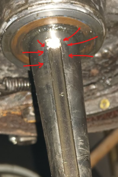

I'm less inclined to think that the axles are junk. I do however question the lines/marks I'm seeing in the one photo. These areas are the classic spots for cracks to occur. Look very carefully in these areas. Also, as others have mentioned, be sure that the keys still seat reasonably well in the axle keyways.
The small cracks in the hub do not worry me. They are likely only present at the end of the taper, where the improperly installed key stretched the end of the keyway out. If everything is installed correctly, that area should see little stress and the cracks should not propagate. That said, the keyway also looks stretched open. If that's the case all the way through the hub, then yes, it's junk... Also, you have to check for a worn taper, also meaning it's junk.

That is what I'm planning to do - I haven't had the other rear wheel off yet, can't access it the way the car is parked now - but I suppose it will be the same or similar since it has the same washer under the nut. And since it looks like I'll have to disassemble the whole thing, I won't cut any corners & do it right the first time, so that I won't have to worry about it in the future. Concerning babbitt thrust washers - the last owner assured me that the rear axle had been gone over and the thrust washers replaced. That was one of the reasons why I hadn't bothered to take a closer look at the rear axle before. I should have known better...Frank don't let rebuilding..actually it's replacing..the rear axles dissuade you. Do note I used plural. Do them both while you have the rear end all apart.
The axle book is on its way. In the meantime, searching the forum has turned up lots rear end threads. Lots of good info, including a handy parts checklist.
Wow, you have good eyes! At the position you marked, the keyway in the axle is indeed spread open by 0.015. The rest measures at 1/4".The small cracks in the hub do not worry me. They are likely only present at the end of the taper, where the improperly installed key stretched the end of the keyway out. If everything is installed correctly, that area should see little stress and the cracks should not propagate. That said, the keyway also looks stretched open. If that's the case all the way through the hub, then yes, it's junk... Also, you have to check for a worn taper, also meaning it's junk.
