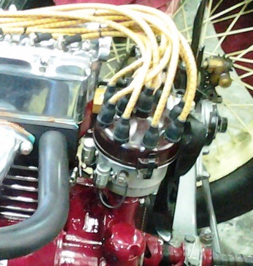

Trying to help a friend find a suitable distributor for his dual spark 4 cylinder engine. I have a cap that was used on 1929 Graham, 1929 Kissel and 1928-29 Studebaker. This cap was also used on dual spark model T Fords with Rajo and Frontenc and other speed heads. Question is, what Delco distributor did they use? He can modify the cam to 4 cylinder and I have several twin 4 rotors.

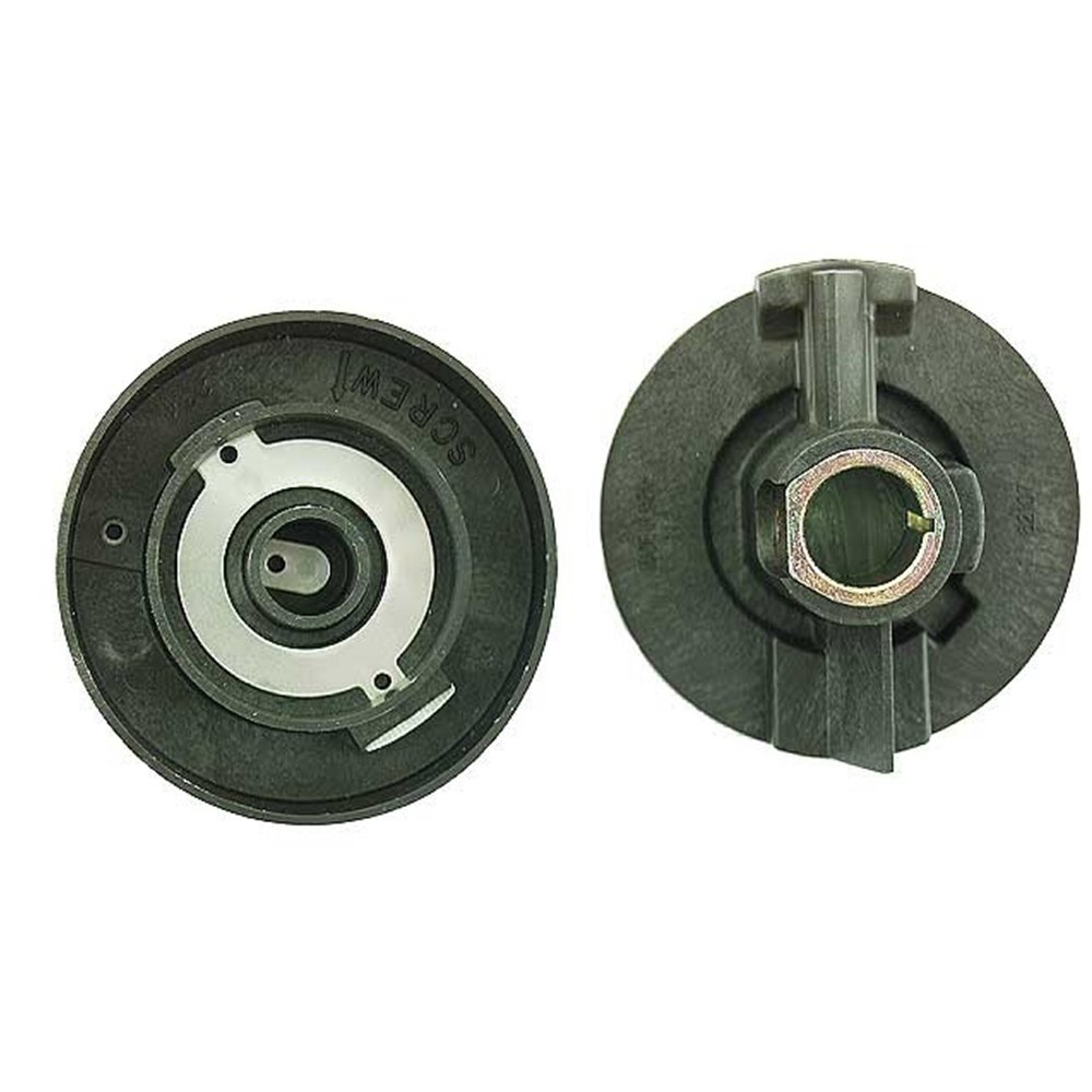

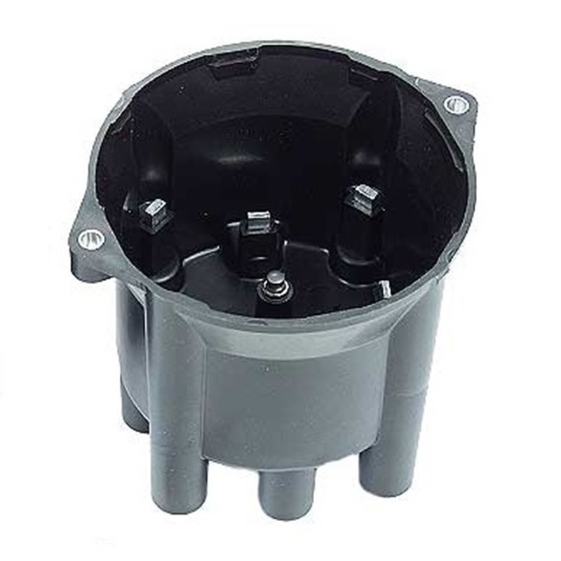

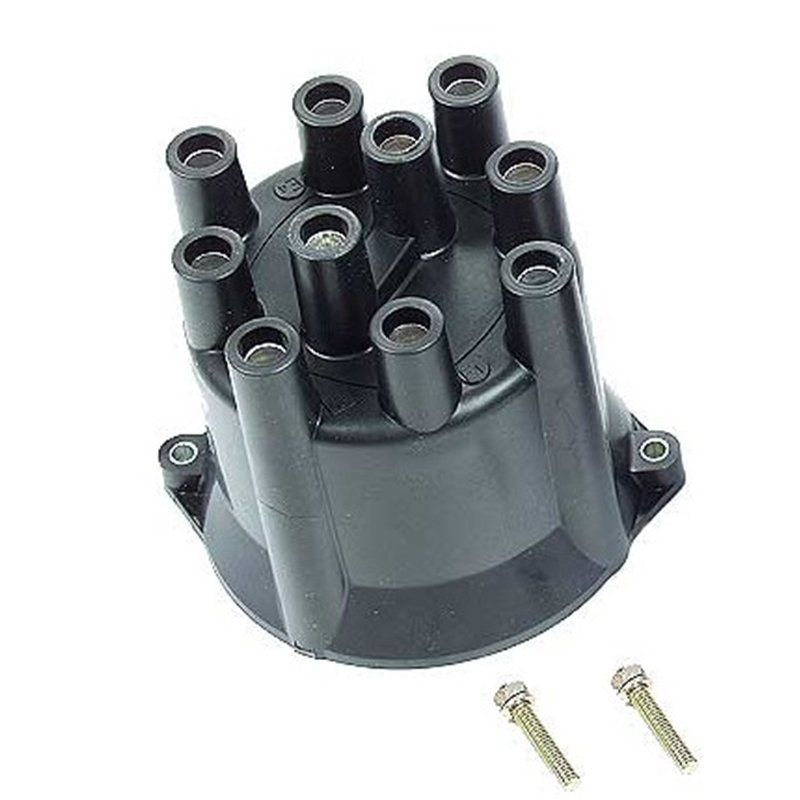

A place to buy cap & rotor https://www.partsklassik.com/p-2265-dis ... -plug.aspx
same as Nissan I believe
Distributor Cap 4cyl Twin Plug
Our Price: $18.56
Please start by selecting your Vehicle above. If you know our part number please select from options below.
8-Plug Distributor Cap
This is an aftermarket cap for twin plug conversions to 4 cylinder engines in 912 and 356 and Polo Motors.
Aftermarket
Our founders have worked on Porsche cars for decades. They've tried most of our aftermarket products first hand on real cars. Some parts are no longer made by an O.E.M company, or the price difference between genuine and aftermarket has become so large that it makes sense to take the savings. If you have any questions about an aftermarket product, please contact us.
