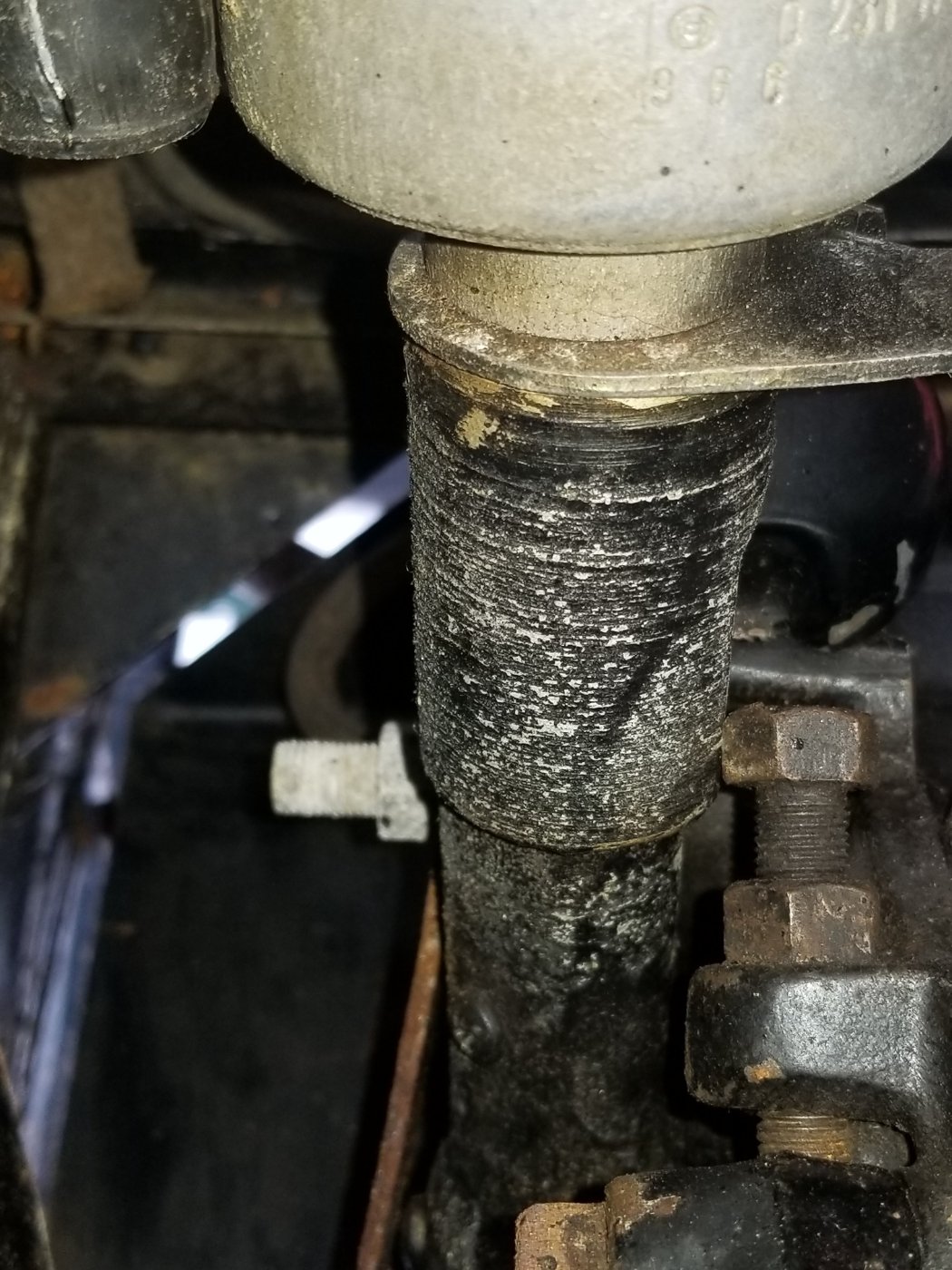

Hi Vincent,
Allan has a point on some dizzies you just can't see the gears. If the dizzy is not set up with centrifugal advance you can get a pretty good feel
for the gear mesh by turning the distributer shaft with your fingers. If you can't see or feel the mesh, turn the engine to TDC & mark the pulley
& rotor possission. Remove the dizzy put some gear marking compound on the cam & dizzy gear, install, turn the engine over 2 revolutions,
remove and check the mesh the install when satisfied, Don't forget the dizzy needs lubed regularly to give good long service. The Dizzy you
have there looks like a Bosch 009. That is the most common to get parts for but have spares with you. Most don't know the rotor has a noise
supresion resistor in it. And they go bad, they will drive you nuts because the appear to be good when testing & fail when driving. Keep 2 in
the tool box. It is the easyest thing to change & then you have one for the next guy. Don't leave home with out them. There are several models
of Bosch dizzies that the parts look alike & fit. But are not the same & will give poor performance or even damage each other. I have never
even had a complete Ford ignition system & have nothing against them but do prefer period dizzies like Thomas, Atwater-Kent & American
Bosch that way I still have 100 year old parts to give me a bad time just like you guys that run coils & timers do.

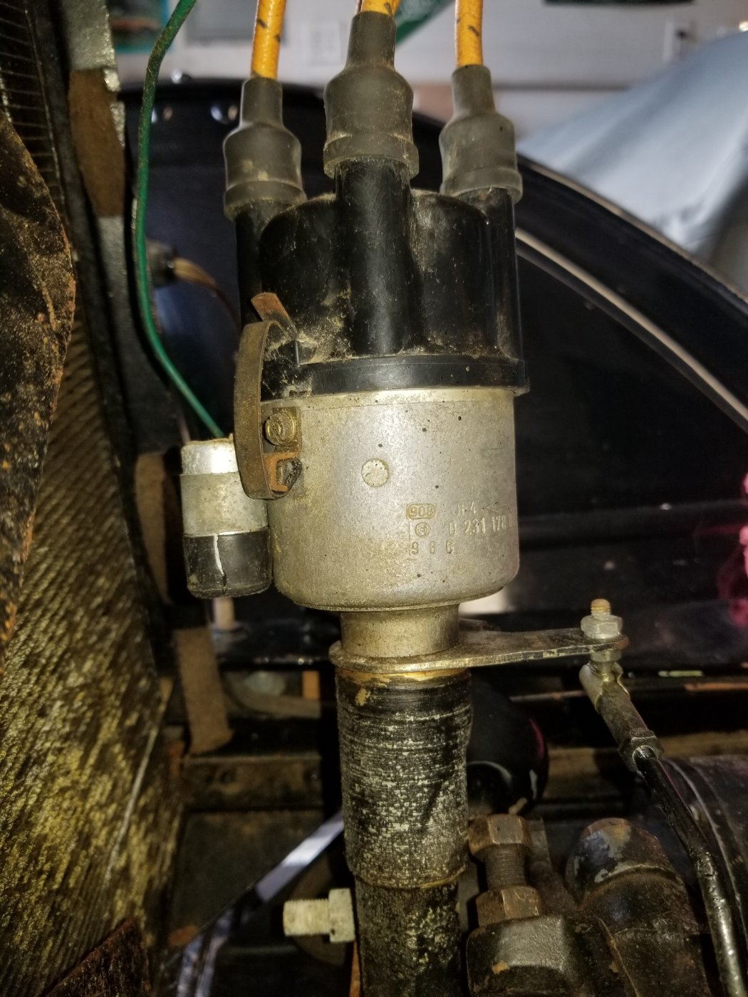

You may have a distributor because of magneto issues or that it was removed.
You need to properly identify the distributor. The "original" American Bosch, included centrifugal advance, and require the period replacement parts. Original 009 VW Robert Bosch distributors became a popular modification but required advance curve changes. AND some of these were available for purchase. Texas T now sells a 009 knock off modified for the Model T.
You can see the differences in these two - the first appears to be marked as a VW, as Craig noted. Also has the same lever for the commutator rod as yours --
The current Texas T's version.
nstallation instructions should be close enough for either

It appears that distributor set-up could be a Bill Rader item due to the bell crank for the spark lead arms.

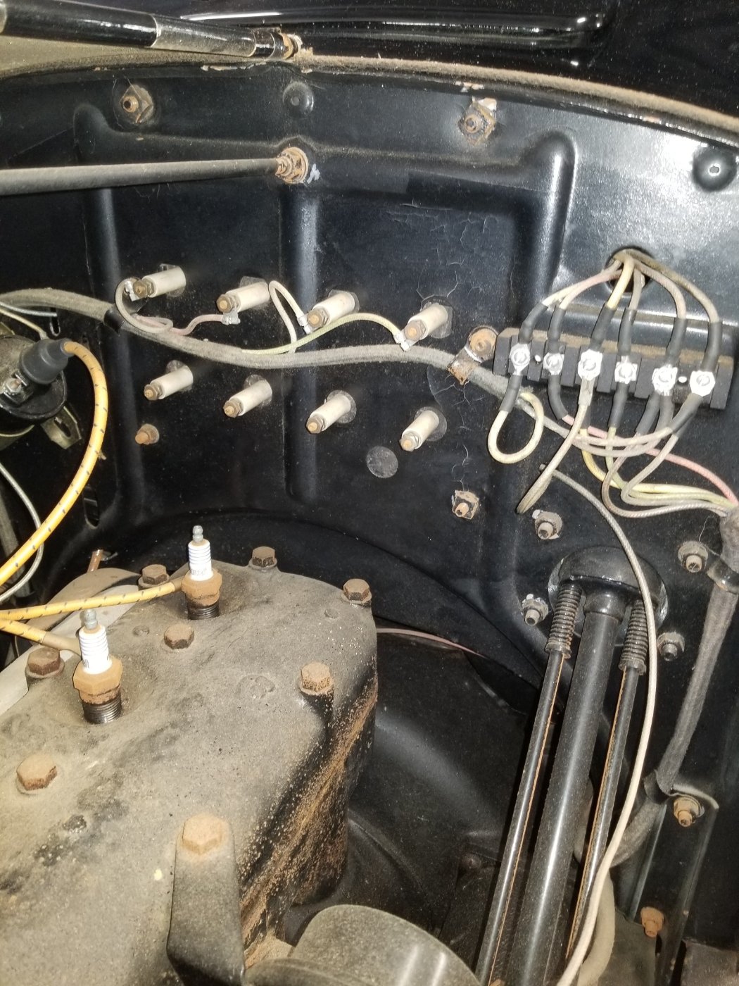

Here's more pics of what I have. Seems just the plugs are not attached. The inside of the dizzy is spotless.. Wires look new.

I prefer stock Ford ignition over a distributor. It’s tough to beat the redundancy of a timer and coils.
If you’re out driving and your mag gives up, you can switch to battery to get you home. If a coil stops working you can quickly swap in a spare or limp home on three cylinders.
Timers do wear out and can cause rough running or a misfire, but a worn out timer can still get you home. I suppose a timer could fail completely but it’s highly unlikely. A spare timer and roller are easy to carry and swap out.
One of my T’s has a non working magneto. I’ve been running the coils off of a 12 volt battery for years and it runs great.
Not passing judgement on those who run a distributor, just my thoughts and experience.

Distributor is a Hella, which is VW(?)
I'd use the original ignition system. It appears that you have most or all of it.
It offers reliability, easy starting, period correctness, and free starts.
If your magneto is inoperative, I suggest repairing it. The original ignition system with battery and magneto is hard to beat, and it can be easily equipped to charge a small 12 volt battery for modern conveniences like a cell phone and a Garmin device.

The distributor is a Bosch 009 , used on VW's BUT likely an original vs repro or new oem
These had centrifugal advance and if it is -- ---
Distributors were period correct items as were external magnetos, mostly used for racing,.
Cost considerations VW parts available at any Auto parts Stores - Model T parts at selected suppliers

I like the idea of having the original parts. Deep down, I'm a purist but.....I also do like performance and upgrades when they are better than the original.
Since the distributor is already hooked up, I'll try and get it running as is.
Once I do get it running, I can start to look into the parts I have and eventually switch it back to the original boxes and timer.
I have the carb removed to free up some gunk at the shut off valve and I'm cleaning out the gas line. The inside of the carb is bone dry and no signs of varnish. The only thing I don't know is how far that center pin (needle?) needs to be screwed in. I unscrewed it before I knew to make note of where it was.
Now I'm off to see how to test a magneto and make sure it works still. It's hard to push the car around so I assume it's the magneto. Might have nothing to do with it.

I understand what Craig was trying to convey with his description of how to check the gear mesh on a distributor. What I can't get my head around is if you find it out somewhat, what can you do to fix/change it?
I suppose the cam gear can be shimmed in or out, but does that alter the out of mesh? Making sure the timing cover is properly centred might also alter the mesh if it is out. Otherwise it is a fit-it-and-hope situation.

Hi Allan,
Dizzy's have somewhere between 12 & 16 teeth on the drive gear which is from 22.5 - 30 degrees of rotation. With the possible rotation of the
dizzy, linkage & adjustable arms (on some) it is just a matter of moving it one tooth if it's just a little out. I always center the timing cover.

Craig, you missed the point. Your solution resets the timing. It does nothing about the mesh of the gears. I have seen so many sets of badly worn/out of mesh gears on old distributor conversions but can see no way of improving the mesh.

Sorry Allan,
The term out somewhat threw me. If the gears are worn out there is not much can be done, but it doesn't take much to drive a dizzy if its in good shape bushing wise. the only friction is the points rubbing on the block. I have seen gears that had run a long time with only half the tooth depth
engaged because of a miss aligned cover or something. Bosch dizzies have a thin drive gear that does have to be spaced correctly to get a good
mesh. most of those have a plug that comes out the bottom so you can see the gears. When you look at some of the dizzies they are driven only
by the roller pin so there cant be to much load on the gears.
