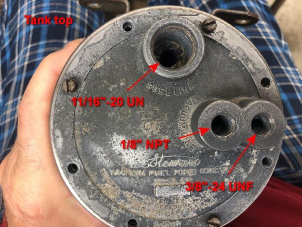

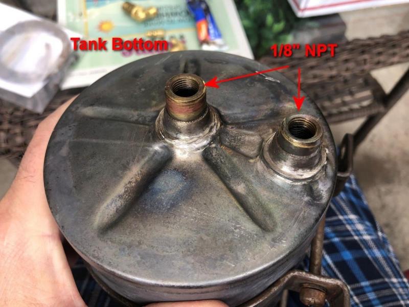

I'm helping a friend with his Stewart vacuum fuel pump. I cant find the right size fitting for the fuel inlet. Anything I try is either to big or to small. All the other holes are 1/8 and 3/8. But the fuel port is an odd size. Anyone know what size it is and where I can find it? Thank you.

These photos might help, they have the thread size for fittings. Don't know where you obtain any.

They actually used a couple different sizes on tanks intended for different automobiles. So, it is possible that your tank may be different. I know that Buick for a few years used a size for the fuel inlet that was different than most Stewart vacuum tanks. It required a special donut shaped end on the fuel line that was usually soldered onto the fuel line. Then a special hollowed out "compression bolt" that went through the "donut" and transferred the fuel to inside the vacuum tank. Why they were that way? I have no idea. But it caused me problems over forty years ago when trying to fit a vacuum tank to another car and it turned out the tank I had was from a Buick.
I have over the past years run into a couple other cars that used that odd size fitting.
The non-Buick size vacuum tank I ended up using on that car years ago, I found a common plumbing bushing fitting (adapts one pipe size to another) that fit the tank, and then a common other elbow fitting that worked. Whatever size they were? It all worked fine for the several years I had and drove that car.
I can't get to much of the little bit of vacuum tank stuff I still have right now to measure it. So don't have actual sizes to give you. If you have a good thread gauge set, that could give you a good starting point.
