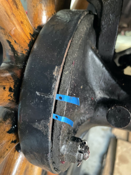

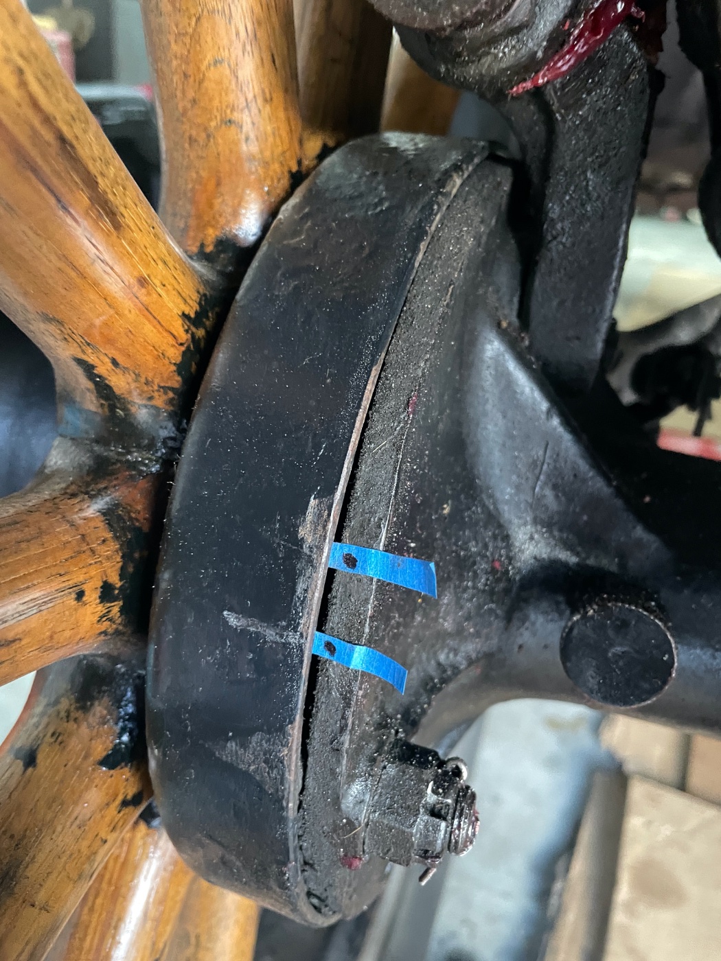

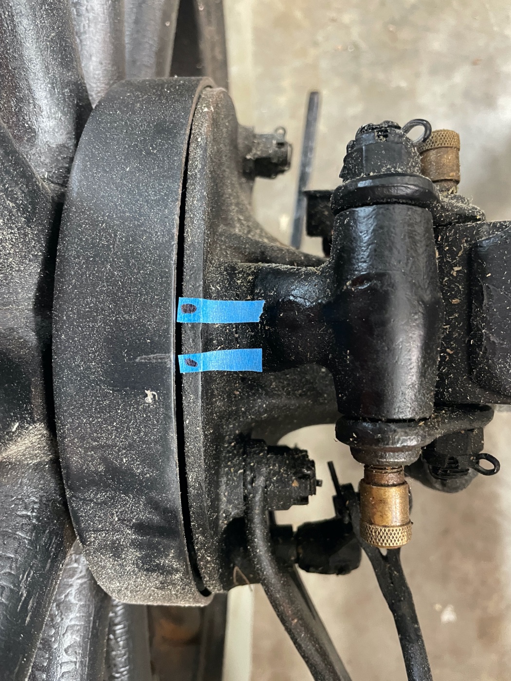

Just measured two rear axles, instead of measuring at wheel circumference, found it best at the brake drum, 8" or so from the axle center.
Did both vehicles the same, locked in high gear, both rear wheels jacked off the ground. Rotated one until the other wheel engaged.
To measure drew a pencil line on the drum, and strips of tape on the backing plate, marked black dot where rotation started and stopped.
Was approx. 20mm or so.
The brass oiler axle is fresh rebuild, not run. The varnished wheel axle rebuilt about 6 years ago or so.
