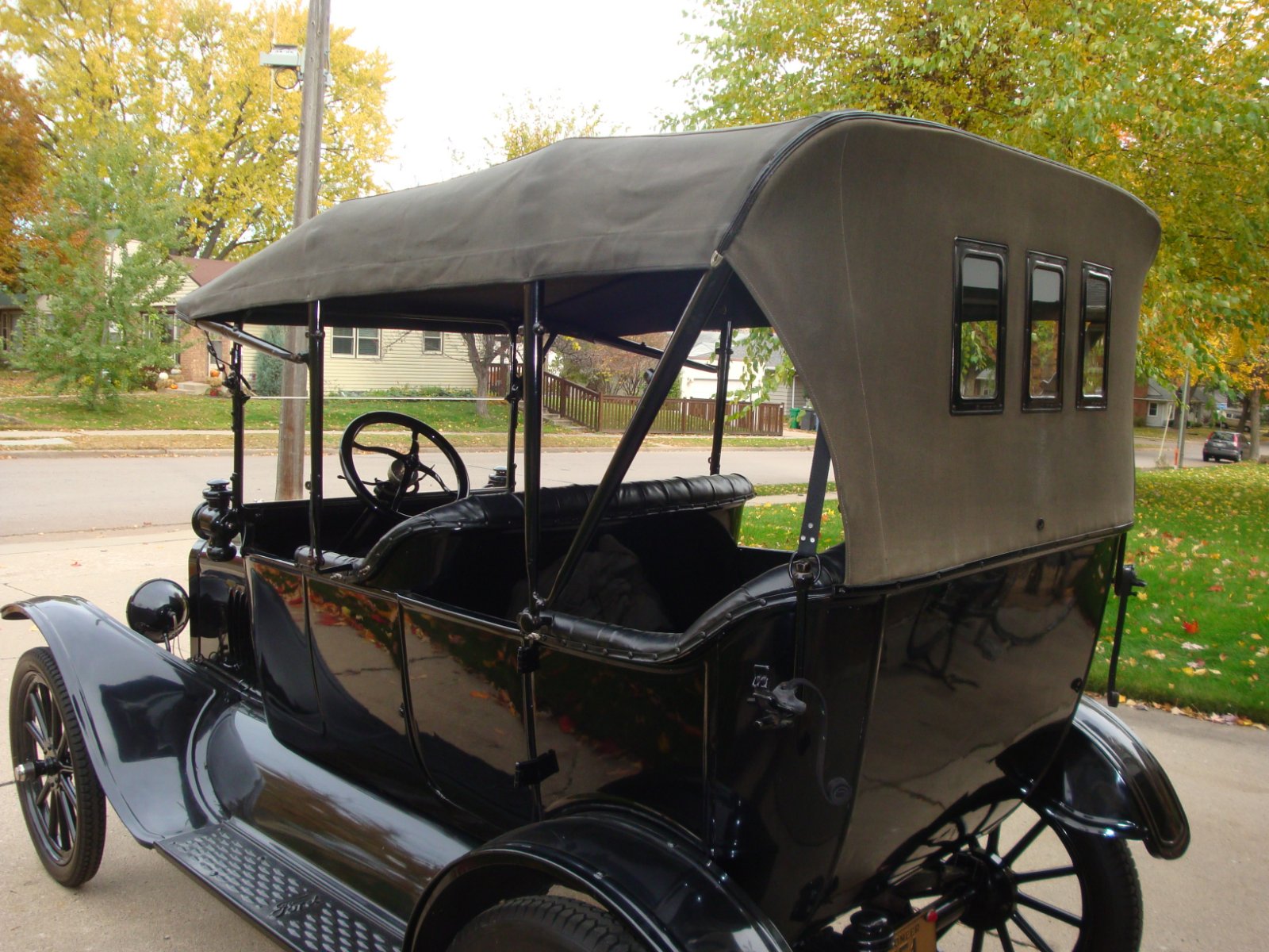

Install accessory metal framed glass rear curtain "lights."
Below is a photo of my dad's 1917 touring with Hastings rear curtain lights (he installed the top in 1951).

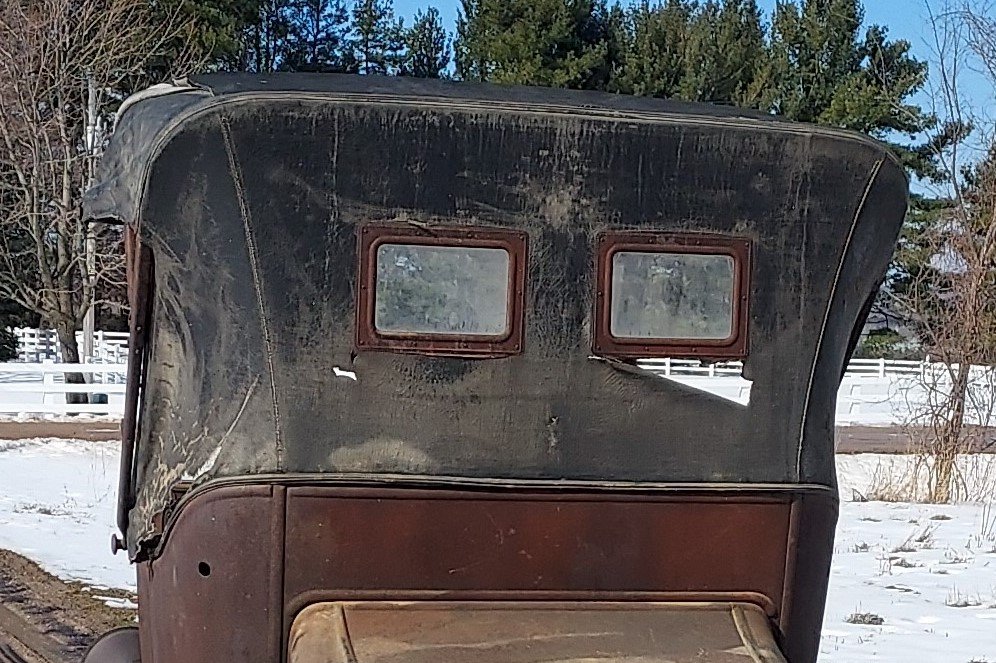

In Australia, many of the T's built by different body builders in each state came with metal framed windows in the back curtain. these have a frame on the outside, then the curtain material, then the glass and these are sandwiched together by an inside frame which screws to the outside frame.
To my knowledge these frames are not reproduced but I have a couple in my swapmeet stocks. The size of the window hole in your curtain may not suit them.

I agree with Erik. This is my original 1924, the rear plastic windows had been replaced sometime in its life with accessory glass windows. In my case the rear window outlasted the top. The metal frames with glass are available NOS at many swap meets, Ebay, etc., and come in different sizes for the various window configuration changes for the model T body changes.

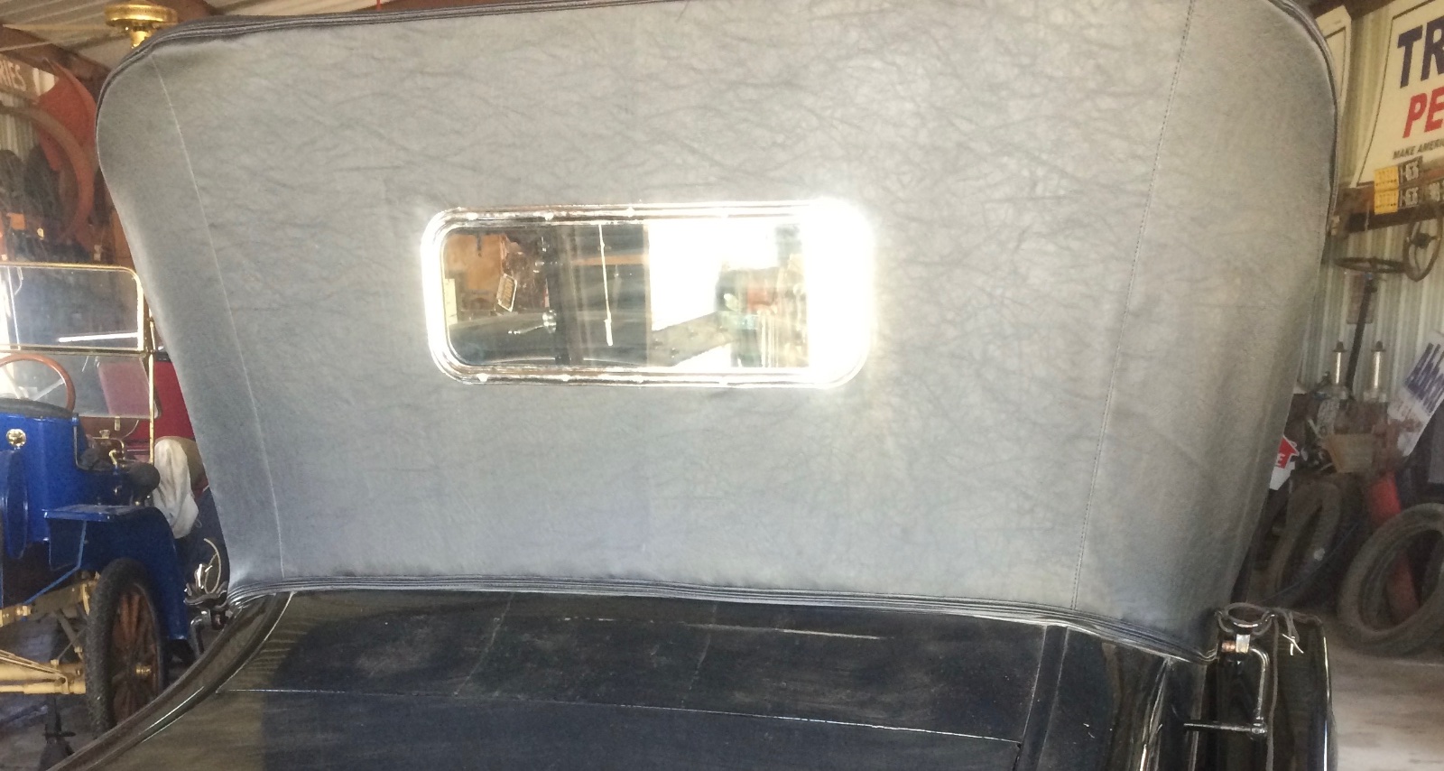

Re: Advice needed for touring rear window.
I don’t like “isinglass” sewn into long grain or copra top material. Indeed, I don’t know the difference in isinglass and clear plastic as offered today. Consequently I found a non Model T rear window metal frame, had it nickel plated and inserted real glass…whatta you think ?
Colonel: what is the rectangular dimensions of your top ‘single window’? I might have another metal frame that’ll fit.
