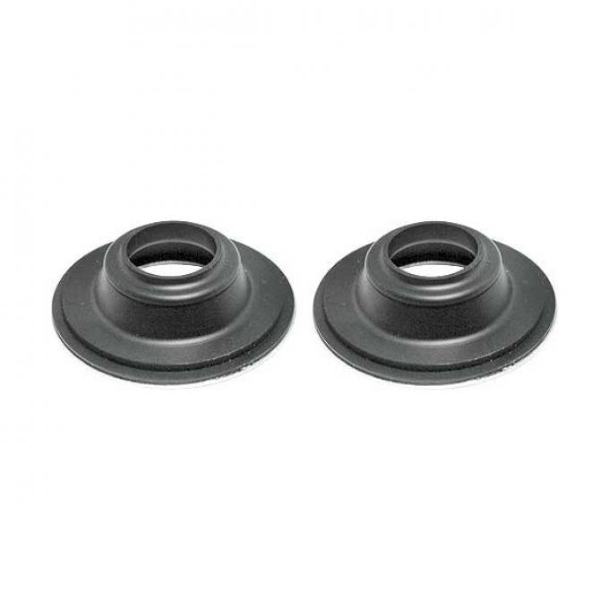

Guys -
We have purchased the inner rear axle neoprene seals and have encountered a problem installing them. I have never installed these before, so I am a neoprene seal virgin. Be gentle with me. :)
There were no instructions or diagram included with the seals indicating the direction the rubber seal is supposed to face. Logic tells me that the conical shape of the seal would face outwards toward the wheel after slipping it over the axle and seating it behind the bearing sleeve. But when we do that, the roller bearing sticks out past the end of the axle almost one inch! Test "dry" assembling the other side by sliding the rubber seal into the bearing held in my hand, the parts mate well and the seal's metal washer fits flush with the bearing - with some pressure. But when the bearing is installed inside the sleeve, the roller bearings are compressed between the sleeve and the axle = now there is no room for the rubber boot to fit inside the bearing. That's why I believe the one bearing is sticking out and cannot be forced deeper into place, even though I removed the one thin washer behind the sleeve and drove the new seal washer inwards until it seated.
So, the question: Does the neoprene seal face outwards when installed as I described above, and if so, why won't the bearing slide all the way in? What did I do wrong THIS time???
Marshall

The raised cup goes inside first, away from the bearing. Turned around, the bearing would chew it up.
As pictured, those seals appear to have a thin washer base that might fit without sleeve trimming.
In the past, those seals had a thicker base & the sleeve had to be trimmed to sit in far enough to properly set the raised locking dimple in the axle housing. The sleeve should fit flush with the housing end.

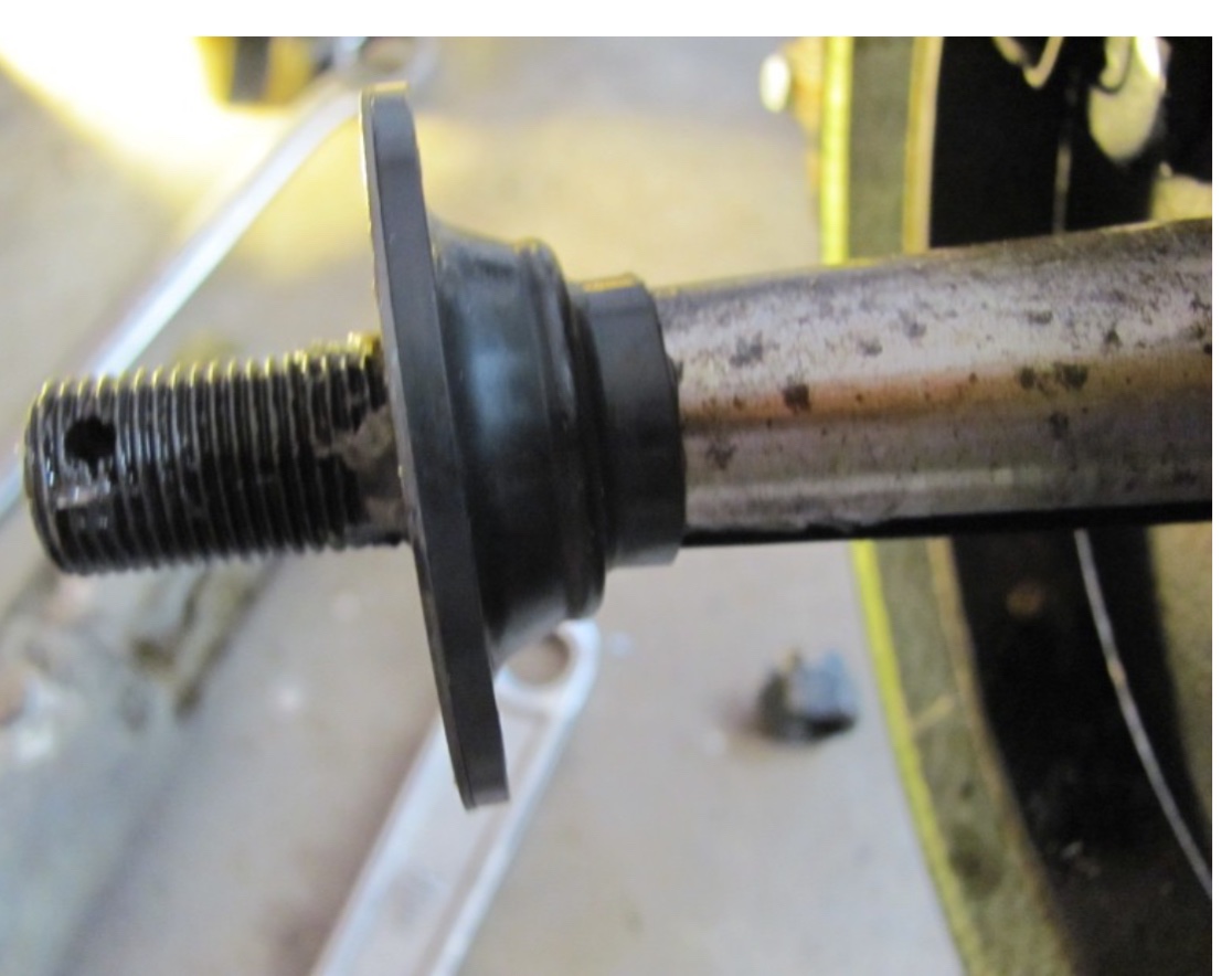

Dan posted this about a decade ago. Note they have improved the seal as picture below.

Post by speedytinc » Fri Jan 12, 2024 8:45 am
JTT3 wrote:
Fri Jan 12, 2024 8:36 am
Dan posted this a few years ago.
The seal pictured on the axle fits way to tight as a seal. You can see that seal has to be streched quite a bit ti fit a 1.062" shaft.
I now cut off that tight band back to that raised radius-ed ridge.
I have yet to find one of those seals still intact functional as installed as pictured. The seal typically grabs & shreds itself or delaminates from the steel backing washer & spins.
