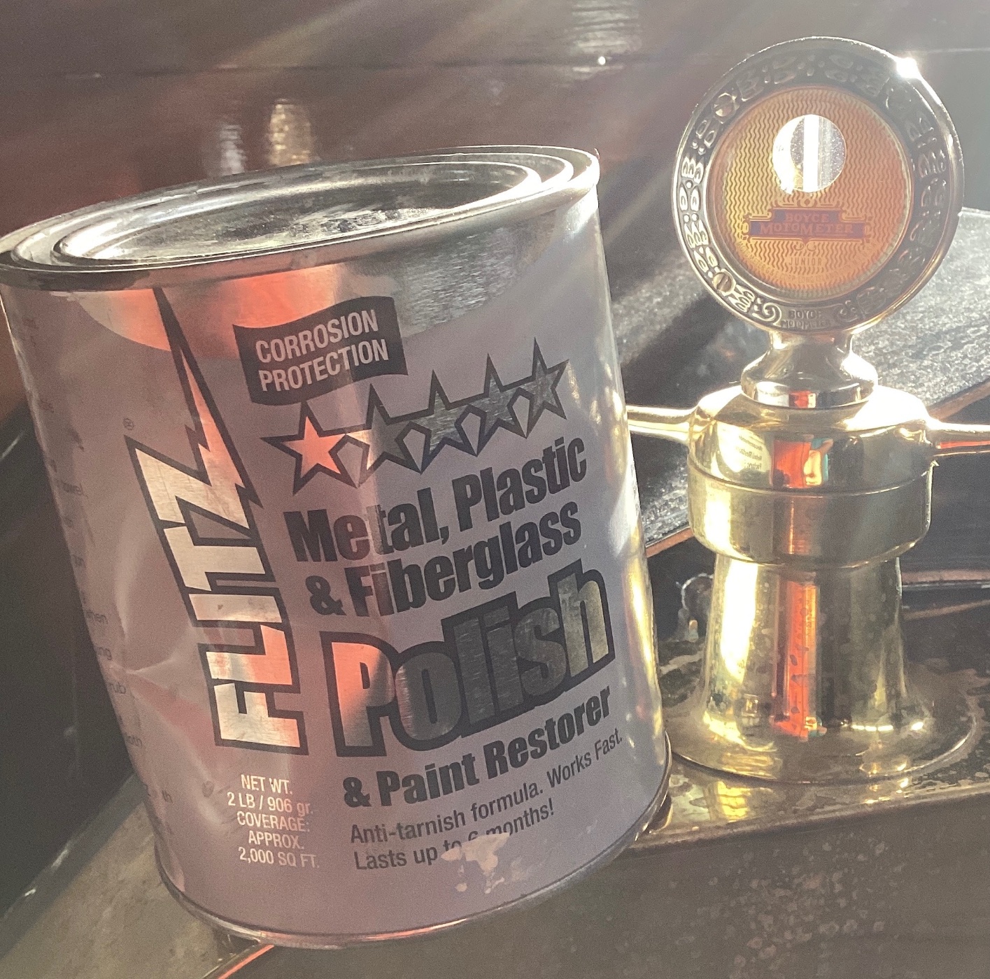

As usual....pictures? I mean like, are they THAT bad!?? No offense...maybe they were painted? When you say "black"...all I know is in all my not so perfect experience with abused brass, and I'd like to think I've seen my fair share, I've never seen any so bad and black that it's that problematic to bring it back up. That said, I'd love to see how that "Flitz" works that Ed sent you the pic of. Try it, you be the guinea pig and let us know!! My last "brass rejuvenation" on my former Torpedo took me two tubs of Blue Magic, a full week at about 6 hours a day and a lot of sore fingers!! But man did that brass look good when I got done. But, it wasn't "black" either!

I have used Flitz polish for close to 20 years but the lamps that I got with the car have never been polished since day one, that is why they were black. I simply don’t have the time or ambition to bring the shine up properly as I would like, that is why if they were done professionally, I could maintain them. I will call the company in San Diego today.

I use the Brite Boy when the brass has a lot of tarnish. I don't like the polishes that require a water rinse.... The Brite Boy works very quick and super easy and is pretty cheap and available at local janitorial supply places. I buy it in a gallon jug and offer samples to guys. I don't think it a great idea to use some of the acid type solutions but understand the frustrations that guys have. The Brite Boy doesn't leave that deep shine we like so a quick polish with any of the good polishes like Mothers Billet, Blue Magic or Flitz is real easy and leaves a protective coating. Covering the brass with the fannel bags really helps prolong the shine
