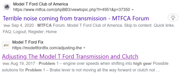

Its not a good idea to pre-diagnose an problem on the forum as to what you think the problem is. It causes others to miss your initial description. Its best to let others offer their initial solution/checking based on your description of events.
So to start over you said "
My T has a VERY loud grinding noise coming from the transmission area only when in 'hi gear' ...
Its frequency is in sync with the engine RPM -
Now, the engine runs fine, and the transmission has new bands, a new brake drum and
the clutch plates were replaced and all adjusted by Pete Rich, who is a terrific master T mechanic in the area...
Noise https://www.mtfca.com/phpBB3/viewtopic. ... 51&p=37350
Adjust https://modeltfordfix.com/adjusting-the ... nd-clutch/

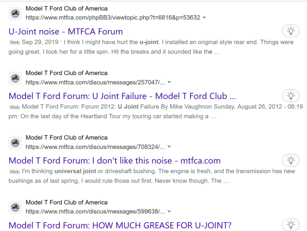

Multiple discussion on possible U-joint noise https://www.bing.com/search?form=MOZLBR ... oise+mtfca
