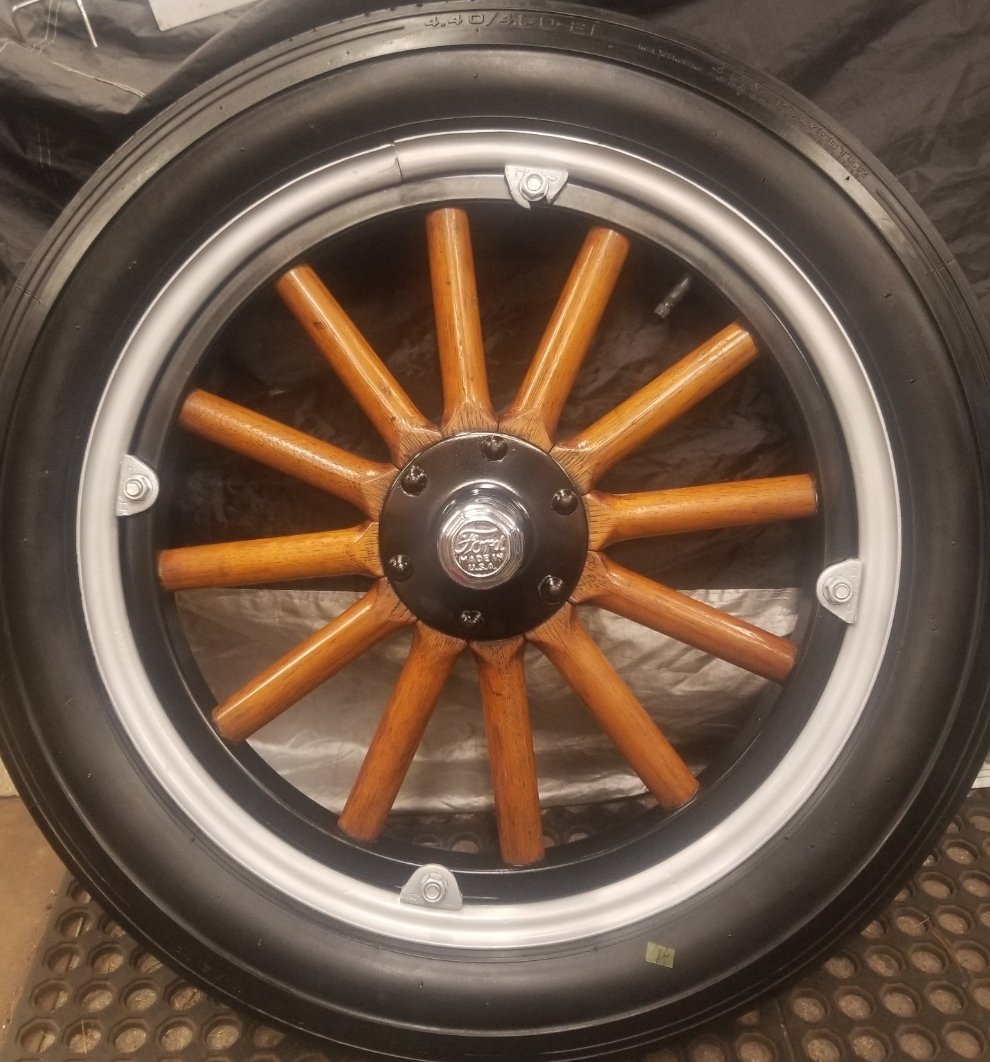

I reassembled tonight and am curious of torque. I'd there a number or do I use the German specifications.
- Posts: 7293
Re: Wheel studs
Vincent, do you mean "schneizentite"? That ought to do it!
